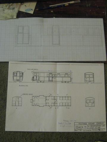

Well I've had a few months since completing my last scratchbuild, and I was thinking it was about time I did something else. However, events rather overtook the planned overhaul of my interpretation (not really a model as I'd made a few changes!) of Ffestiniog van 4. Firstly it was to be a bit of a cosmetic tidy up, and lowering on its bogies to make it look better with Taliesin. Then I thought that I would make it more like the original, and all first class. I was then browising over the dimensions of the original, and realised that the drawing I had used was undersized, meaning I had built the carriage too short. So now, I'm going for an "Accountants rebuild" and pretty much starting again from scratch with a new drawing!!
The new hand drawn plan I will use, with the 6.735mm/foot one purchased for doing this carriage below.

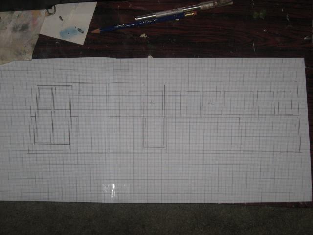

A bit closer up of the drawing, I do one of these for all of my carriages.

Your original maybe correct as this coach was extended by six feet to accomadate a further compartment before conversion to an observation coach.
Post by laalratty » Sun Mar 20, 2011 10:53 pm
number 12 was, but number 11 wasn't. Anyway, it was too short by 1.6 cm, about 3/4 of an inch (ish) which certainly aint 6 feet! Will be to correct length now though, and I'll get the width a bit closer this time too, although a scale width would not match Taliesin well (the width is the only thing far out on the Roundhouse Taliesin, because of the need to make some to 45mm...)
METHSSNIFFER
Post by METHSSNIFFER » Sun Mar 20, 2011 11:01 pm
Your drawing suggests 197mm so at your scale whats that 29ft!
Post by laalratty » Sun Mar 20, 2011 11:07 pm
Prototype length is 24 ft, 6 inches, so the model @ 16mm scale is 39.2 cm. Not sure where you got 197mm from. The note at the bottom of the purchased drawing is to remind me that the drawing is to 6.743mm/foot, not 7mm/foot
METHSSNIFFER
Post by METHSSNIFFER » Sun Mar 20, 2011 11:10 pm
Was checkin your grid squares ! I measured this coach last year from end to end window to window in great detail and came to this conclusion. Never trust a drawing! The inside measurement of the widest window is 32".
