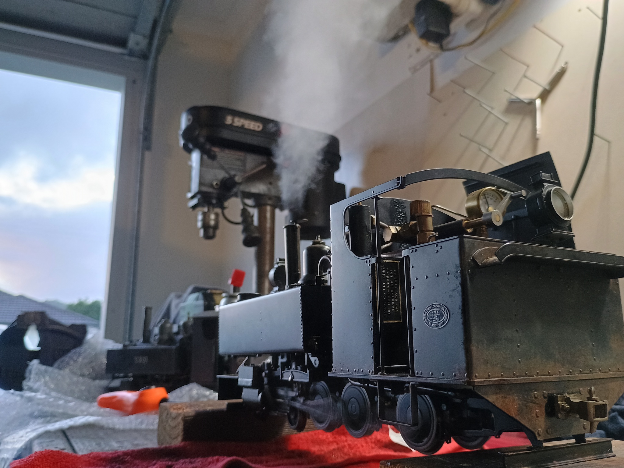

The Accucraft on the other hand - if it works - I thought might make a good birthday present for the nephew - to live in my shed for safekeeping, of course.. :lol:
Unfortunately, a frankly long-overdue falling out with his mother, put paid to that idea. Think "Harry & Megan"...
Well in any case, after years of watching others run their Accucraft locos almost trouble-free, I seem to have finally got a good one!
Burner is quiet, stable and lights easily. Engine is well run-in and ticks over smoothly on steam.
And weathered, no less. Not a half-bad job either. :thumbup:

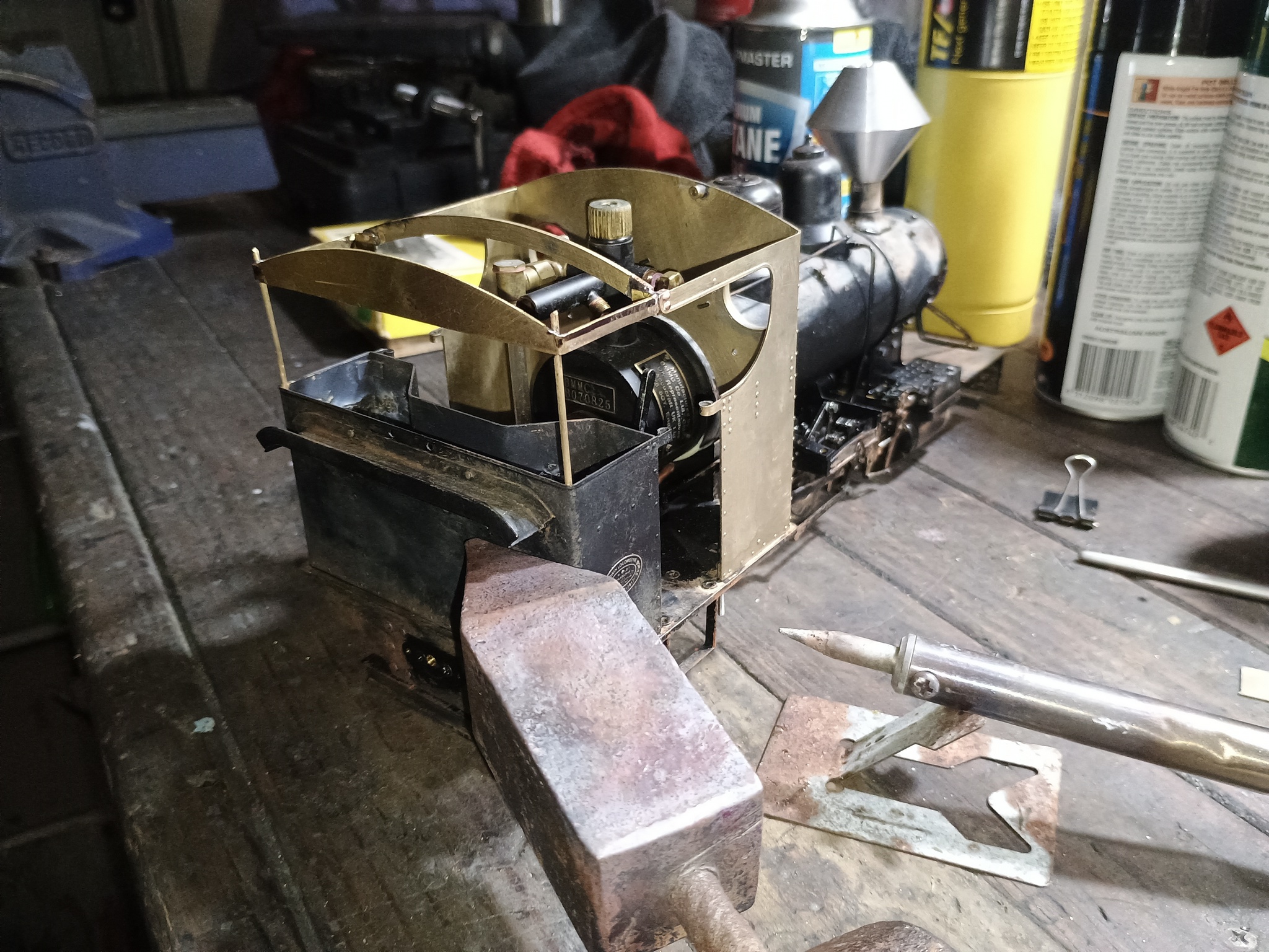

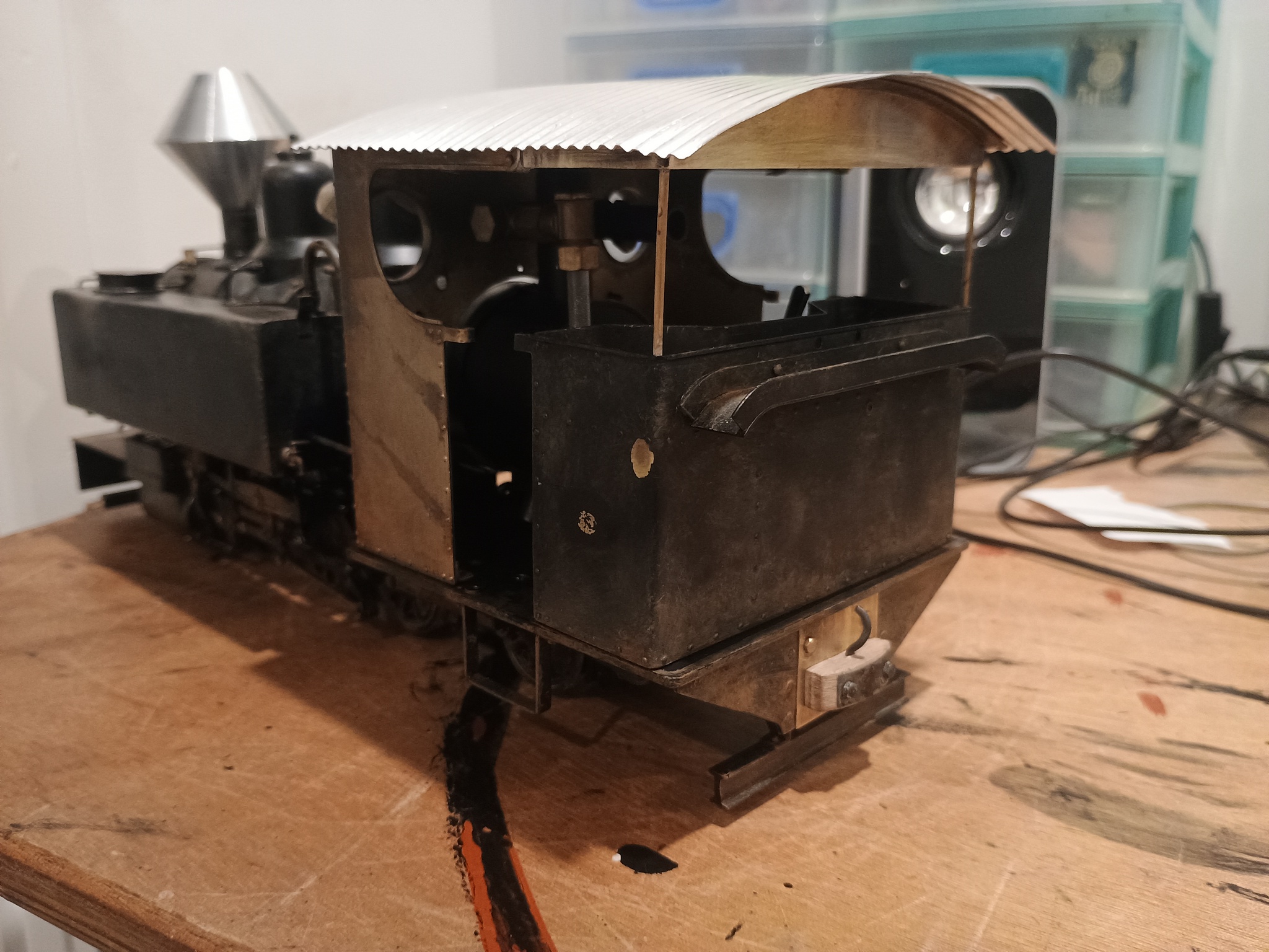

Besides improvised workshop facilities, I don't feel like spending a year on this one - would also like to bring it to the WinterSun Steamup in a month's time, so I'd best get going.
I've fancied doing a loco without headlights for a while, so now's the time for that.
Besides a quick turnaround, I'm trying not to disturb a well-running loco. The burner in particular I didn't want to touch, but it had to come out to get the cab off. The paint was impervious to thinners and paint strippper. Only acetone (barely) worked.
My old-school copper soldering iron was very helpful in extending the cab.
Need to keep an eye out for some smaller ones at a sensible price..

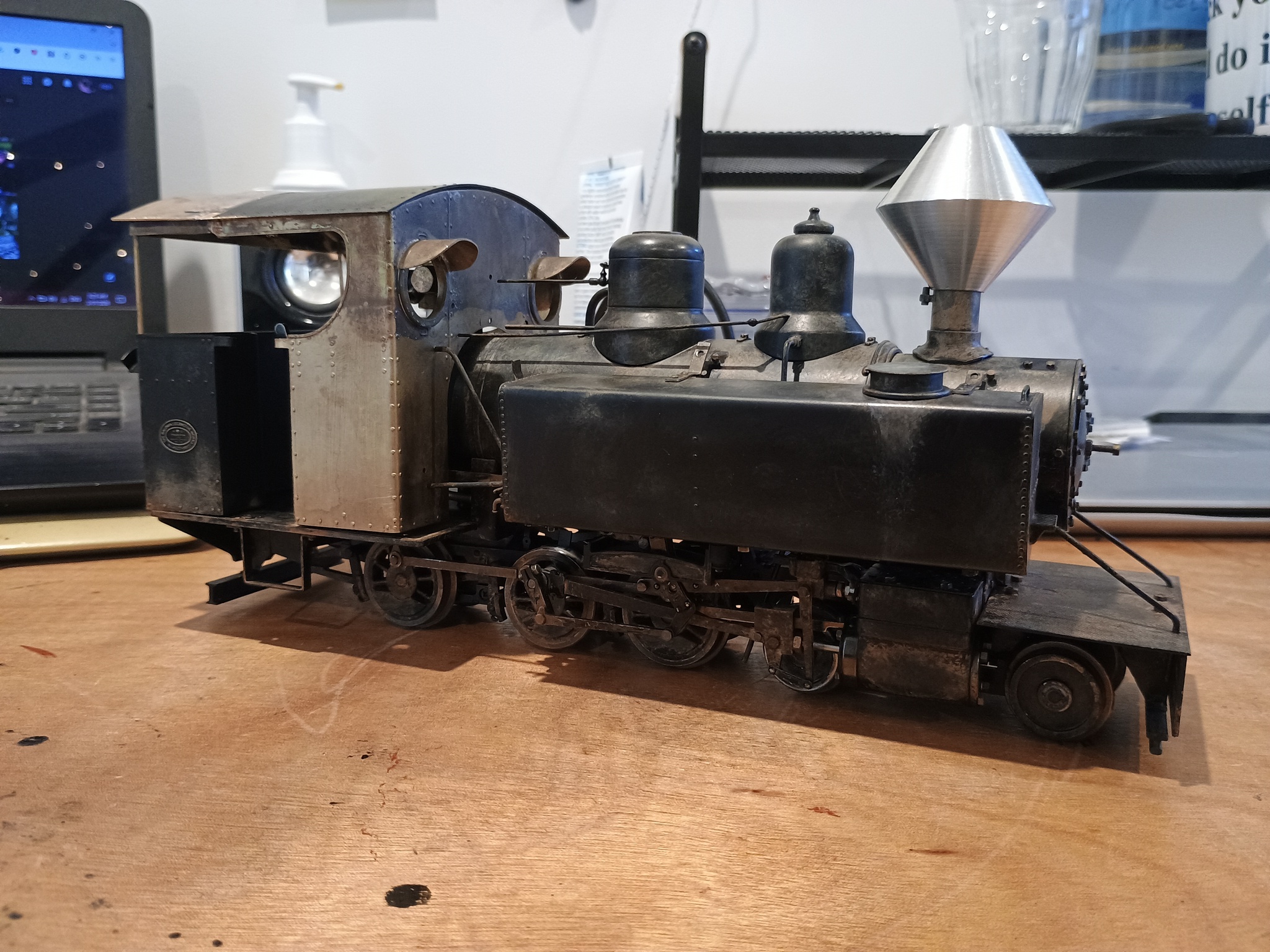

01/07/26

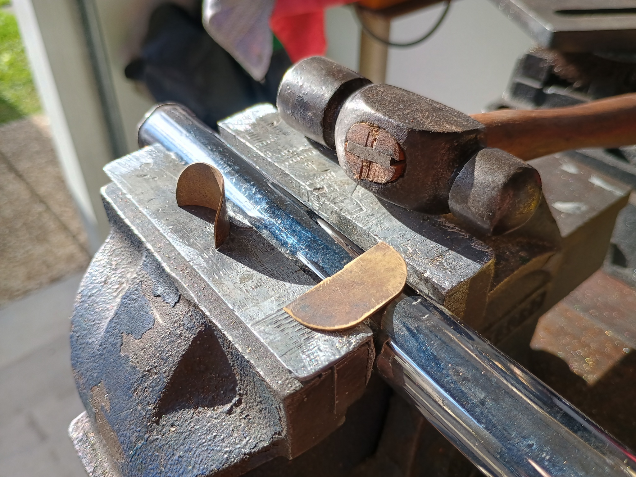

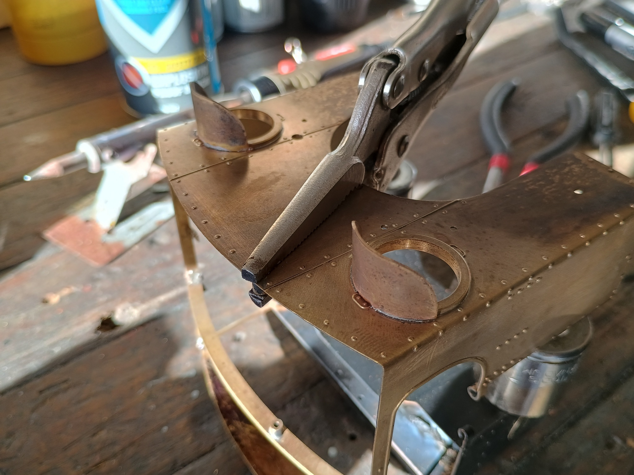

I always fancied those weird visors on the Baldwins and other European locos - Hell, I nearly bought a stainless pair for my Model A headlights.
I digress once again..

01/07/26
Very happy with how the visors came out. I can also confirm they make excellent decorative covers for your big toe nails - not that I'd post that photo here, not for free anyway.. :lol:
Extending the roof itself came out a bit sloppy - I really need to invest in a pile of toolmakers clamps, and a benchtop sheet roller.
Planning a batch of Hudswell 0-6-0s down the line, as it were, I'll need them for that project anyway..
The roof will be clad in corrugated iron, and iron-faced dumb buffers fitted. Paint green and weather the hell out of it, requisite chuffer and TTD valve spindles on order.. :thumbup:

How did you learn how to use a non-electric soldering iron? I watched my father use the things, but I never picked up the knack. Now that Accucraft seem to be using stainless for bodywork, we'll probably need to use a TIG welder to kitbash the things......
A tip for the future. Septone Paint Stripper is industrial strength for panel beating work and it easily removes the paint that Roundhouse and Accucraft use on their steam locos. Evil stuff to use though, as it contains dichloromethane and phenol. I bought my tin from the local SuperCheap Auto branch.
You can never have too many clamps for model building. I had to make a batch of small toolmakers clamps in brass, as I could only find steel ones. The small brass 6" sash clamps available through the model trade are also useful.

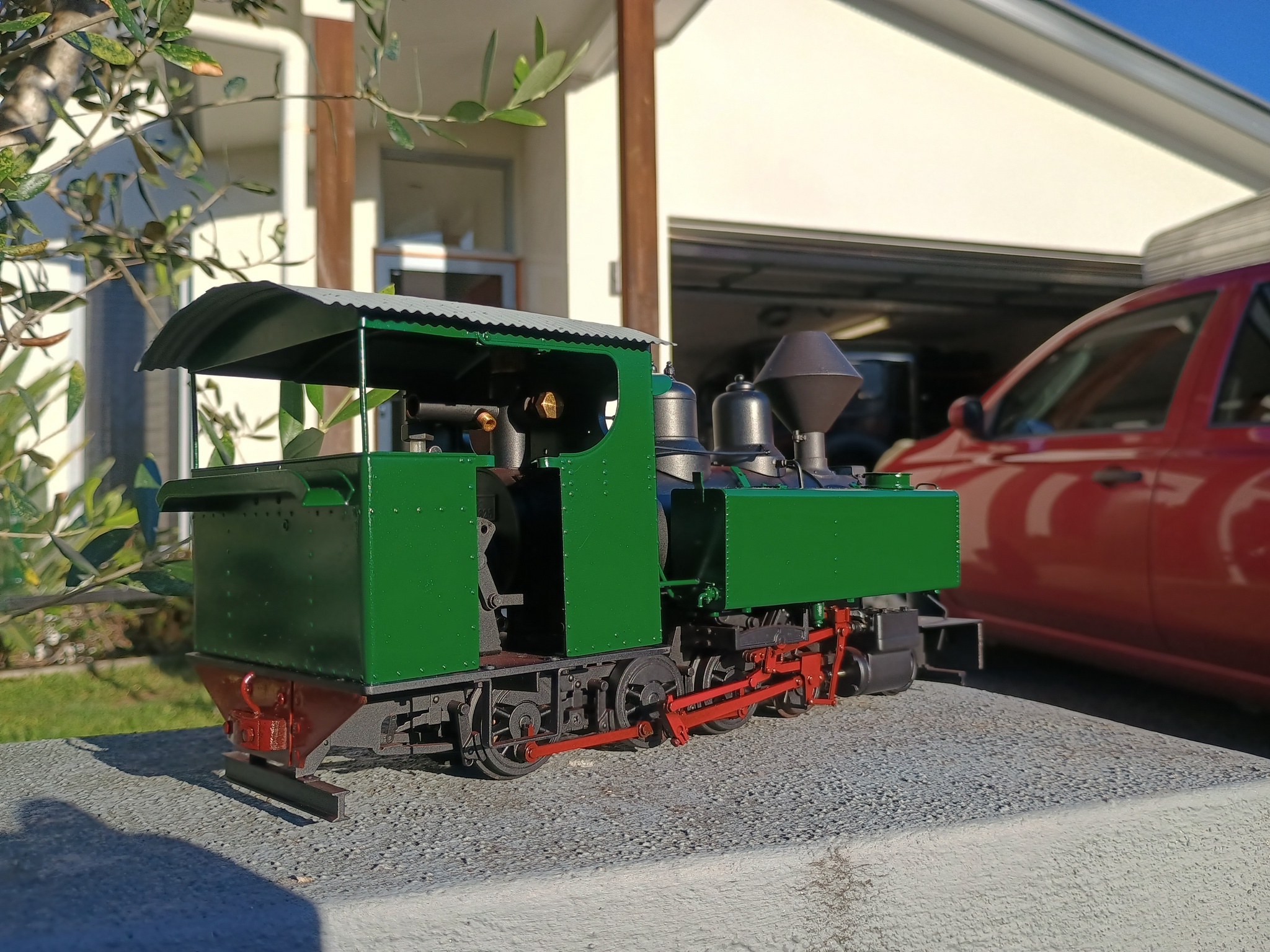

A corrugated roof was made in the usual manner and glued over the original roof.
The holes to attach the kerosene headlight to its bracket, were soldered up and the bracket refitted.
Dumb buffers were made from oak and faced with extra buffer plates from the cane truck project.
Like the prototype, these were bolted to the headstocks.

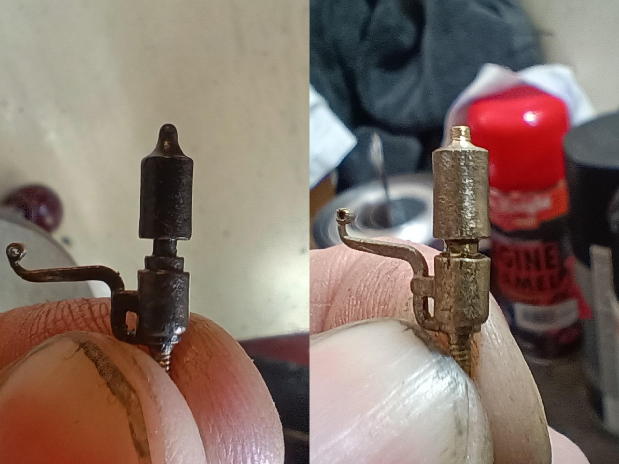

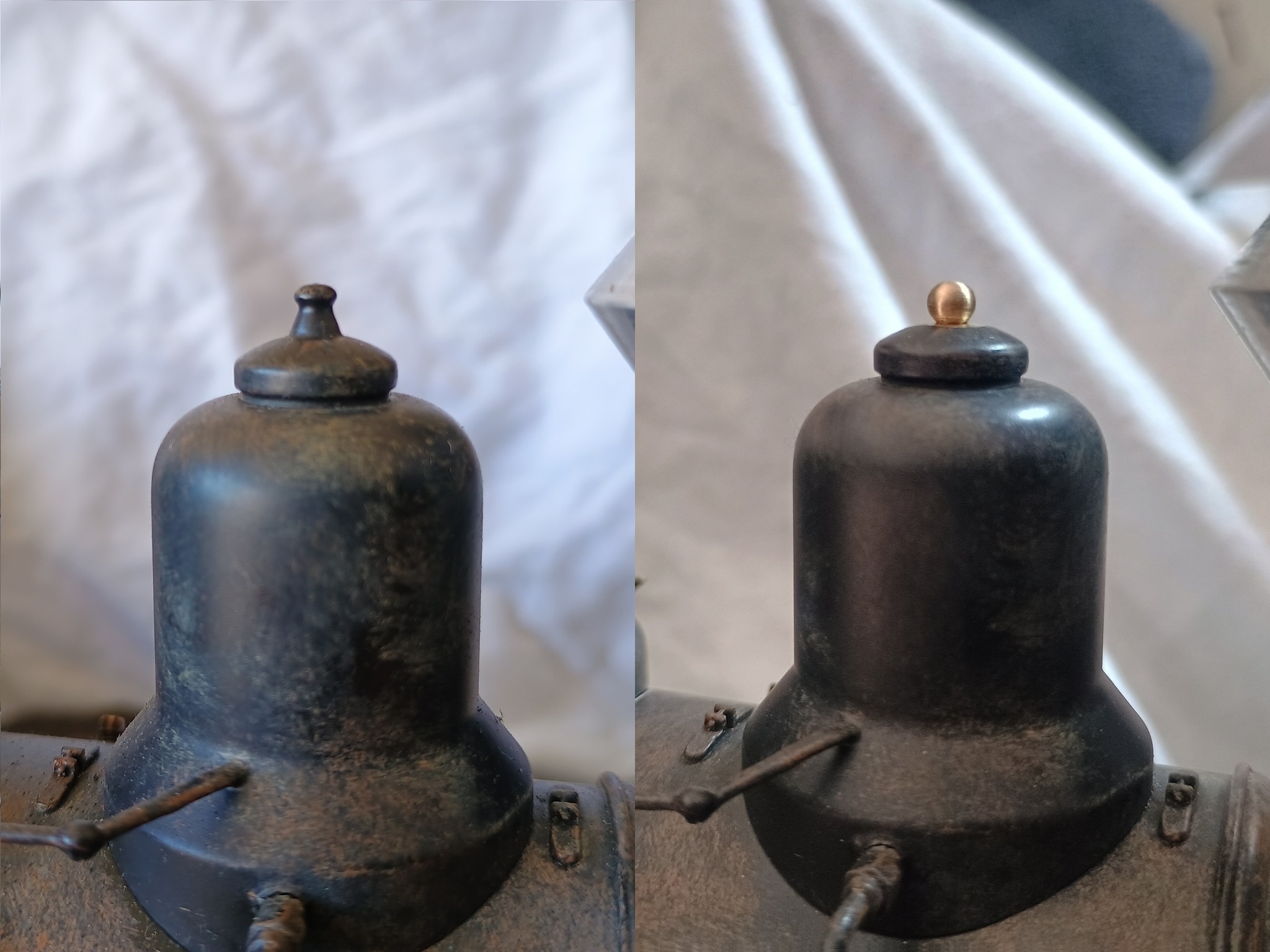

While I realise the chesspiece-looking knub atop the sand dome would've been a manufacturing compromise at Accucraft, it couldn't be left like that..
Filed off, drilled out, and a more Baldwin-like replacement turned, as I did my old Ruby many years ago.
The whistle didn't look like any I've seen, and was similarly reworked.
And yes, I did have to anneal and bend the arm back after the parting tool knocked it. :lol:

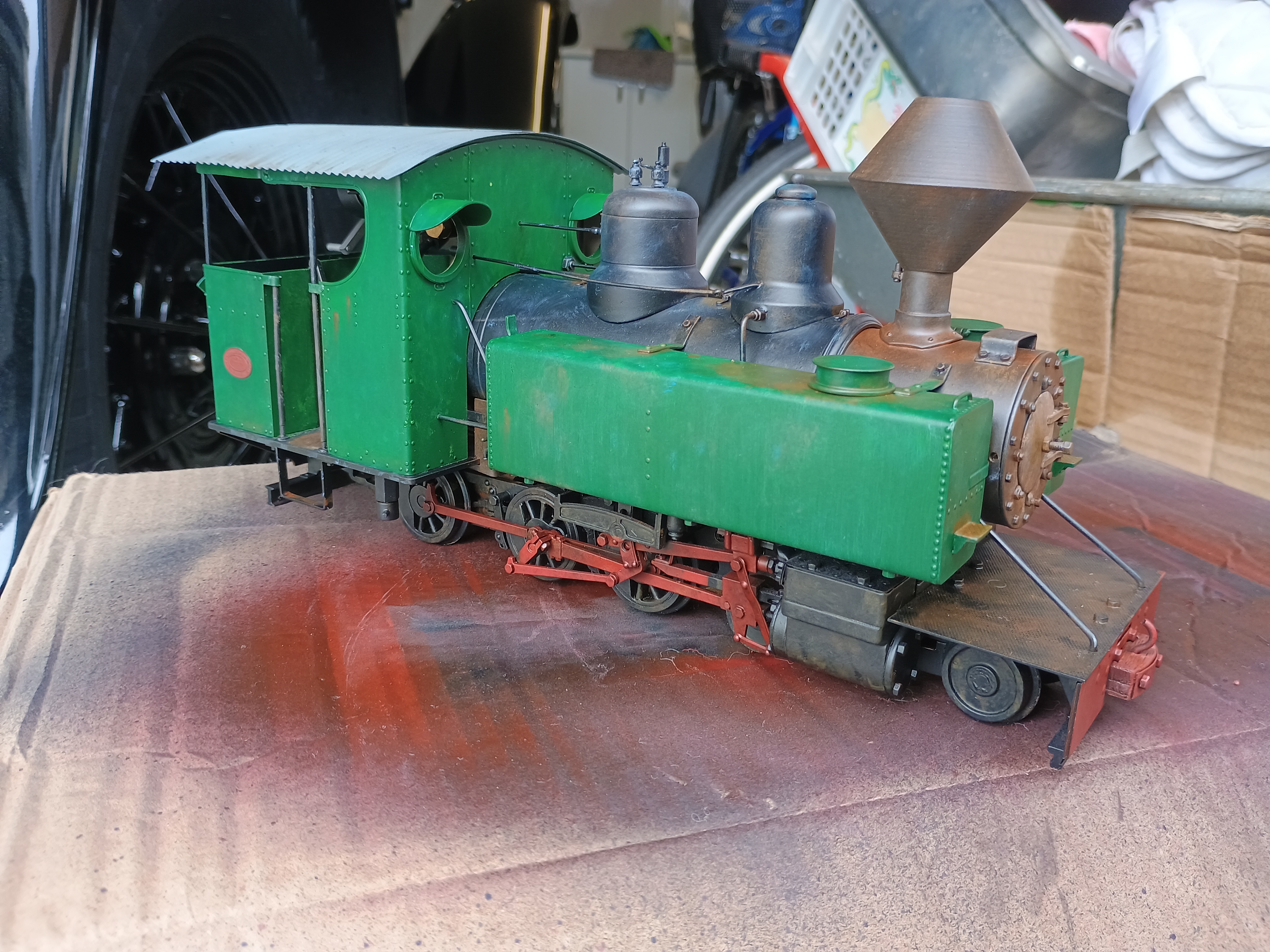

14/07/26

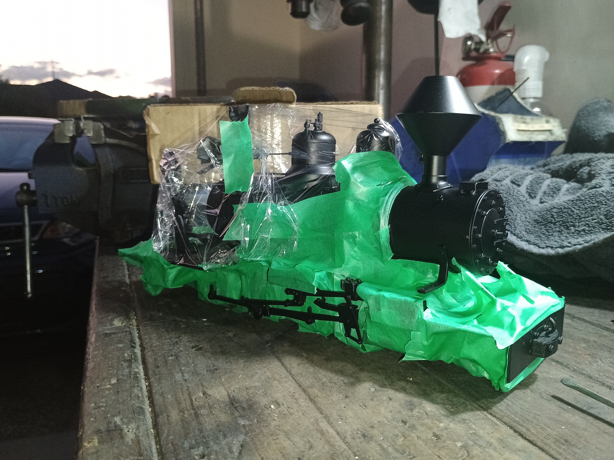

With just over a fortnight to finish the loco, I'd best get it painted and (heavily) weathered.
A quick re-wipe with meths, and the loco was gone over in black etch primer. I didn't know if it would react with the existing paint, but have had good luck with this stuff and was willing to gamble.
Low gloss black engine enamel over the top.
Normally I'd strip the lacquer from the cab fittings and chemically blacken them. This time I just black etch-primed them.
After drying overnight, the loco was somewhat tediously masked off to paint the motion, headstocks and smokebox in-situ. This worked pretty well, and for a loco to be heavily weathered, I'd do it again in future.
15/07/26
Looks a bit garish, but the green and red I use will mellow out as they cure.
The red didn't cover real well, but again, heavy grime will play nice with that.
The roof was hit with a "cold galvanising" zinc-rich paint as a basecoat.
I've since painted the interior in the usual cream (though maybe I should've made it WD black for a change) and am working on reassembling the loco.

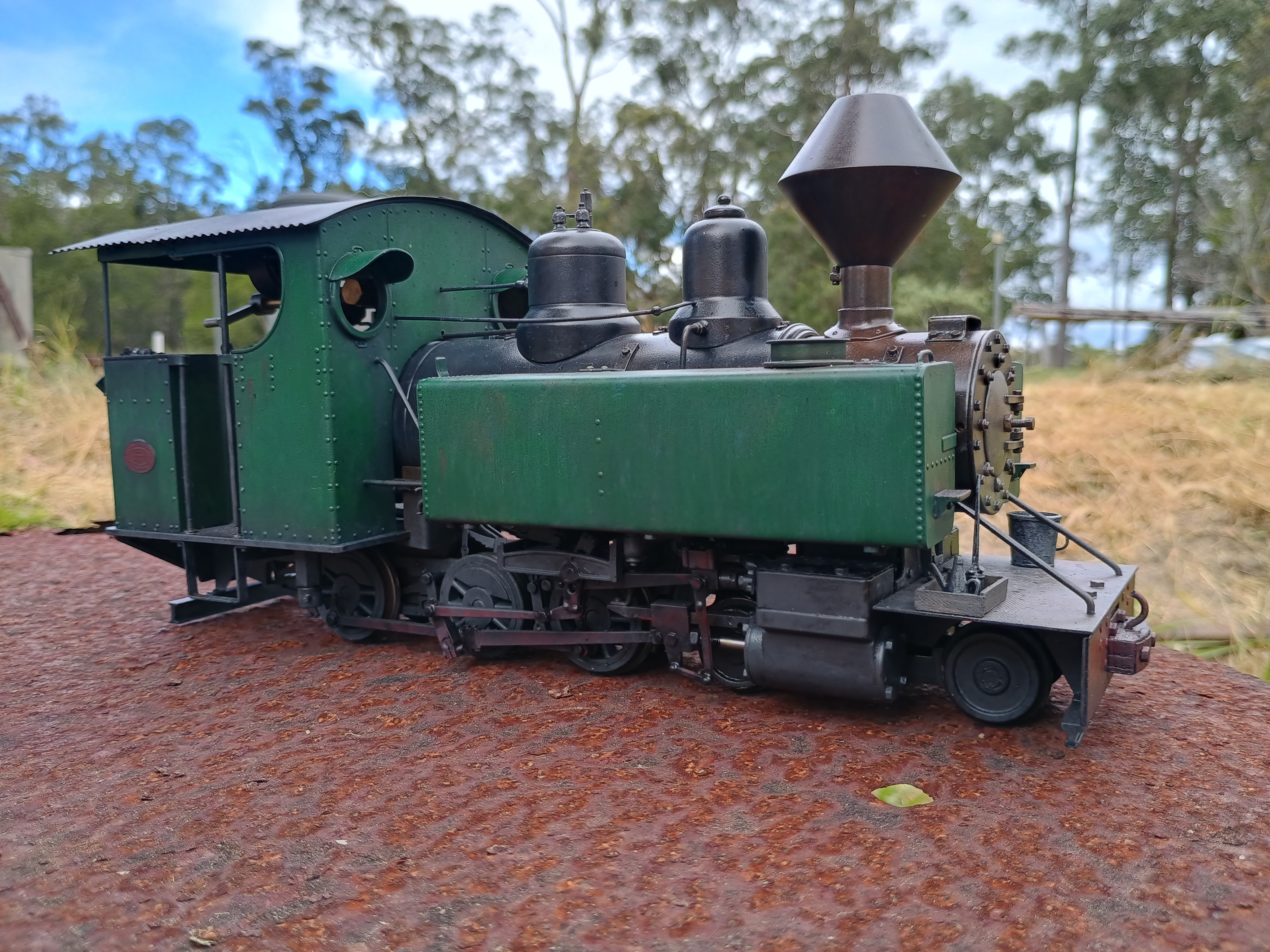

19/07/26

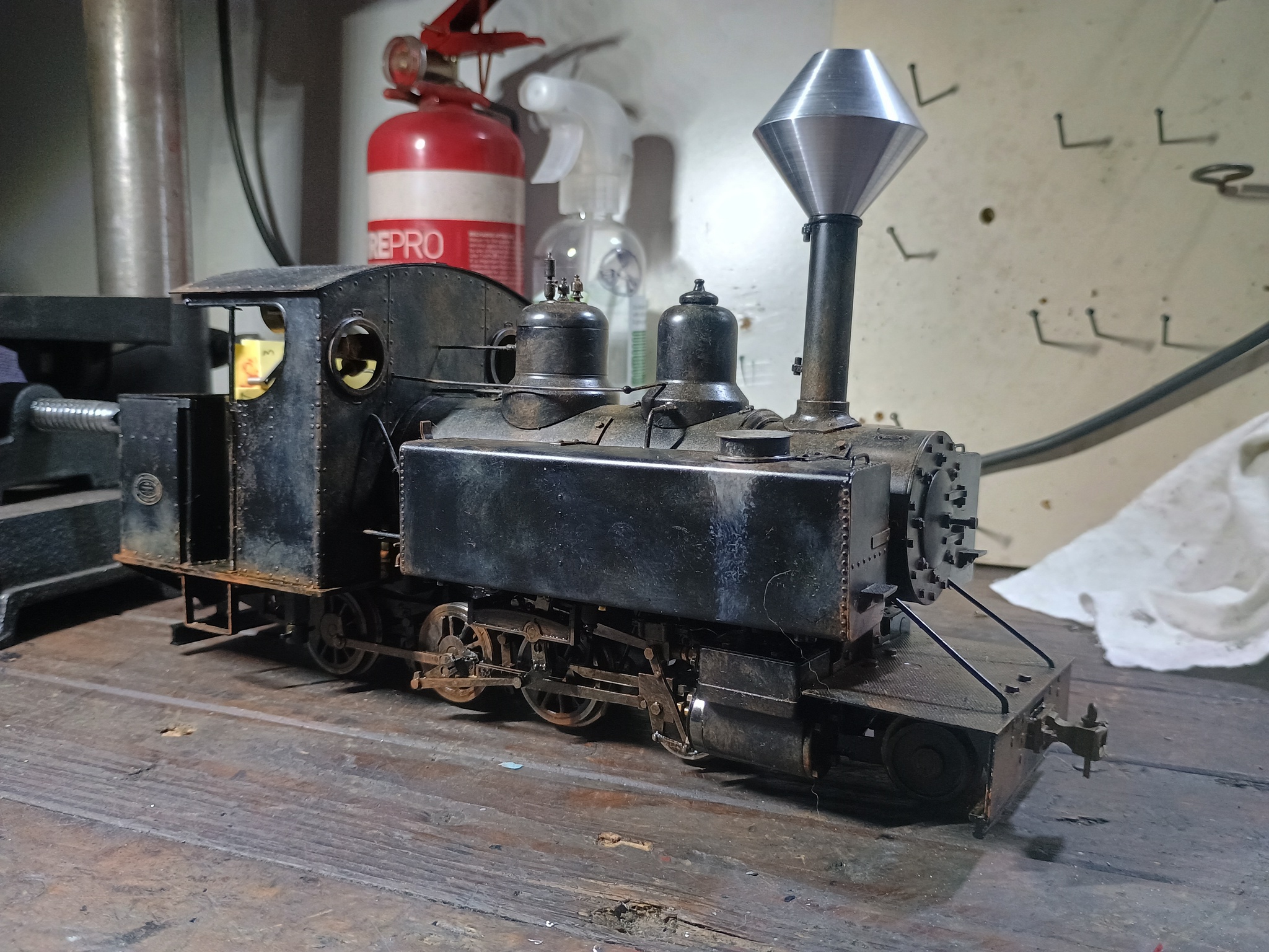

With the airbrushes put away somewhere, I'm taking the opportunity to experiment more with oil paints. And I think I'm onto a winner here.
All weathering so far has been oil paints using the "blending dot" technique. No enamels, washes, or powders in this photo.
I'm going for that rural Australian 1930s-40s depression/wartime austerity feel with this one.
Using white and lighter shades of the existing paintwork, really gives the impression of faded and worn paint.
Brown was also applied to remind us the loco isn't just faded and sooty, it's dirty.

An aerosol clearcoat later, and the usual enamel "grime wash" was applied and wiped off over everything. Plenty more dry brushing, some more oils, enamel washes here and there, and just a little bit of powder, topped off by a light dusting of soot over top with el-cheapo (if you can call $9 a can cheap) flat black spray paint.
A removable coal load was made, with a magnet hidden in the coal for easy removal. A small tray was made up from veneer from the wood scrap tin, and fitted to the front footplate, along with some whitemetal tools. Another clearcoat later, the loco was ready for testing, the day before WinterSun.
01/08/26

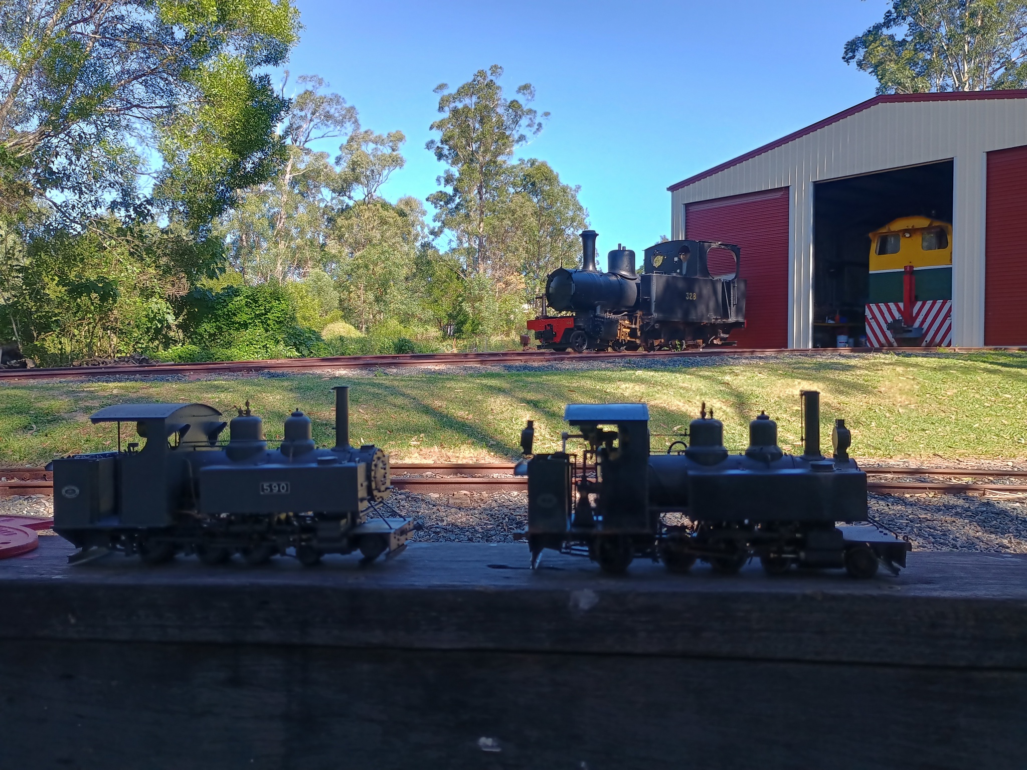

After clearing a blocked gas jet on the day, the loco ran rather well. Though I still need to fit the TTD gas spindle and extend it and the regulator, so they can be reached from outside the cab. Chuffer still in the mail..
First firing turned the clearcoat glossy, as happened to the Fowler "Victoria". The solution then was a quick recoat, and I'll do just that..

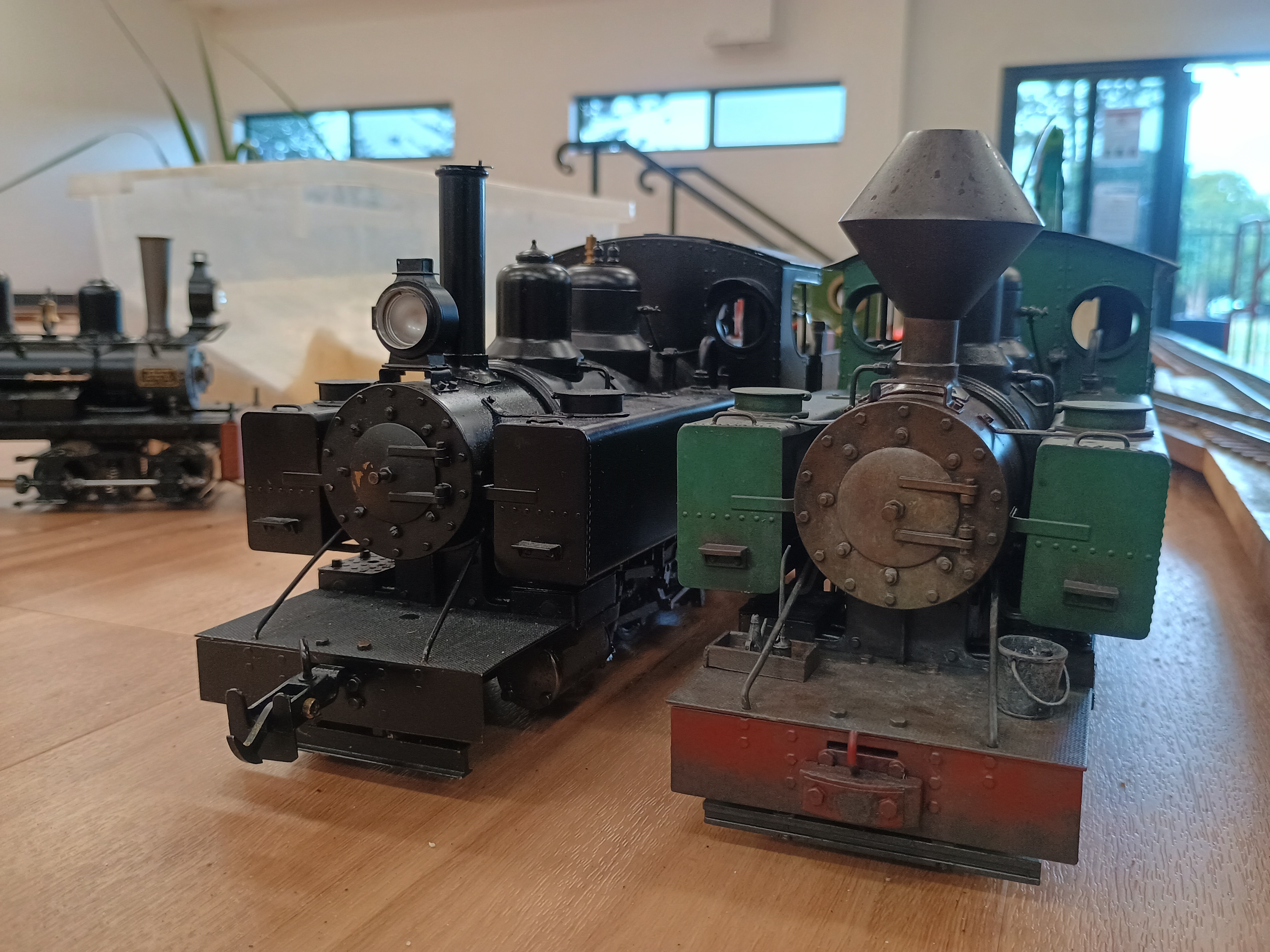

The loco was very well received - I almost don't recognise it.
The former combat veteran looked right at home with it's Fowler shedmate.

A trip to the former sawmill runner photography bench at the Woodford Railway always makes for nice ex-works photos.
Well, this has been my fastest rebuild, by far. It's been nice not to worry about headlights and wiring.
