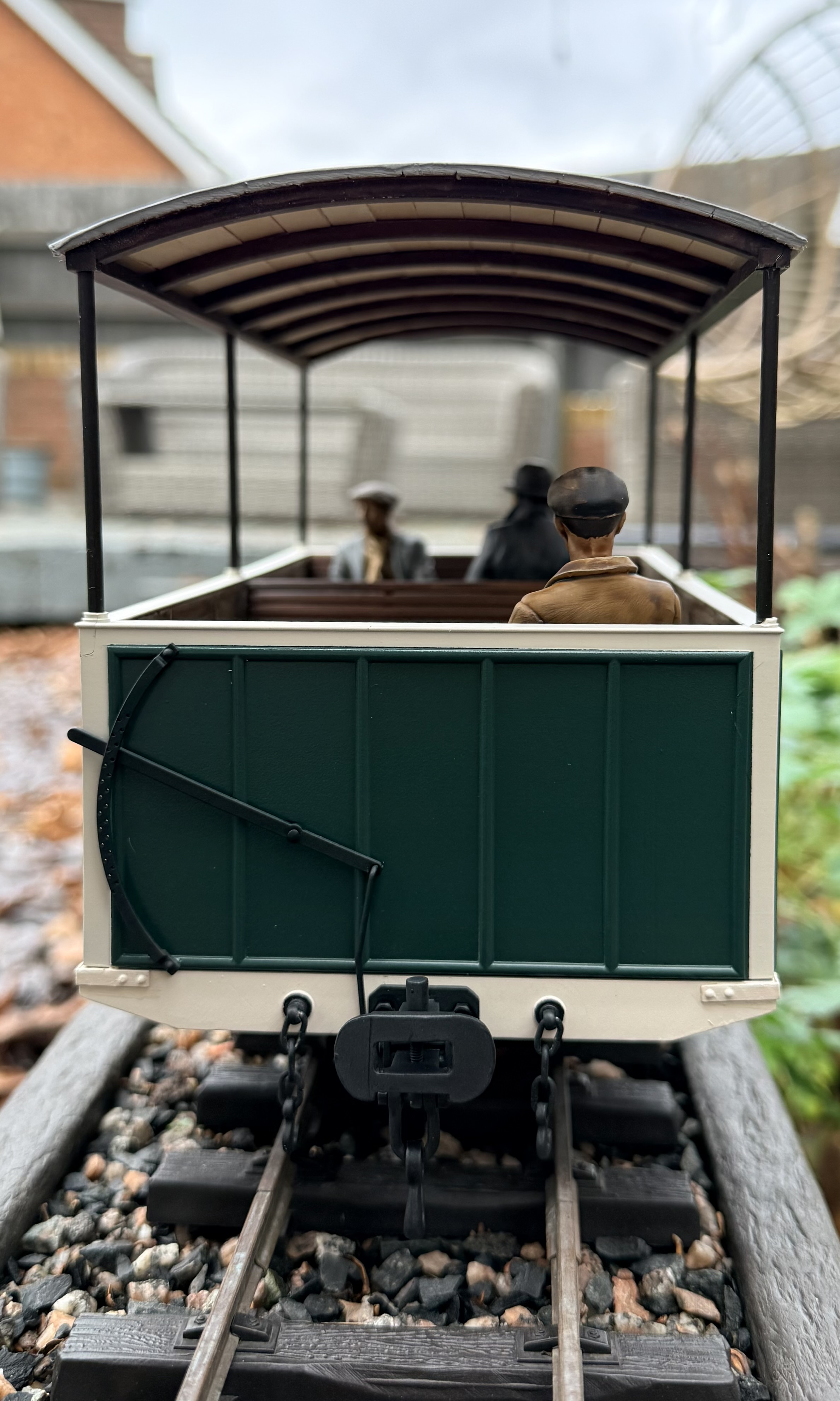

I’ve been building some Glyn Valley Tramway stock in 1/16th scale (3/4” or 19mm to the foot), so I’ve started this thread to share some photos. At this scale, the GVT gauge of 2’ 4 1/2” equates to 45mm so matches my SM45 track work.
First up, here’s a few photos of the open 3rd carriage which I have modelled in early condition with fully open ends and the original GVT livery.
The model is a mix of 3D resin printed bodywork, milled aluminium angle axle guards/bearing holders, Slaters 7/8ths scale wheels, Trenarren Models couplings (too small at 16mm scale but look ok). The roof is made from milled Perspex rails with 3D printed ribs, basswood planking is sheeted with thin balsa sheet and covered in masking tape to simulate canvas. The details are mostly 3D printed parts.
The distinctive Greek fret lining was painted using washi tape masks cut on a Cricut machine. The GVT monogram was a special order from Endon Valley Custom Decals.

Absolutely superb! The colour and lining are excellent and all detailing looks faultless (as far as I am aware).
I'm a little unsure about your choice of passengers... the man in black looks to be up to no good at all.

Peter Butler wrote: Mon Dec 15, 2025 2:29 pm Absolutely superb! The colour and lining are excellent and all detailing looks faultless (as far as I am aware).
Thanks Peter. That’s Llyn ‘light fingers’ Ffransis. He can do you a good deal on a nice barely used gold pocket watch, as long as you pay cash and ask no questions 😉

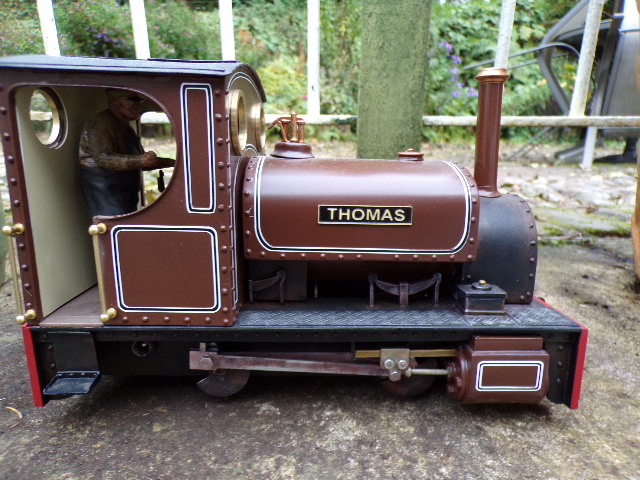

LNR wrote: Mon Dec 15, 2025 11:08 pm I've been wondering about a Cricut machine to finally get around to providing some data panels on my rolling stock.
I got the basic Cricut m/c ( Cricut Joy) ages ago, just to try to do my own lining and lettering. It does have some limitations but I'm not sure if the more expensive versions would be any better. The problem I have is that if it has to do multiple cuts, i.e inside and outside of a rectangular shape, the registration goes a bit to pot. Trying to cut the vinyl lining for my F & B loco, the narrowest I could get it to do is 0.4mm because it tries to do some at 0 mm and some at 0.5mm, because the registration slips. To do 2 or more colours requires matching cuts and fiddling to get them together accurately, see the drop shadow on "No.2".
This is the said loco, so far, and I'm debating whether to put lining on the wheels ( The various components are not yet fixed together):

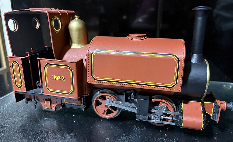

The lining on this locomotive was done with a vinyl cutter, although I have no idea which one...
Kay is so proficient she measured and cut all of them while I waited, drank coffee and talked models with her husband.

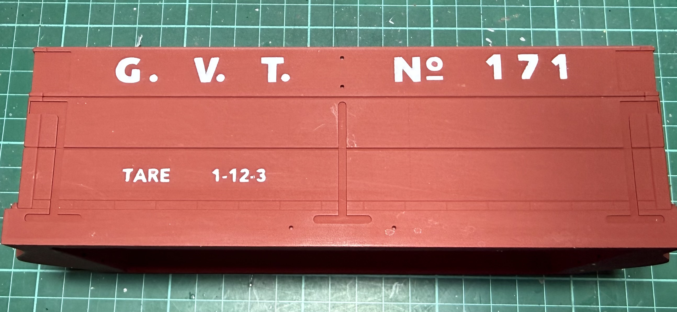

A few workbench photos of my latest output. The 4 ton granite wagon carried the majority of the GVT’s freight tonnage. Made ubiquitous in 16mm garden railways due to the excellent Binnie injection moulded plastic kit, my version is mostly all resin and makes into quite a chunky wagon in 1/16th scale.
In the early period I am modelling, the prototypes were painted red oxide with iron work picked out in black. Painting wagon strapping in a different colour when in place on the model is one job I really dislike, so I chose to make all the strapping and bolts separately so the body could be sprayed red and the ironwork painted black before being attached. This approach also allowed painting of the interior to replicate bare and weathered wood, and some weathering of the body, before the ironwork was attached. Recesses in the body ensured the ironwork could be accurately positioned. Lettering is sprayed white using masks cut on the Cricut machine.
Wheels are Slater’s 7/8ths scale running in 3mm oilite bearings mounted in milled aluminium angle bearing holders, all hidden behind 3D printed axleboxes. Couplings are still to be mounted, I’ll use prototypical hook and shackle (castings from Model Earth).
I want to make a rake of these wagons, photos suggest most GVT mixed trains ran with at least 5 granite wagons and sometimes many more.

I agree with the above comments. What a superb wagon. The seperate iron work is a very good idea for painting. I would also like to print one of these, and I think the 1/16th scale could fit in well with some of my 7/8ths stock.

That's a lovely model Dursley. Great lettering and internal finish too.
An interesting approach to print out strapping separately. It's worked very well for your scale, but might be less applicable to smaller scales.

Thanks for the comments gents. John, I’ll make the files for the granite wagon available on the 3D printing section of the forum shortly. I do want to make a few tweaks to some components before sharing as I needed to do a bit of fettling of some of the internal ironwork on this build due to designing some of the tolerances too tight.
