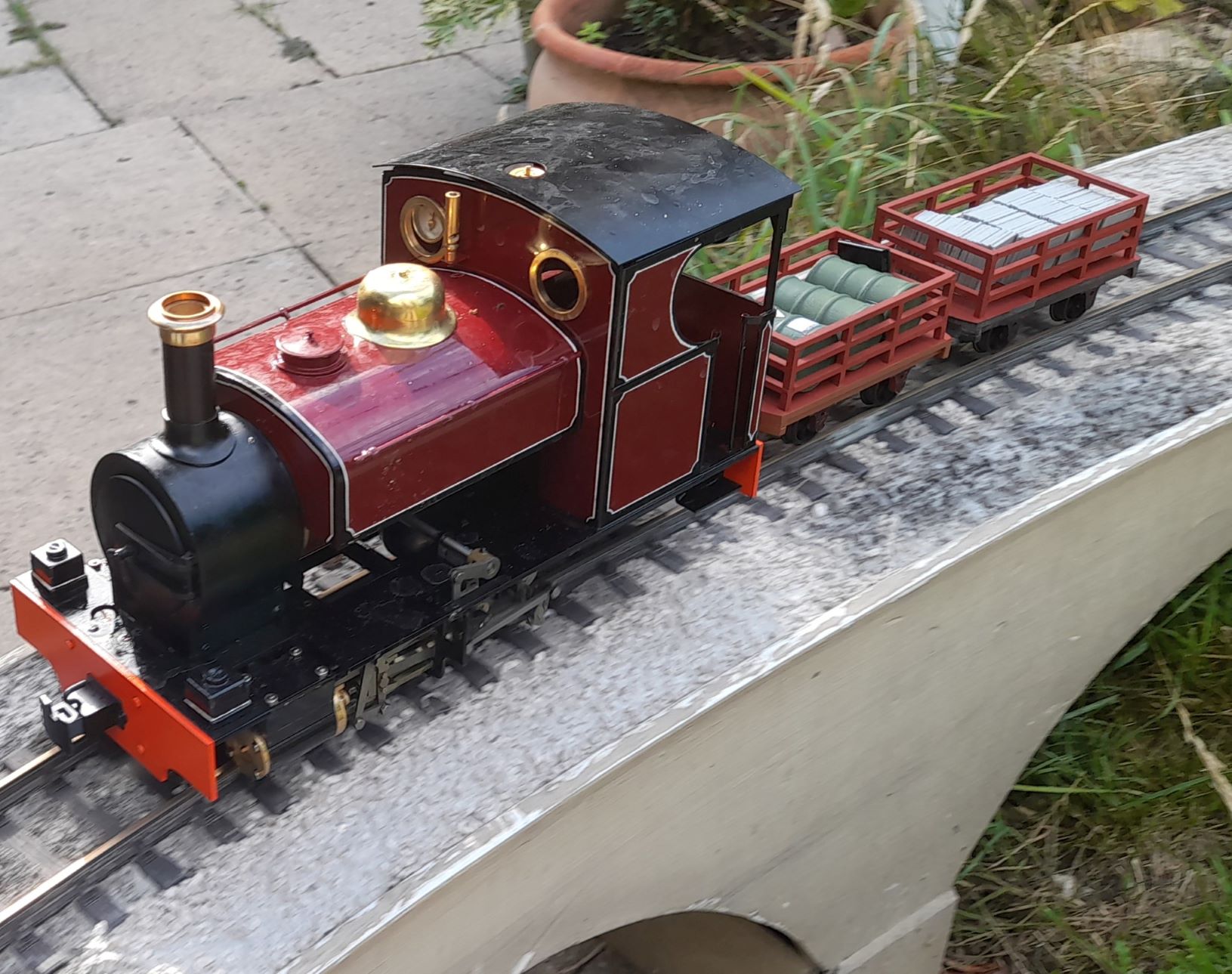

my take on what would look good.
Accuraft sabrina and two P.s. Model 45mm slate wagons

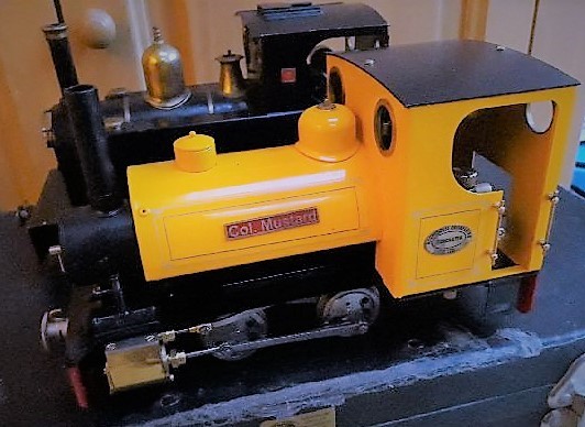

bertie and mayflower.jpeg (63.7 KiB) Viewed 131591 times
hopefully photo shows a roundhouse bertie with a size comparison with a merlin mayflower, these are smaller locos which would suit a smaller layout.
The bertie is pushed in the direction of travel and can keep up with a time tabled run.

I love the colonel mustard !!
If I understand well you are not able to radio control it ? So once it is running you let it roll ?

by jimmytrains_01
it is a push and go, the regulator gives the speed, you need to grab the roof for a controlled stop! doesn't quite happen when you run round a friend's swimming pool. It didn't stop at some trailing points and went swimming in another friends pond. can be controlled enough to run on a raised track until the track is switched to a side your not on.

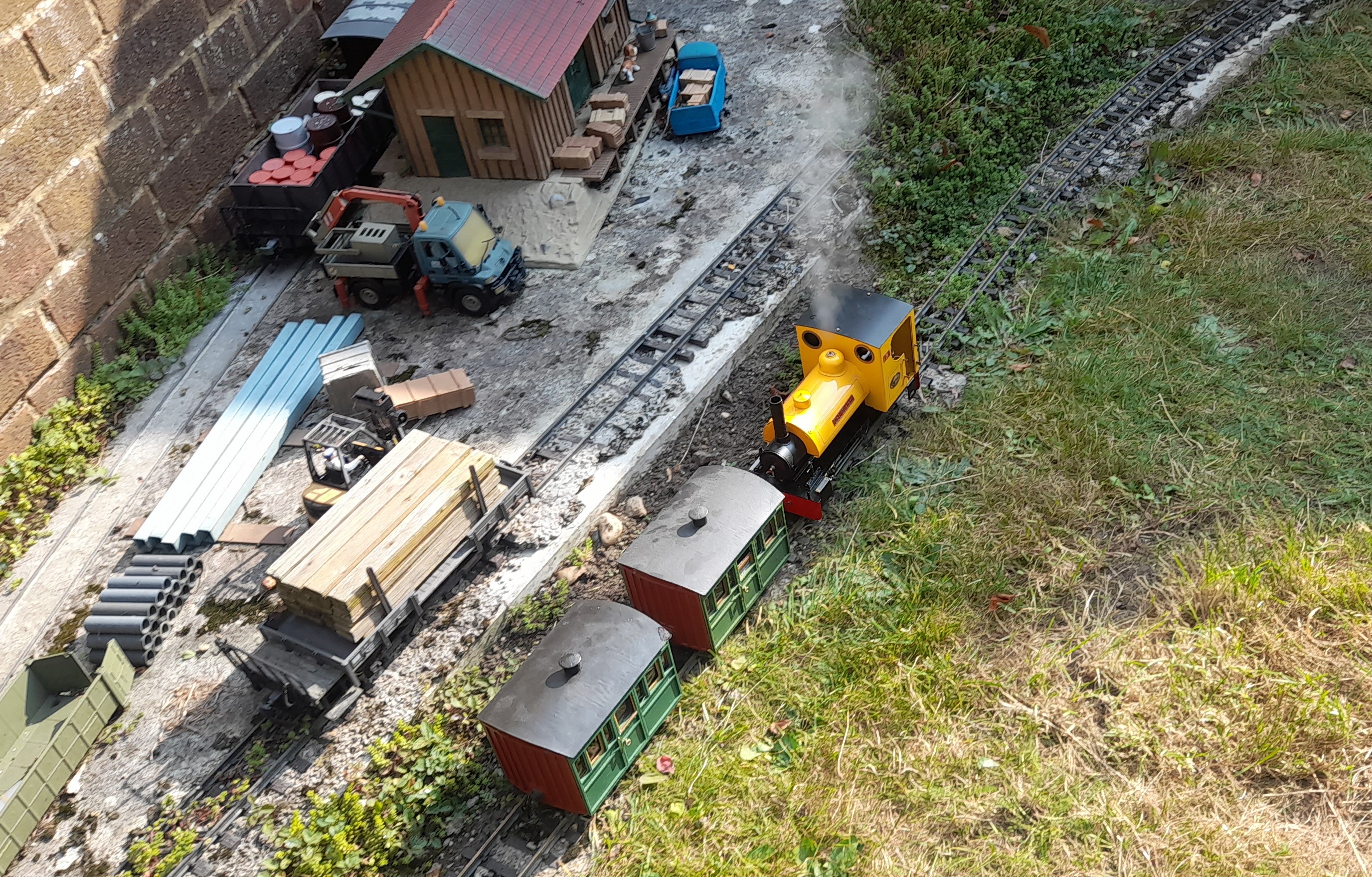

by jimmytrains_01

Roundhouse does sell an RC kit for suitable for Bertie (Basic Series RC Kit) but it only controls the regulator (stop, go and speed). Changing direction would still require manual intervention (by pushing the loco in the other direction).
