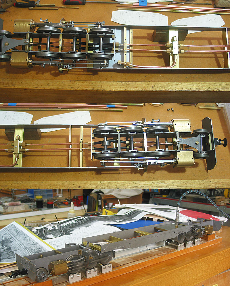

The photos below are composite photos of the specialist parts specific to a Garratt model, the flexible steam lines and the large boiler.
The first photo shows the engine units and the boiler cradle at the point where the steam lines and flexible joints had been installed and were about to be tested on air. The third part of the pic shows the chassis/cradle running on air.
The flexible joints are the black rubber sections of steam piping over the engine unit pivots. The rubber is a grade that is resistant to steam, oil and hot water. The connector design came from a friend who uses them for water lines in G1 tender engines which can be under boiler pressure when pumping water. I made up a couple of connections for testing and found they stay tight up to about 300 psi. At pressures higher than that, water is forced between the brass and rubber parts, acting as a lubricant and the rubber is pushed out of the fitting. No rupture, the rubber just quietly pushes out of the fitting and starts to leak water. At 40 psi boiler pressure, that is a 7:1 safety factor, which is more than adequate for purpose.
The copper and rubber tubing used for the steam lines is sized so that there is minimal restriction at each tee junction and the internal cross section is adequate for free flow of the steam. The extra care taken over the sizing seems to have worked as planned, as each engine unit starts at about the same pressure and runs at about the same speed.

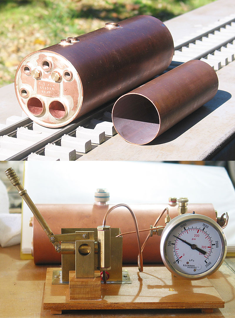

The second composite photo shows the boiler after assembly and during testing.
As mentioned a Garratt has two of just about everything. With two engine units, that means four cylinders, so if you want something like prototype performance, you'll need twice the heating area in the boiler and twice the output from whatever source of heat is boiling the water.
This model is gas fired, so the boiler has been designed with two flues and two burners. Scale size for this model boiler works out to 75mm OD by 220mm length. That's a big boiler.........
The first part of the pic shows the boiler after being silver soldered and cleaned up for hydraulic testing. The two burner flues are apparent, as are the nuts for the longitudinal stays, as well as the bushes for various fittings. For comparison, the piece of copper tube beside it is the shell for a boiler the size of a standard Roundhouse Type 1 boiler, as fitted to a Lady Anne, etc.
The second part of the pic shows the boiler getting a pressure test, holding test pressure, with no leaks, or distortion.
The boiler has been steamed on the bench, but the engine units have not run under steam and won't until the model is painted. The gas tank is 80ml capacity and has been fitted in the rear bunker/water tank. With two Roundhouse burners to feed, this should give at least a 30 minute run. We will see......

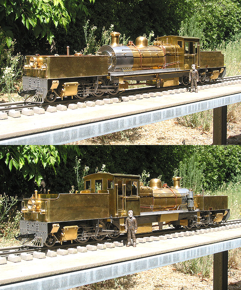

The last photo shows both sides of the assembled model sitting in the afternoon sun yesterday, with the old engineer giving some idea of scale. The loco is about 800 mm over the couple pull lines and with a boiler full of water ready for a run it weighs a bit over 8kg.
I still have to build a carry case for the loco that will take the weight and also work up enough enthusiasm to paint it when the weather cools off. Don't hold your breath.

A stunning looking locomotive in the brass - what plans for a colour scheme?

Lonsdaler wrote: Sat Feb 01, 2025 11:04 am A stunning looking locomotive in the brass - what plans for a colour scheme?
The model is already developing a patina, the price of living in a coastal rust belt........
The prototype APC Garratts were painted plain black in service and that's the current plan. This pic shows APC no. 2 towards the end of it's working life.

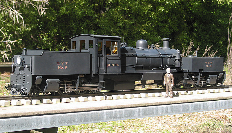

Time has passed and spring has sprung hereabouts. We've had a strange winter and the backyard jungle has mounted a take over....
The sun was out yesterday and something big and black was perched on part of the track that is still visible. It wasn't a Currawong.
I've finally finished painting the Garratt and it has run on air, but needs a bit more work before I start running it in on the bench.
There are times when I wonder why I paint models. This time around the manufacturer of my favourite etch primer has shut up shop and my last stock of black etch primer wasn't quite enough to finish this model. On top of that the nearest hobby shop folded its tent and disappeared into the sunset around the same time and I only just had enough Revell enamels left to do the topcoat. To top it all off the tin of Revell varnish was past its best by date. Painting is a pain in the what he said, just one problem after another.........
The first two photos show the result of much time, effort and bad language, sitting in the sun on what would be a good day to boil some water in a loco. If I could find the track.
The loco name is the Kulin name for the Wedge-tailed Eagle, largest of the Australian eagles.
The Garratt is big and heavy and floppy. It's impossible to pick up and carry without some sort of carrier and the last photo shows what I came up with. It's based on my usual carrier design with the handles added for a better grip and the aluminium angle added to stiffen up the ply base and stop it sagging. Seems to work OK and I can comfortably carry the loco from the workshop to the backyard track. For longer distances the carrier slides into a carry case for transport to other sites by car.
