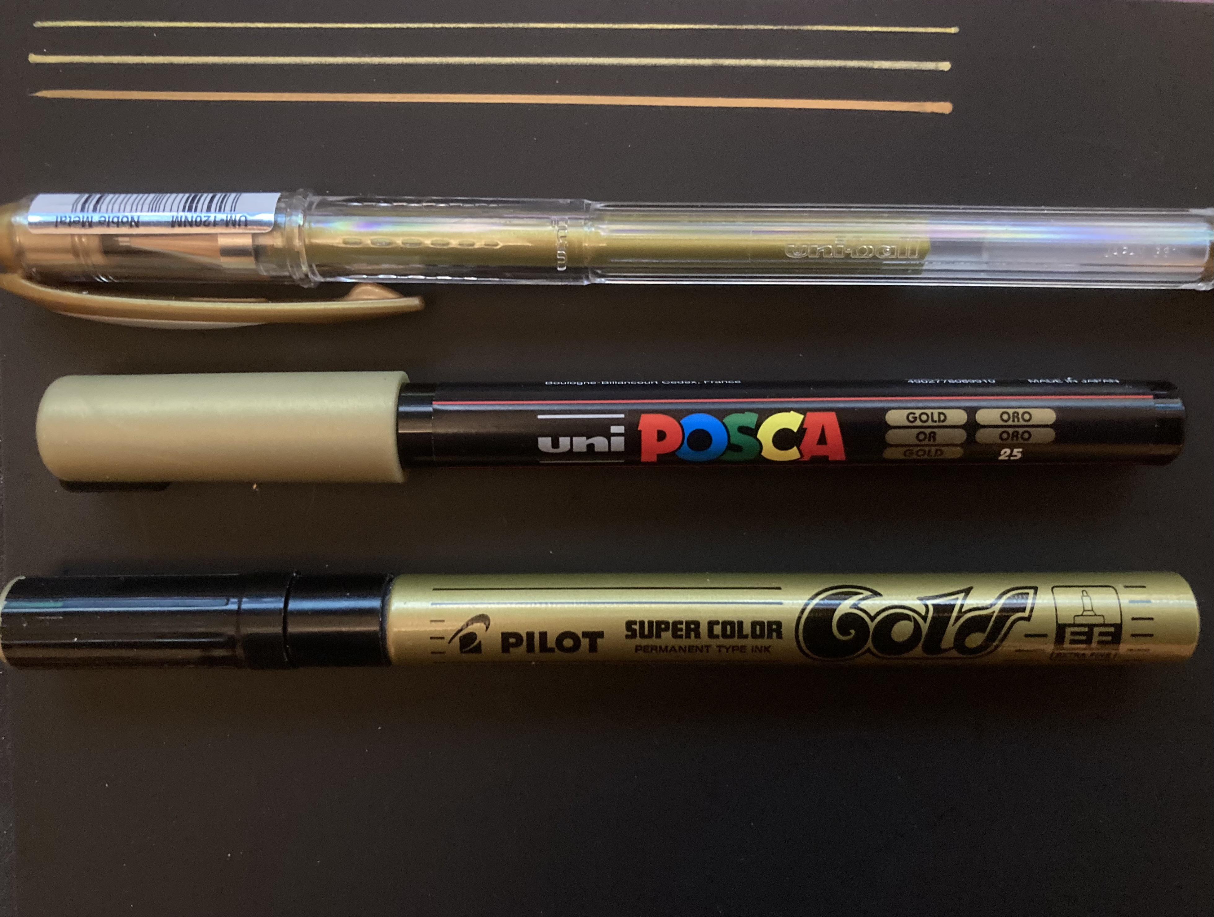

Looking good! For thinner gold lining from a pen, I suggest trying Uni-Ball Signo Gel Pens. I’ve had some success using one of these (also available in silver and white). Success is dependent on how well the roller ball can grip and therefore rotate properly on the painted surface. Matt paint worked better than a gloss finish in my tests.

Quick test to show different line thicknesses from (top to bottom) Uniball Gel pen, Posca PC-1MR and Pilot Super Colour Permanent Ink pens. The Pilot pen is also sold by uni-ball as the 0.8mm permanent paint marker.
You can see where the gel pen has not produced a consistent width line due to the roller sliding rather than properly rotating. This was on unpainted black plasticard. A Matt painted surface gives more consistent results.

Durley wrote: Wed Dec 11, 2024 9:18 pm Quick test to show different line thicknesses from (top to bottom) Uniball Gel pen, Posca PC-1MR and Pilot Super Colour Permanent Ink pens. The Pilot pen is also sold by uni-ball as the 0.8mm permanent paint marker.
I have the Posca and the Pilot and others.
They really do need the paper or a matt surface to drag the fluid out as the glossy surfaces proves troublesome. So far the Posca gives the thinner line but not as consistent as others. I may try out the Bob Moores lining pen with paint to firm up the decision. I think I have some more pens coming in the post to trial.
