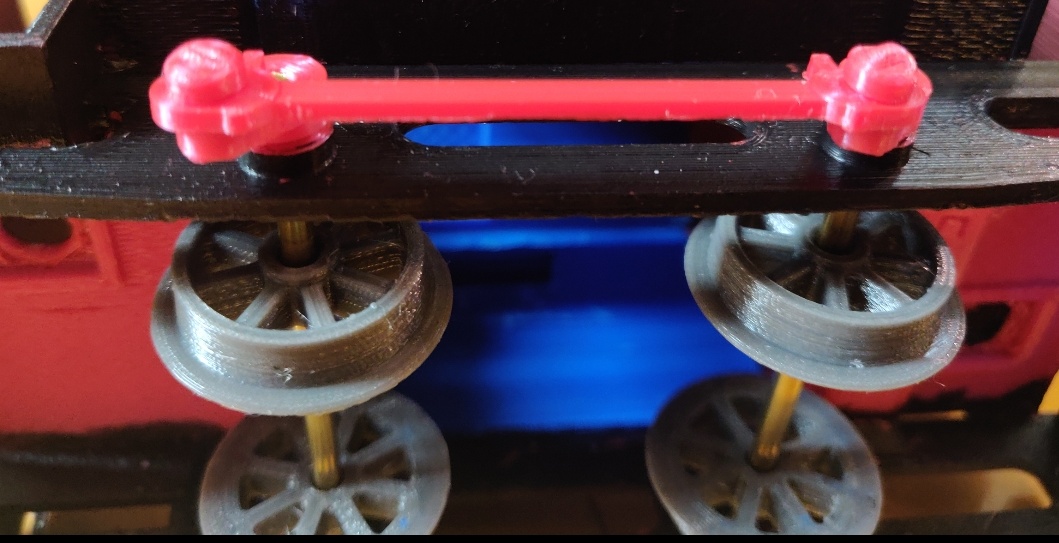

by drewzero1
I think my favorites that I've done were in grey PETG, which has a dull shine like unpolished metal. I might have to try Philip's silver material trick though; the mask idea is clever. :thumbup:

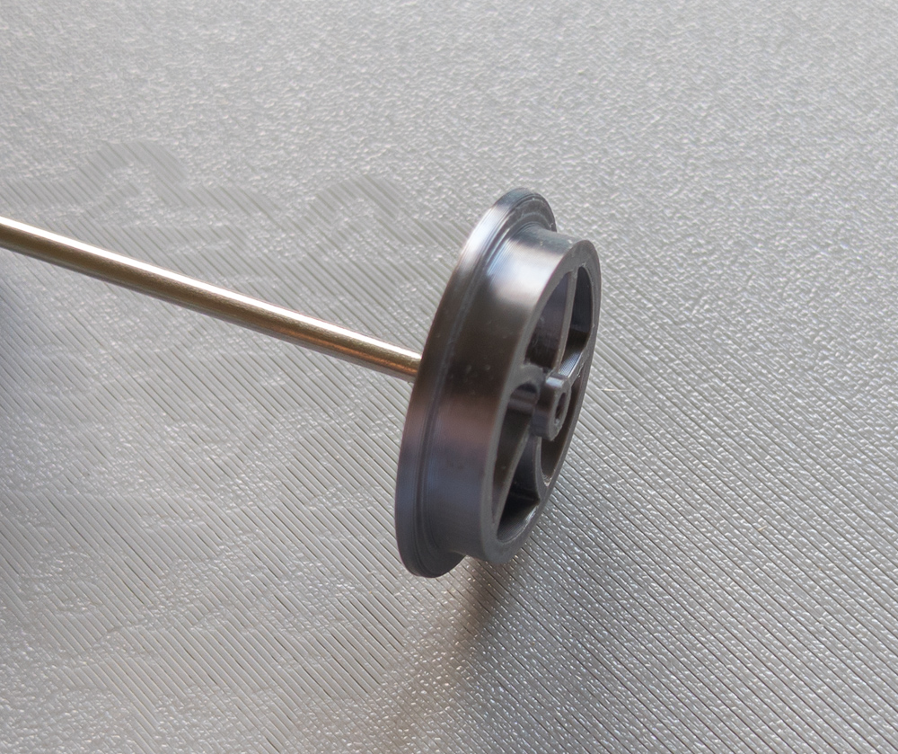

Posted: Sat Oct 05, 2024 9:49 am
by Paul_in_Ricky
Finally found a filament that fits the bill for me; CC3D Iron gray PLA silk https://www.amazon.co.uk/dp/B0C33QBT73
Not too shiny and silvery, a good dark steel colour. Printed well with a 0.4mm nozzle on default PLA silk settings on my Bambu A1.
Sorry about the image quality, just a quick grab with my phone.
