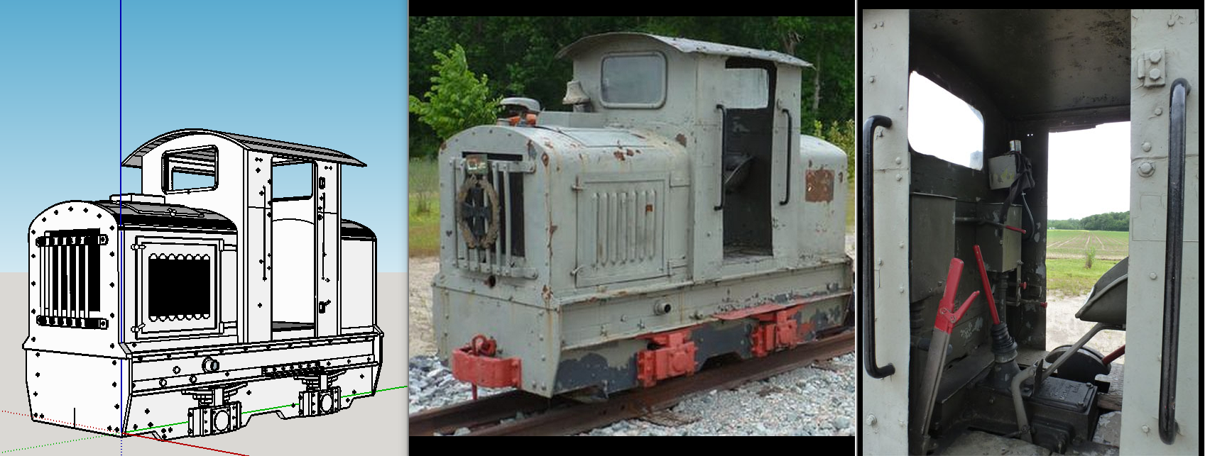

The biggest problem is with no known dimensions! However, I believe it was for 600mm gauge lines, so I drew two verticals from the bit of track visible at the front and assumed them to be 600mm apart and "guesstiscaled" from that! I eventually ended up with a door height of about 91mm, which seems reasonable, so hopefully overall I'm not too far out.
Still a lot of fiddling about needed and a couple of questions need answering. The biggest question is, what is the "thing" on top of the front of the bonnet? It looks as though it could be a radiator top up filler at the front, but what the cowl looking thing and the 2 red blobs are, is defeating me. Any offers?
(I have wondered if it could be the remains of a headlight, since this beastie doesn't seem to have any lights, or fittings or brackets for one.)
I still have to draw and mount the bell, of course, couldn't have a loco without one of those! :lol: :lol:
There is a square box on top of the bonnet, which at the mo I've drawn as an open top box, assuming it was used to dump tools, or chains, or something, in.
That one 3/4 photo shows no detail at all for the rear bonnet apart from the works plate, so I've made the shape, and height and face the same as the front one but with the radiator grille removed. No idea what else to put on it.
Similarly, there is no info at all about the far side, so I've just made it a mirror image, until somebody tells me otherwise.
The second picture gives some nice cab detail, when I get that far, but is also useful in giving some detail of rivets and bolts on the side sheets which are too blurry on the main picture.
I haven't even thought about a mechanism yet, but as best I can guess, working from the centre of the bearings to the nominal rail level, it will be 24mm wheels.
Thoughts and even answers to my queries are very welcome.

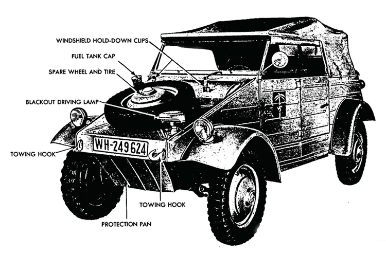

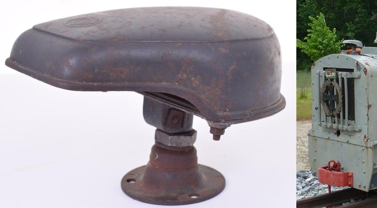

My first thought was also an air filter, but a similar structure shows up on the front of KdF/VW Typ 84 (Kubelwagens) and Typ 144 (Schwimmwagens) of the late 30s, which have their engines at the back, an d the mounting pipe seems a bit thin for an air intake. I found this diagram which calls it a blackout driving lamp.
It's hard to tell from the picture if it's far enough forward to work though. Maybe it is an air filter after all? :scratch:

Thanks Drew, that's brilliant... I'm sure that is exactly what it is. Putting the two pics side by side, it couldn't be anything else.
blackout lamp.jpg (319.13 KiB) Viewed 274023 times
Heaven knows how to draw that shape, but I'll give it a go and then, with the filler cap in front, worry about the red blobs later!
I've jusrr found one for sale on ebay for £490
Usefully they have put up loads of pictures from every angle.
https://www.ebay.co.uk/itm/276156648383

Edited to add, that I've just found a taillight on ebay manufactured by the same company and I just wonder if that is the red blobs?
Logically they could have needed rear lightt as well .Take a look at
https://www.ebay.ca/itm/385685812805?it ... R57k0LW9Yw

Well done, folks, for identifying the lamp. No way, I'd have guessed that's what it was.
I think I'll put a conventional lamp on my loco. Presumably, as this loco worked on a wartime airfield, it needed a blackout lamp.

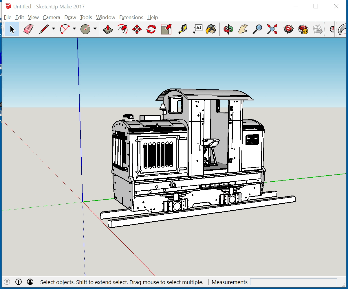

Now have the makers plate on the rear bonnet side, the bell, radiator cap and a "blackout light".
I'm not altogether happy with the light, but its a really complicated 3d shape and this is the best I could come up with so far. I might have another go at it in the future.
Interestingly, there are two hinges on the rear side of the cab door opening, but they are inside the grab handles, and the doors would have mangled the handles when swung back past 90 deg, so presumably there were doors ( armoured?) during the war which were removed and the grab handles fitted after hostilities ended.

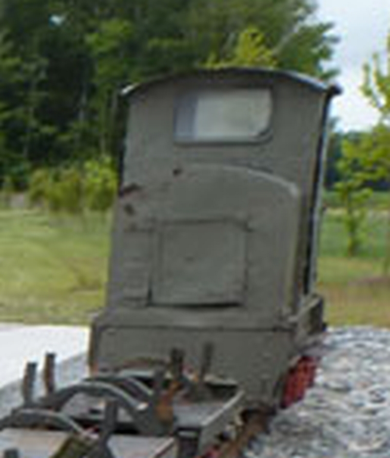

Looking again at the website that Rik linked to originally, I realised that there is a picture of the loco and its train from the far end. It's a long way away and little detail is visible, but there is definitely an opening which equates to the radiator grille at the front but seems to have a solid ( hinged?) cover on it. There is also something low down on the LH side, but no idea what it is, and there could be something on top of the bonnet at the RH side against the cab. Any offers?

Posted: Wed Feb 28, 2024 6:56 pm
Looks like hinges on the LHS of the 'flap'. It might be something similar to the hatches on the side of the front bonnet but minus the louvres.

ge_rik wrote: Wed Feb 28, 2024 6:56 pm Looks like hinges on the LHS of the 'flap'. It might be something similar to the hatches on the side of the front bonnet but minus the louvres.
Yes, thats about what I was thinking as well, thanks, just wondered if anyone else might see something different.

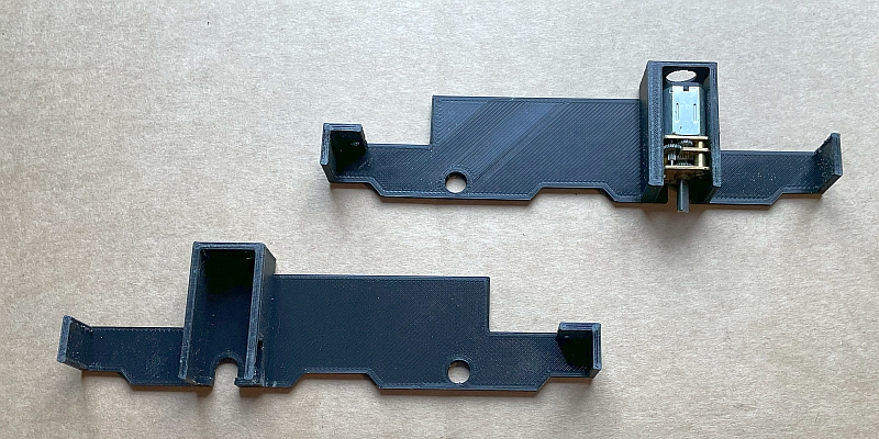

However since I have the dims, together with a standard motor which I have in stock, that allowed me to design the chassis. I want to get 4W drive using Delrin chain and sprockets. In the past this has been a bit of a pain because the sprocket hubs are a bit long to get inside the frames and need shortening, however with the 30mm shafts, the motor can be offset to one side and allow room for the sprocket as supplied.
The chassis is cut lengthways so the the outer faces could be printed flat on the bed and give a good surface. So, this is the two halves with a standard N20 GearMotor laid in to check. The one which is on order is longer at 33mm, because of the crosshaft :
This shows the two halves just placed on top of each other, illustrating the off-centred motor. In due course it will be trapped in place by a keeper plate, screw fixed to the bottom. This also shows the space for the chain sprocket.
I'm planning on everything beind attached to this chassis, and the body just dropped on over the top, because in the past I've tended to have the Rx and batteries, etc, just poked in where ever they will go. So, the motor will be powered by 5xNiMh AAA rechargeables sitting in a box fixed to the chassis in the rear loco bonnet - unfortunately there isn't quite room for AA batteries. The box is currently on the printer.
