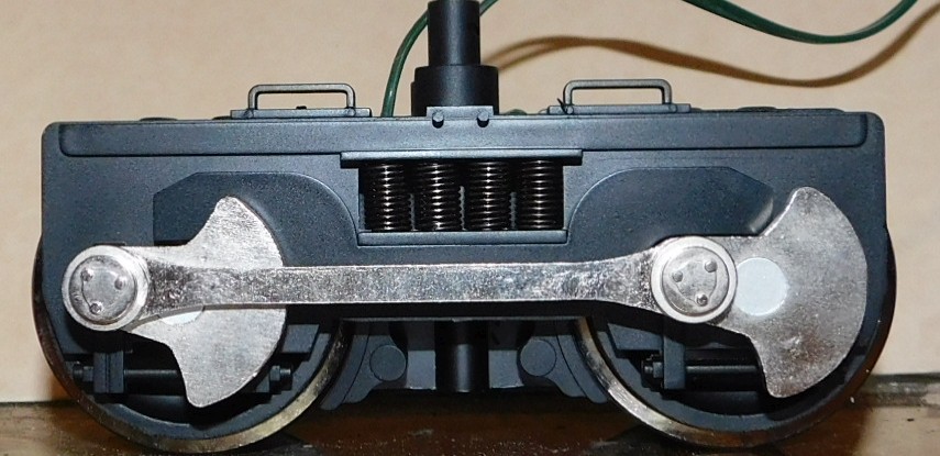

One unforeseen problem is that the wheels are quite large – 41mm dia.
Note the metal ‘ spigot’ on the motor block that sticks up.

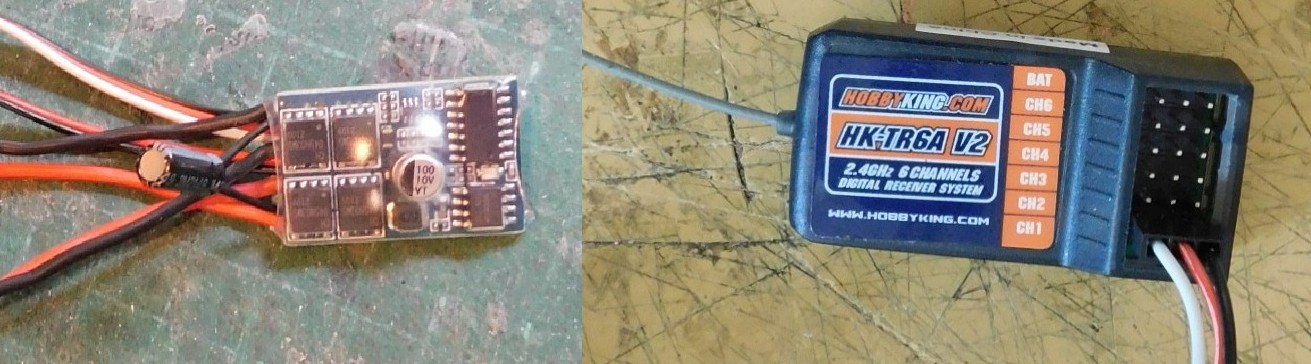

I purchased a Pololu bidirectional speed controller for use with my usual Hobbyking 2.4GHz receiver. This ESC uses a centred ‘stick’ which is pushed up for forward and down for reverse and has to be held in position. This is OK for the short indoor line. (I could remove the stick spring )
These ESC are only about 10 AUD but their limitation is a max voltage of 8V.
ESC+ Rx.jpg (154.23 KiB) Viewed 65746 times
The esc and Rx are in the boiler front and have to be inserted from the front (smokebox) because of that spigot sticking up. (I cut some of it off)

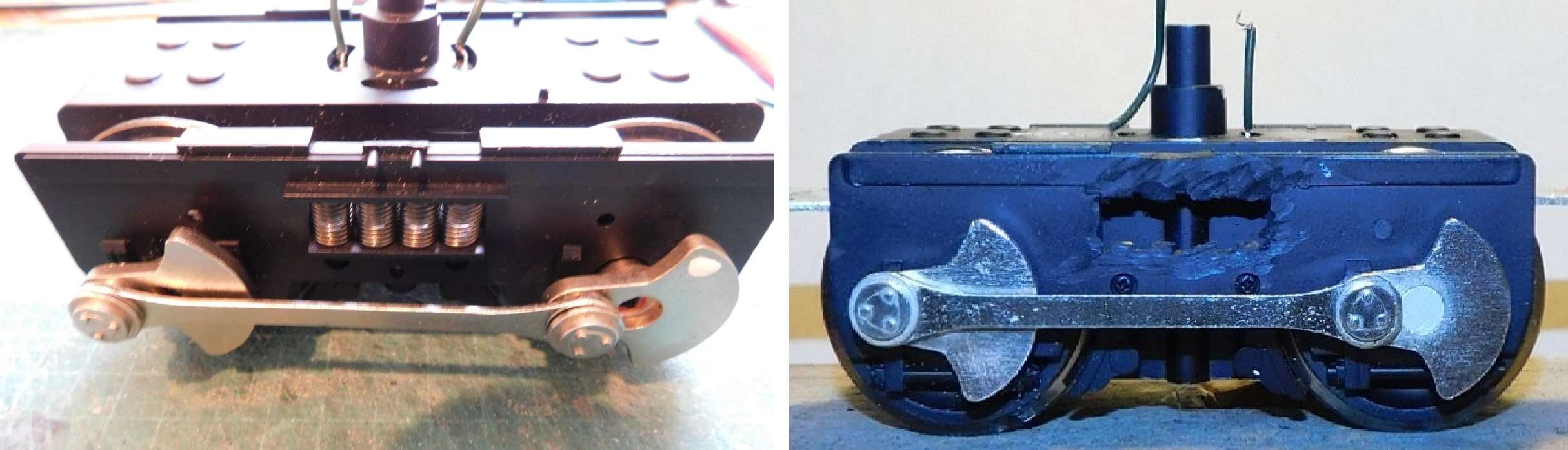

I had to cut off bits of the existing ‘diesel looking’ frames and springs, so that the new sideframes I make will slide between the wheels and coupling rod+weights.
compare sideframes.jpg (415.03 KiB) Viewed 65746 times

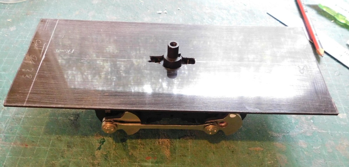

So I finally put knife to plastic and cut out the baseplate from 2mm thick styrene sheet.
(I buy styrene sheet in 5’ x 3’ sheets of 0.5, 1.0, 1.5, and 2.0 mm thicknesses.)
first baseplate(2).jpg (149.22 KiB) Viewed 65746 times
I contact glued two aluminium angles to the motor block ends to support the baseplate and to allow me to screw the whole body onto the block, from underneath.
Then I screwed the baseplate onto the motor block and somewhere I had got my measurements wrong. The baseplate was 51mm above rail – much higher than the planned 43mm and it looked horribly wrong!

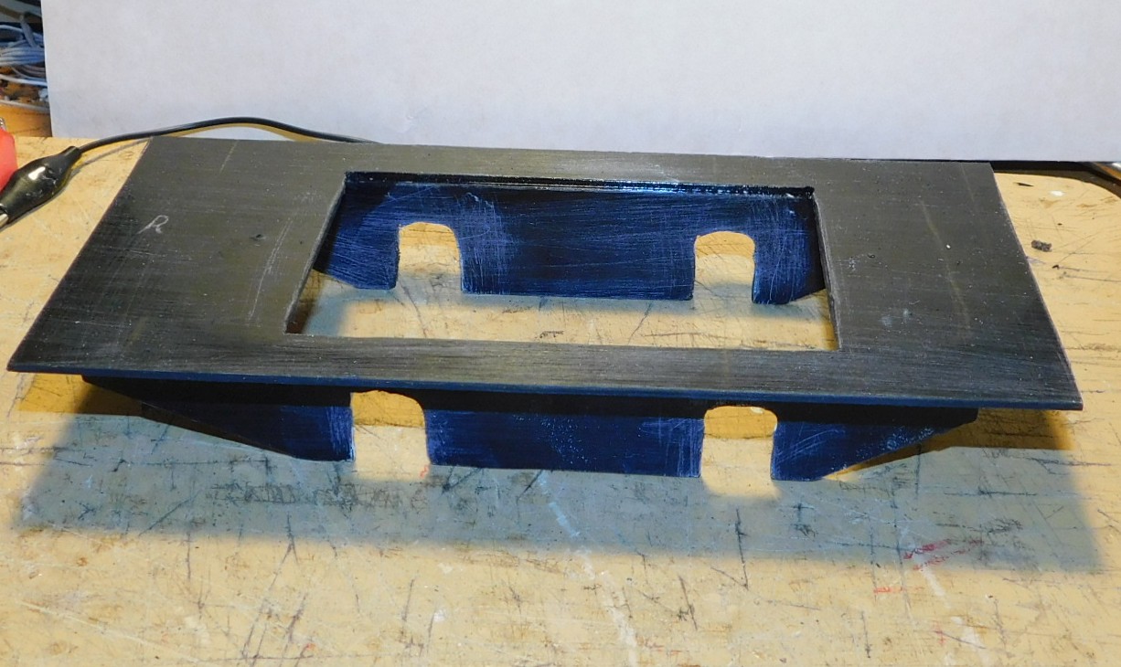

Anyhow, here is the next exciting episode of slow progress.
So after the debacle I decided to cut a big hole in the baseplate to allow it to fit down over the motor block. This weakened the 2mm styrene but luckily the outside frames running the length of the loco have strengthened it.
I also had to pull the glued alum brackets off the block to re-glue them lower them. And all the side tank pieces that I cut out are now wrong size too. Grrrrr.
second baseplate and sideframes.JPG (199.89 KiB) Viewed 65302 times

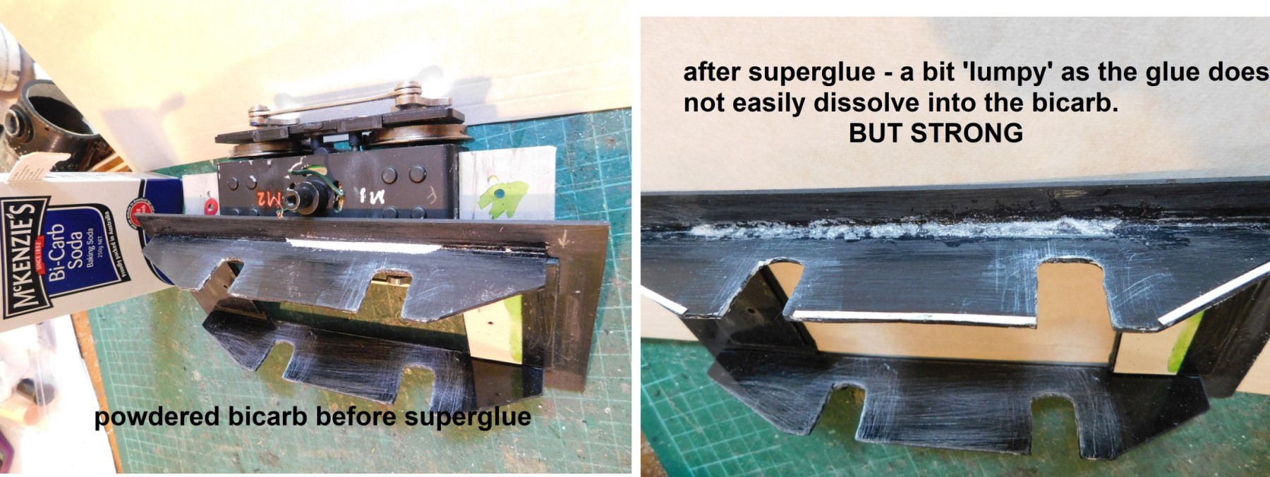

I used a new (to me) method from YouTube to make ‘ fillet welds’ where 2 pieces of styrene are glued at right angles. The ‘fillet’ is made from Baking Soda powder, then superglue is dripped on. It sets like ‘rock’. But looks pretty ugly.

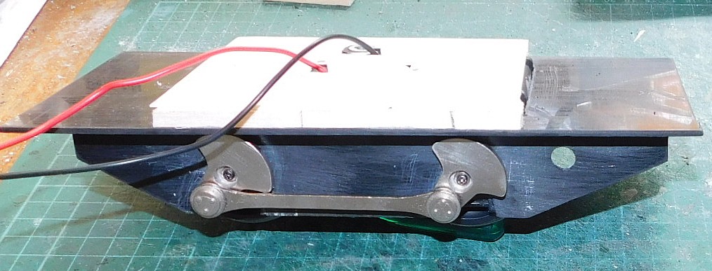

After much filing I managed to get the new sideframes to clear both the wheels and side rod/weights, but finally I could bench test it with no scraping noise.
Then it was time to solder the six AA cells together and test the whole thing on battery power with the esc and RC, and all OK! – giving 30 scale kph on 7V.
(As a side issue, I had tried to remove the coupling rod and weights to get easier access to the original side frames. I had to ‘dig’ small plastic covers off the axles. The rod+axles are then held on to the axle by screws that seemed to be Loctited on. So I decided to not continue.)

There's hundreds of videos on youtube about baking soda and superglue like this one
https://www.youtube.com/watch?v=WKu2mB1BrN0
BUT, my superglue does not instantly soak into the baking soda - more like water drops on dry soil. The superglue just runs off. Would be nice to find if a different superglue works better than the 4 tubes for $3 stuff I use.
It really is rock hard and not easy to file - the pic above shows after I attempted some filing.
If anyone does more experiments how about a separate Topic?

Just use a thinner superglue. They come in different viscosities, thin is great for soaking into anything and thick is good for bridge filling. Kicker is also a good way of hardening superglue.
Re: Building an 0-4-0 outside frame tank loco
Posted: Tue Jan 23, 2024 11:01 am
Greg, I'm really surprised that you feel the need to add this mixture. I find that plastikard forms a strong bond if a solvent (eg. EMA Plastic Weld) is used to weld the surfaces together.
Tube glues, or superglue don't have the same effect as they just sit on the surface.
Posted: Tue Jan 23, 2024 12:44 pm
by Andrew
Peter Butler wrote: Tue Jan 23, 2024 11:01 am Greg, I'm really surprised that you feel the need to add this mixture. I find that plastikard forms a strong bond if a solvent (eg. EMA Plastic Weld) is used to weld the surfaces together.
Personally, I was thinking it might be useful in some applications where I currently use Milliput or similar. The one I'm thinking of, off the top of my head, is securing a bolt inside a (biro tube) brake column, so it can be fixed to a carriage floor. It would probably be easier to put the bolt in, fill with powder and add superglue...
Posted: Tue Jan 23, 2024 3:08 pm
I totally agree with your comment Andrew and I work in a similar way, usually using epoxy adhesive etc... From my experience with attaching plastikard to plastikard using solvent, even on large section such as structures, I have found solvent works well enough on its own.
Posted: Tue Jan 23, 2024 5:14 pm
by -steves-
Peter Butler wrote: Tue Jan 23, 2024 3:08 pm I totally agree with your comment Andrew and I work in a similar way, usually using epoxy adhesive etc... From my experience with attaching plastikard to plastikard using solvent, even on large section such as structures, I have found solvent works well enough on its own.
As solvent melts the plastic, it creates a weld rather than a traditional glue. For this reason it is usually stronger on the weld line and it's generally the plastic either side of it that tears.

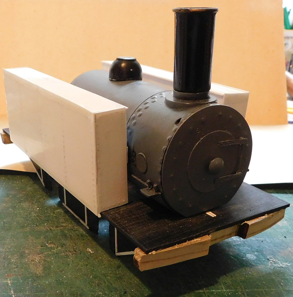

After wasting a week on Picaxe programming, I finally came back to actual modelling.
I found a small dome from some old kitbash and glued and screwed it to the boiler.
I epoxied the boiler to the baseplate, with all the usual hassles of getting it centred on the baseplate, making sure it is level lengthways and that the funnel is vertical.
boiler on base.JPG (217.05 KiB) Viewed 64699 times
The firebox backplate is also a push fit like the smokebox, to allow access to the electronics in the boiler.
Then I could start making the side tanks. These had to be ‘deep’ enough for AA cells diameter– ie 16mm internal and they just fitted beside the boiler – for once my measurements worked. They were made from 1mm styrene covered with 0.5mm styrene which had the rivets embossed from the back using a dressmakers tracing tool. I made so many errors in cutting all these out that I began to wonder if I would ever finish this build.

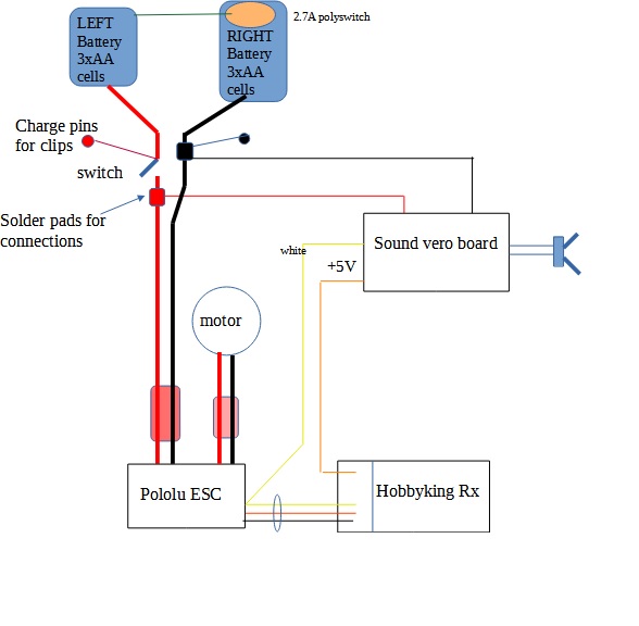

By now I have the wiring diagram decided ie where things go and how to connect them and hopefully holes in the right place for all the wires.
wiring diagram.jpg (48.94 KiB) Viewed 64699 times
