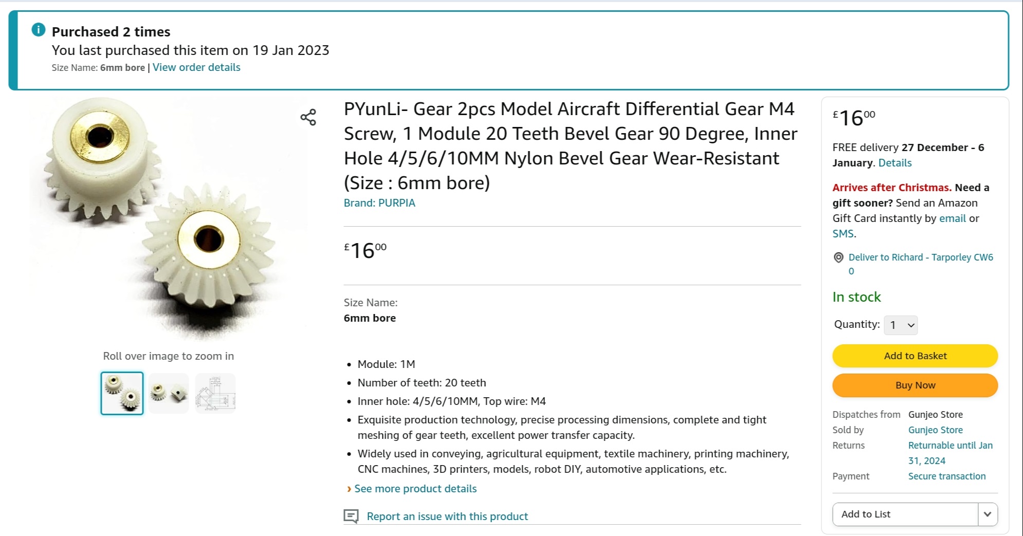

  • 2 x 6mm bore bevel gears (from Amazon)

Here are the 6mm bore bevel gears from Aamazon
