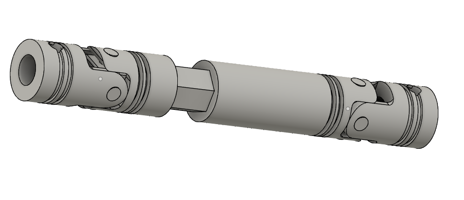

I have found this on the net, I think I might be able to construct something similar in Tinkercad and use it as the hex part would be made to slide in and out of one another. Any thoughts on if this would work? Please :)
The second picture is the same part but without the ends on.
Screenshot 2023-11-13 102733.png (106.5 KiB) Viewed 68143 times
Screenshot 2023-11-13 102252.png (105.02 KiB) Viewed 68143 times

-steves- wrote: Mon Nov 13, 2023 10:29 am Wow Trevor, that's amazing! I wish I knew how to use Sketchup, then the drawings would be extremely useful to but, but alas, I am a Tinkercad special :(
I think that sort of coupling could be made to work. I would prefer a square shaft in that I think the 90 degree angles would be less likely to bind under load than 60 degree angles on hex bar.
I would make the pins in the flexible part from metal. Otherwise just try it! Nothing ventured nothing learnt.
