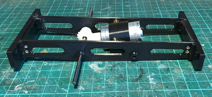

This shows the frame assembled, but the motor mount not yet screwed in place. At this point I also realised that the axle holes are just 3mm diameter which fine for the axle itself but doesn't allow for a brass bush, much less a bearing. I should have done something about it before getting this far!

I couldn't find a source of the motor Drew used, available in a reasonable time, but I found a close alternative which had the same 25mm diameter. I did have a bit of a problem with the two-part motor mount which I couldn't get to both line up with the axle and sit between the frames. In the end I slightly redrew the side pieces to make them deeper but I'm not sure what the actual problem was since my motor is 25mm diameter, the same as the original.
As with the chassis frames, one side of the motor mount is glued and the other screwed to allow the mechanism to be dismantled if necessary.

Looking good! I like the improvements you've made. That smokebox door was actually one of mine, though the as-built Thornas' used a similarly crude one from Thingiverse (scaled up from an O-16.5 design). Yours looks much better!
I'm also not sure what's wrong with the motor mount but that was one piece I kind of rushed and meant to come back to later... I guess it's later now :oops:
I had a kind of revelation an hour or so ago and I think I may have found a better answer. I know your motor is 25mm diameter but how long is it? (body + shaft). I'm printing a new motor mount as we speak and I'm 95% sure it will work for my motor but yours may or may not be too long.
The gearbox of those '25D' gearmotors is 25mm dia., but the motor is usually 24.4mm. Not an issue if they are mounted to a bracket using the M3 tapped holes in the gearbox front plate as designed. Clamping them around the middle will have to account for the difference in diameters, or the motor may move around under load.
Yes, agreed Graeme. Drew's clamp mount does work and holds it securely, but I had a problem lining it up with the axle visually since there is no means of positive location prior to fixing. I'm playing with a U-shaped bracket to use the 3mm tapped holes as you suggest, and with my motor it just goes in vertically, but I'm not sure how long Drew's motor is, so if its a tiny bit longer it probably won't fit and might have to be angled. Not a major issue either way but I just wanted to be aware.

philipy wrote: Wed Oct 25, 2023 1:56 pm I had a kind of revelation an hour or so ago and I think I may have found a better answer. I know your motor is 25mm diameter but how long is it? (body + shaft). I'm printing a new motor mount as we speak and I'm 95% sure it will work for my motor but yours may or may not be too long.
Total length approx. 65mm. The upper and lower parts were split with a few mm gap between them so the screw tension could tighten on the motor, though a shim could be used around the motor if it's not enough. (Rubber could help dampen motor noise, though the motor I've used turned out to be quieter than expected.)
I did use the tapped holes on the end to secure the motor to the axle, but it looks like I forgot to include that part as well. :oops: :oops: Mine used a slit to allow it to be passed over the axle after assembly, but with your removable side frame yours may not need that. I'll see if I can find the part file for that and post it. (EDIT: I've found them and posted them with the other Thornas files, click here to view.)
Note that my axles are 3.175mm (1/8 inch) because metric brass stock isn't available locally.

Early on, Drew said to me that he had been trying to find a way of making the mchanism removable, and after several hours drawing and a short while with drills, saw and files, I think I've achieved it. :D
The U-shaped motor mounting bracket that Drew posted on Thursday was similar to one I had been playing with myself, but I've had a problem in that the bevel gears I had were too big to get between the inside frames. I've been reluctant to print gears because I wasn't convinced that they would stand up to much use, but in the end I've finally gone down that route and it does have the advantage that I printed one with a 4mm bore for the motor shaft and one with a 3mm bore for the driven axle.
So, the problem with a removable drive mechanism is locating it accurately and fixing it into the outside frames, since the axles have a bearing in the frames themselves. Eventually I realised that if the motor mounting bracket was outside of the wheels it could be made to fit snugly against the inside of the frames. From there it was a short leap to realise that the frame bearing could be printed as part of the bracket, not as part of the frame itself and that if the frame had a slot in it, that slot could be filled by a part printed on the motor bracket as well.
Screenshot 2023-10-28 12.50.43.png (28.18 KiB) Viewed 259394 times
In hindsight I should have made the bracket a bit wider to get a fourth screw in, but I don't think it will matter.
Having drawn it up and printed it, a small amount of fettling had it neat and tidy and after half an hour or so I had the slots cut and the frame bearing bosses removed and it slid neatly into place from below. The mechanism then just requires some small screws into the frame to secure it. This also has the bonus that I can now glue the previously screwed sideframe and make a permanent job of it. :D
I think I'm going to reprint this side, with the cutout 'built in' and without all the extraneous screw holes - will be easier to reprint than mess about trying to fill all the holes!

Looks great! If you use a similar notch setup for the unpowered axle, both could be removed for maintenance or replacement. I might have to modify the new one I've been building to allow for that possibility. How long is the motor you're using? Mounting it vertically like that should give you a lot more room for ESC/receiver/sound card, or more battery space.

The motor+gearbox is 42mm o/a plus the shaft at about 10mm.
I did think about doing the same for the unpowered axle, but once it is all together and running properly, I can't see that that axle would need to be removed very often if at all, ever. Having it all flopping about unrestrained would potentially put a lot of strain on the coupling rod/crank joints so I think if I ever needed to remove the motor etc I'd undo the coupling rods anyway.
Do you want my stl for the notched frame? Yu are more than welcome to it.
