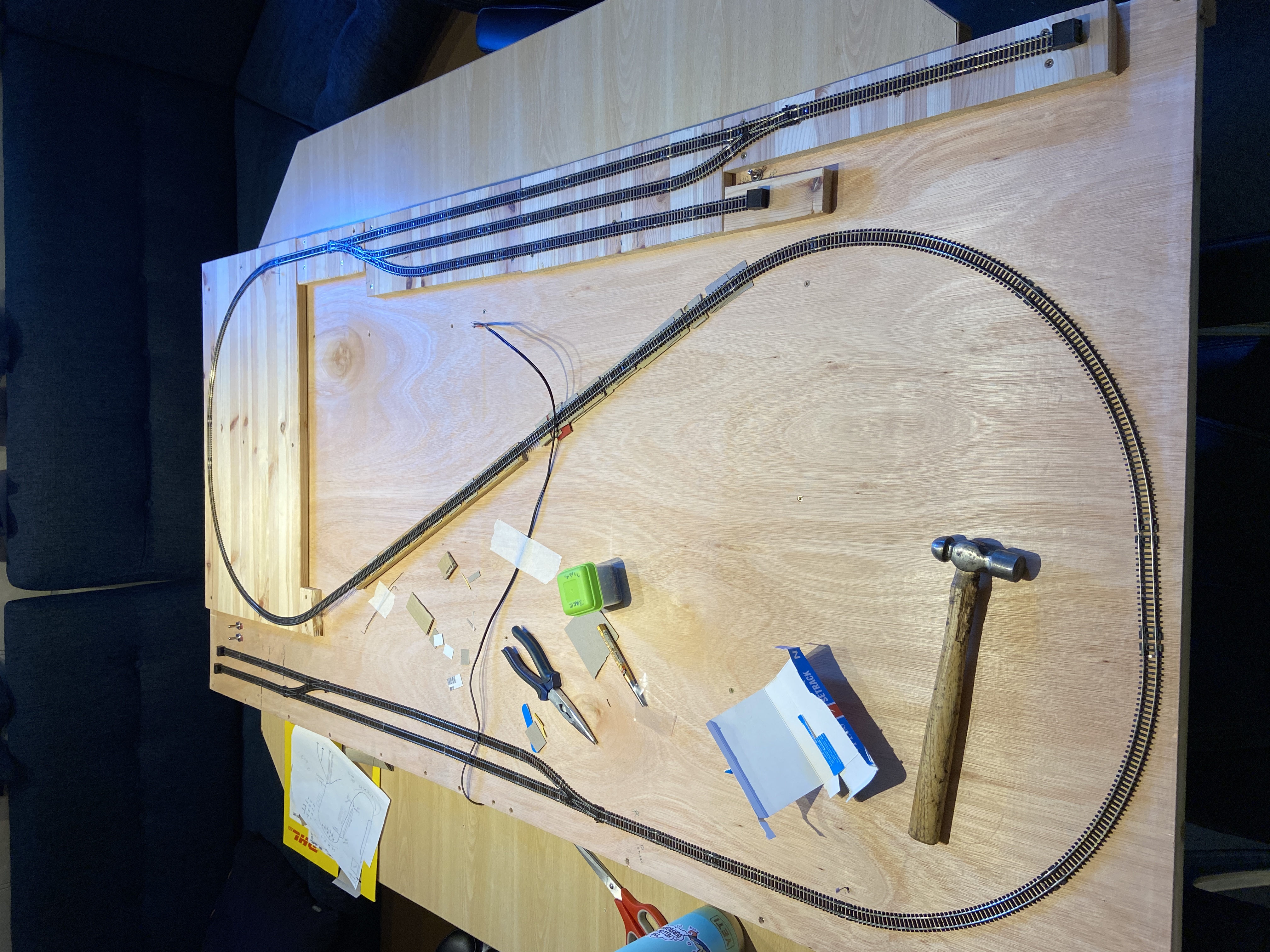

As an aside to building a layout in the garden, can anyone help with ideas for a quick build - something like and inglenook layout that can be built to just be able to run my two locos - 1 live steam 0-4-0 Roundhouse Mildred and 1 battery electric Littlejohn.
The reason for this post is we have built an N gauge layout in less than an evening on a 6ft x 2.5ft baseboard at work. Now with the 16mm stuff needing a bit of thought for a garden layout I'd like something similar that can be stored in a shed and pulled out to run trains. I'll try and add a photo of the n gauge layout.

Thanks all. The plan in my head is something like an inglenook on an 8x4 baseboard. That way it can live in the shed and come out on trestles/ workmates when I want to have a play.
The biggest hurdle I have found with getting started with something more permanent in the garden is not being able to run my locos at all and losing interest before groundwork’s have even started.
Building that n scale end to end has given me the inspiration to crack on but this time, build a simple baseboard layout in sm32 so that the drive to build in the garden stays.
The Mildred and Littlejohn have sat on a shelf for the best part of 4 years now.
