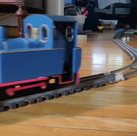

I was skeptical of gearmotors at first but at Rik's suggestion I picked up a can gearmotor unit for my steam outline scratch build. At 176RPM it's plenty fast and I've started running it at half voltage to keep it on the tracks! The wheels are somewhere around 22-24mm dia and the bevel gears are 1:1. Here's what it looks like at full power:
- Posts: 7751
Re: Gearbox motor
drewzero1 wrote: βThu Jun 22, 2023 10:50 pm I was skeptical of gearmotors at first but at Rik's suggestion I picked up a can gearmotor unit for my steam outline scratch build. At 176RPM it's plenty fast and I've started running it at half voltage to keep it on the tracks! The wheels are somewhere around 22-24mm dia and the bevel gears are 1:1. Here's what it looks like at full power:
