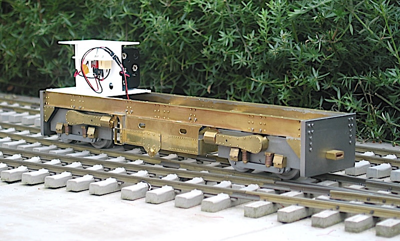

A bit more progress on this model.
After finishing two live steam loco paint jobs, I've moved on to wiring up the Harman so the mechanism can be tested.
I was a bit uncertain how well this model would run with just two little N20 gearmotors. Wiring has progressed to the point of track testing and it would seem the drive system is more than capable of doing the work.
To recapitulate, each bogie is driven by a Pololu 6V micro gearmotor with a 100:1 gearbox. The wheels are 33mm dia., which is quite large for this sort of loco, so the 100:1 ratio gear box was chosen to tame the speed, which was far too fast with the 50:1 ratio I usually use in small battery powered models.
Doubling the gear reduction also doubles the torque at the wheels. The power bogies can now slip the wheels at full voltage, which means the drawbar pull is limited by loco weight, not motor torque and a heavy train won't stall the motors.
The fully assembled chassis has a max. drawbar pull of 450g, which means it can easily pull a scale load of 10 loaded timber pairs at a scale speed of 10 mph. So it meets the design spec., which the prototype never did........ :study:
The photo shows the battery and control module fitted to the chassis during track testing in a gap between storm fronts last week.
By now it should have been completely wired, track testing completed and be passing through the paint shop. Ha.........
That's when Murphy and his disciple O'Toole stepped in and the R/C ESC intended for the model is as dead as a doornail. I'm now contemplating if it will be quicker to just build one of my manual speed controls, or wait for a new ESC to wend it's way here from the UK with the postal systems in Christmas overload mode.
The bright spot is that I now know that two N20 motors are up to the job of moving a 2.8kg loco and a train of ten loaded timber pairs.

This model is still no nearer to a tin of paint since the last update, but it has completed it's load test with flying colours.
It's good when a plan comes together...........
The photo shows the loco running around the track today, trundling along in late afternoon sunshine at about 20 scale mph with a scale load of ten timber pairs in tow. Theoretically it would pull twenty, but I don't have that many timber pairs and anyway the Harman was only designed to pull ten.
If you scroll to the top of this thread, you'll find photos of how the model is powered. Since there is presently some discussion on powering battery electric locos, that will show my current design standards.
The loco weighs 2.8kg and is powered by two 6 volt N20 gear motors with mitre gear final drives and manual speed control. Power is supplied by 6 Eneloop AA cells and the motors draw about 300mA each when running under load, so say around 3 hrs running time on fully charged cells.
Usually I use 50:1 gearbox motors, but in this case the driving wheels are relatively large at 34mm dia., compared to the 20mm dia. wheels on most of my rail motors. The large wheels meant the model was travelling at a speed of 55 smph at 6V when first tested running light engine.......... :shock:
The gear motors were changed to ones with 100:1 reduction and the speed at 6V running light reduced to a much more reasonable 27 smph. Note that doubling the gear reduction ratio doubles the output torque, which is also desirable. In this case with a 2.8kg loco, it means that at 6V the motor can't stall, as the wheels will slip first.
I've learnt enough over the years to read the data sheets of things like small motors and that is the starting point when I build a battery electric.
Relevant to recent discussion, with these N20 gear motors, there is no difference in the performance at the output shaft between the 6V version and the 12V version. What is relevant to model design is that the 6V motor will draw twice the current as the equivalent 12V one to give the same performance.
Like all engineering design, there are trade-offs. A 12V motor will use less current and so will run for longer on each battery charge, but then you have to find space for twice as many battery cells as needed by the 6V version. :roll:
Note, the N20 motor comes in high, medium and low power varieties. The HP is three times the power of the LP and the MP sits halfway between the others. I use the high power ones and buy a brand name motor with a label, in the reasonable expectation that the performance will match the data sheet. Good luck with online no name specials.......
