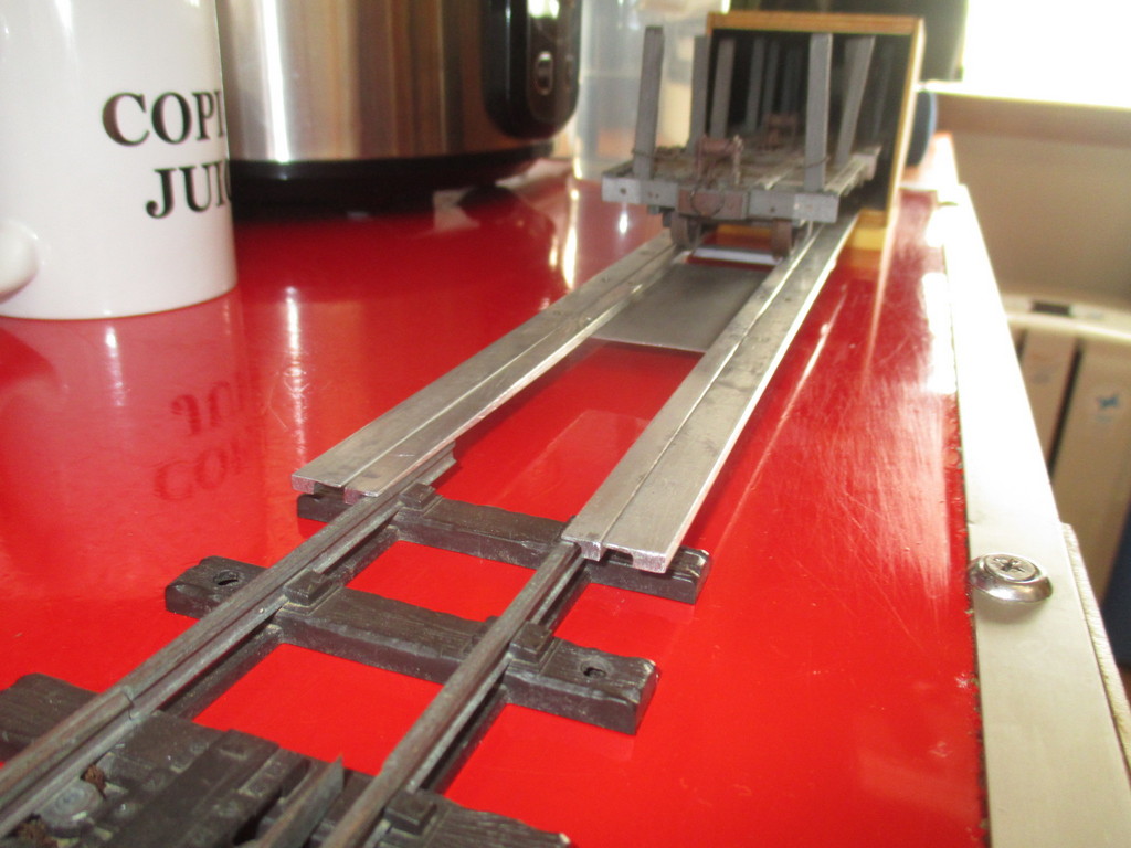

Next most painful job I wanted out of the way, was regauging the ramp used to load/unload stock and locos from their cassettes/carriers. I made it from aluminium bar and sheet a few years back, and it works very nicely.
Much like the cassette rails, another set of rails were ground and filed down from 9x3mm ally bar, then screwed to the ramp from underneath.
Now it's just the loco carriers to do. I don't yet have a carrier for every loco.
Same method as the cassettes, only tomorrow I'll throw a few coats of white enamel over the new rails, for resistance to any drips of oil and water.

All looking good Aaron. That's quite an array of storage boxes you have there.
