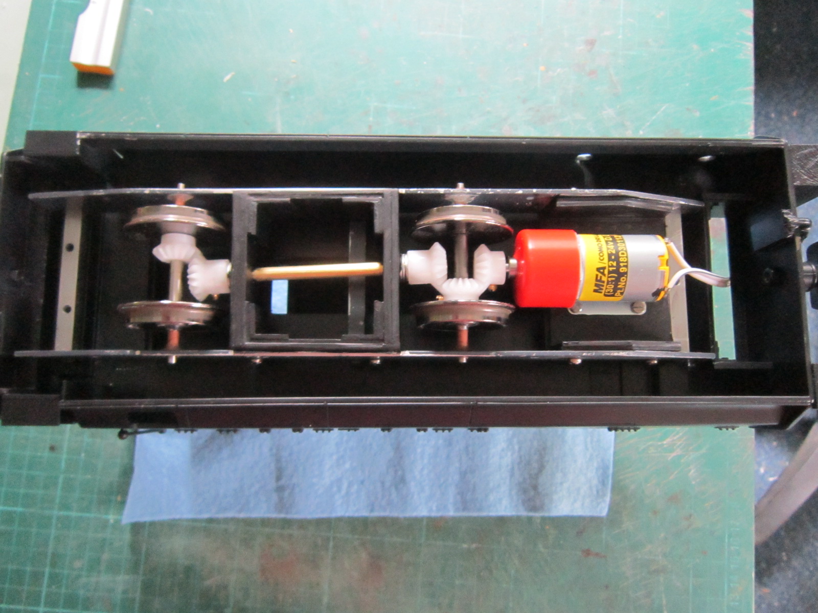

Why do very few people use bevel (mitre?) gears?
I understand a worm and worm-wheel can give a large ratio in one stage, but I would have thought transmission through a pair of bevel-gears would be pretty efficient? - Especially as our loads are not excessive.
Re: Noisy gears
Posted: Fri Feb 03, 2023 9:30 pm
Phil.P wrote: Fri Feb 03, 2023 3:17 pm
Please Sir.... I do!
I have been using nylon bevel gears for some years and they run smoothly and silently.

by GTB
ge_rik wrote: Fri Feb 17, 2023 7:50 am I see now that I should have been calculating DP, as Bachmann is a US company; though, probably, I still would have struggled to find an exact match.
Bachmann used to be American, but for a long time has been a subsidiary of the Kader group, which is Chinese owned. More importantly the factories and design offices are in China, so their gears are more likely to be metric. I wouldn't be surprised though if that strange worm gear arrangement they used in the early Lyn was a unique MOD size.
I've avoided worm gearing in garden scale and know just enough about them to be dangerous. I think they use an involute tooth form, but a properly made worm wheel and a spur gear aren't interchangeable, even if they are the same MOD or DP.
One of the 'fun' things about using gears is that the critical dimension is the PCD and that can't actually be measured, it can only be calculated from the other parameters. Which is why I pay the extra and use gears where the manufacturer specs. are available.
