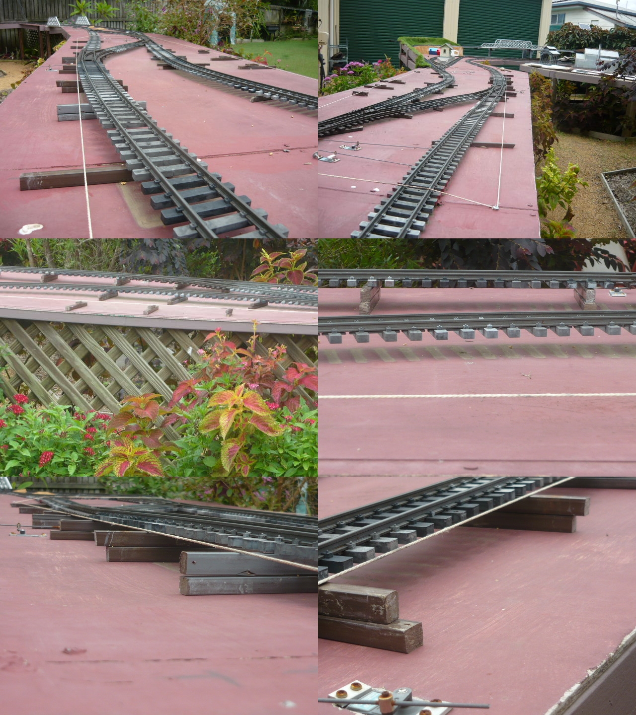

Due to ground subsidence (possibly where a tree was removed 3 years ago) an area of my baseboard sagged by about 30mm or more, this led to a large dip in the track with wagons uncoupling as the passed over the high points at either end and rainwater ponding in the low points in the centre.
Initially I thought I was faced with the prospect of digging up the centre supporting posts and raising the base board to level it off.
Further inspection revealed that the lattice frame supporting the area had bowed in the middle due to the centre supports sinking so the whole section would require replacement. This looked like turning into a major bit of work.
After a bit of thinking I came up with the idea of leaving everything in place and building an embankment using concrete render across the area which would raise the track and make the it level.
To save the amount of render needed and to reduce the weight I am putting in a couple of low bridges, this will allow the water to run under the track and into drainage hole drilled through the baseboard. In these holes I'm putting in some wicks to break up the water surface tension at the side of the holes and allow the water to flow down them into the garden below.

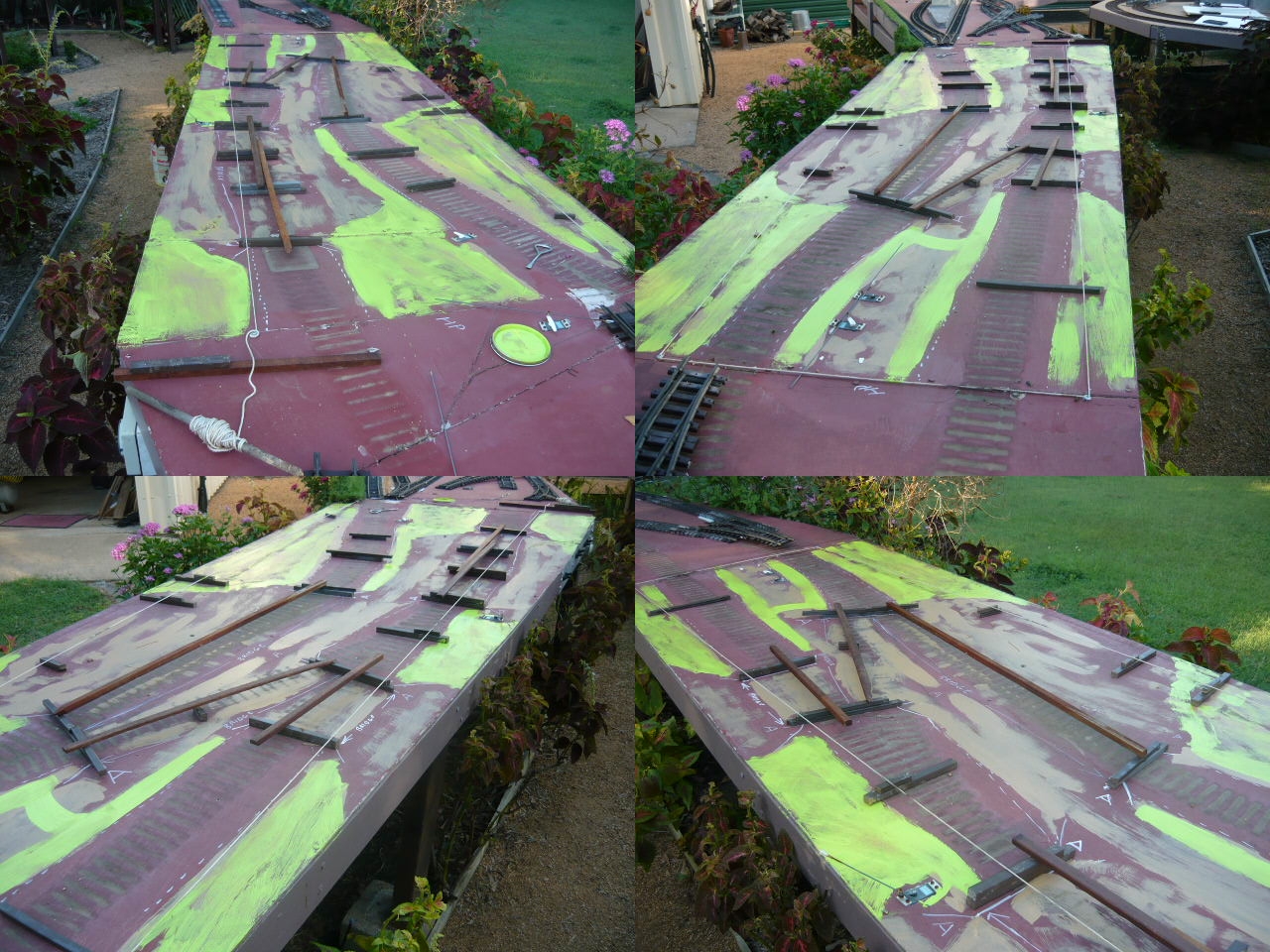

More progress on the embankment area.
I roughly painted areas where there will be a dry river bed a light brown, the embankment areas are in the red colour while the bright green is where artificial turf is in the plan.
Bridges are indicated by pieces of wood.
All the points will be on embankments.

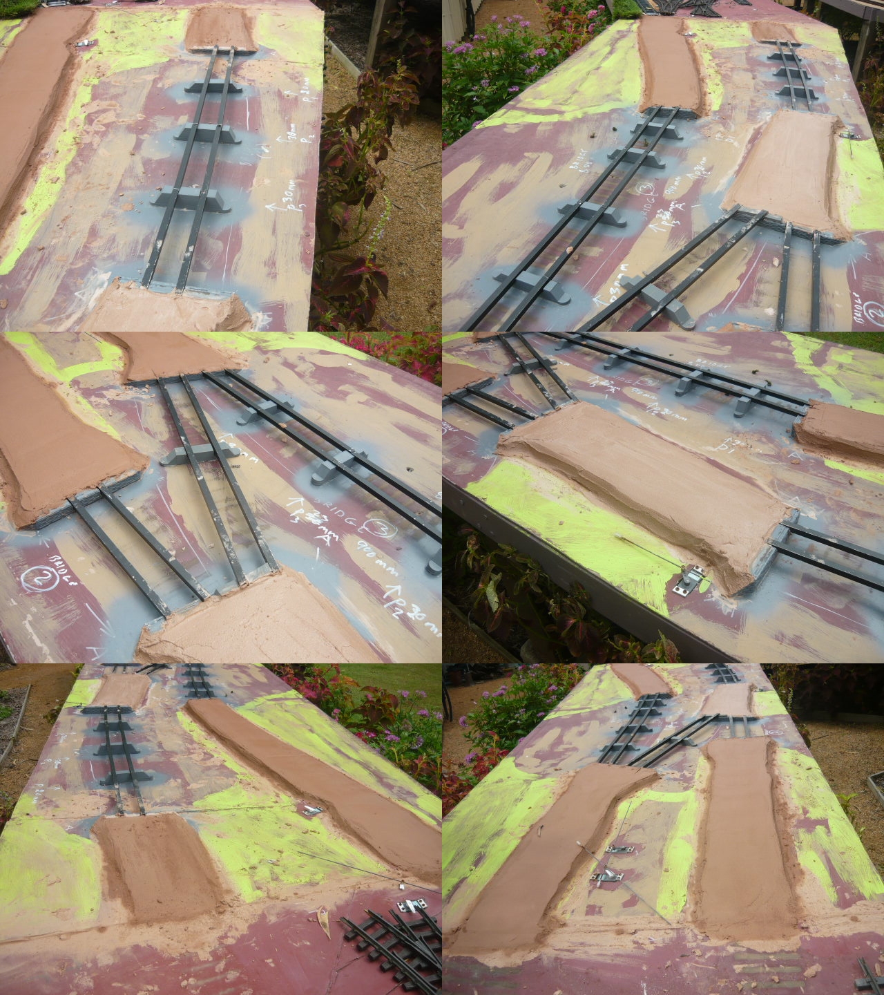

I have made some real progress in the embankments area.
Bridge abutments and piers have been installed, rail supports fitted and embankments have been made out of acrylic render.
After the track is relaid, I will finish the scene with artificial turf and gravel to give the impression of the line crossing over a dried up swamp and creek bed.

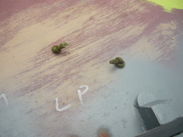

To carry water down through the baseboard at the low point (LP) holes were drilled through the baseboard and wicks put into them. These allow the water drain away quickly to prevent ponding.

Today I re-laid all the track in the embankment area so next step is to run a train to test it out.
Then it will be complete the scenery (turf, gravel etc) and it should all be done.

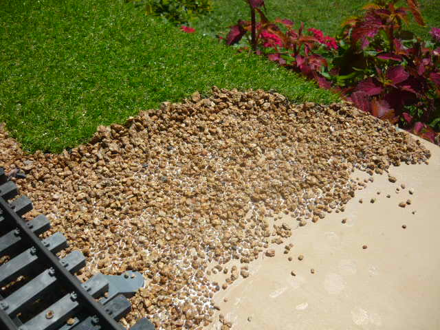

Laid the ballast and gravel on the embankments, all that is left to do is put gravel across the creek bed area.
As I have a gravel train I'm considering putting in a siding for a gravel pit probably on the garden side.

I finished the embankments area by laying the last of the gravel in the creek bed.
