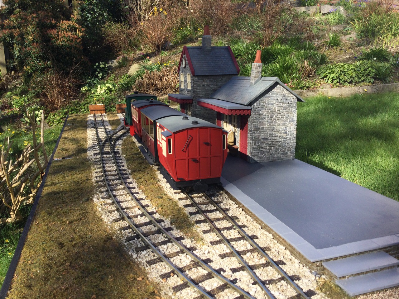

At the furthest convenient point along the wall
can now be found Yr Orsaf Newydd, here shown in an early stage of construction (this photo has also appeared elsewhere within this forum), living up to its name of 'The New Station' (for our non Welsh speakers!).
rather more finished.

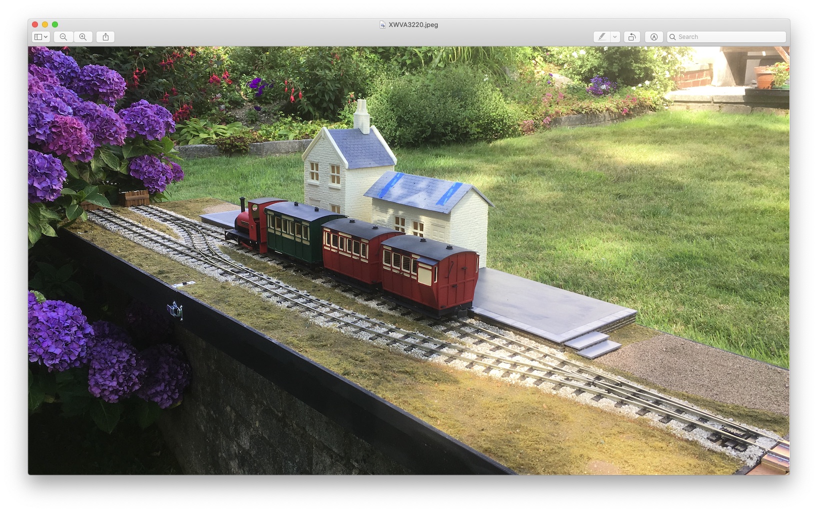

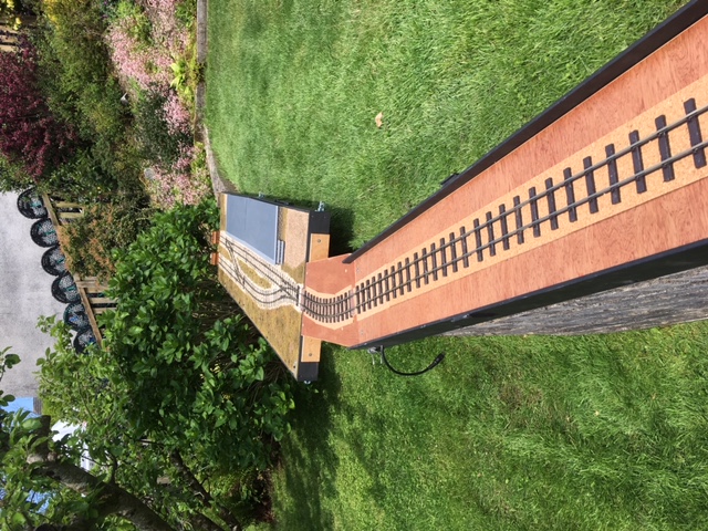

Joining the two separate ends is a simple arrangement of track fixed to 9mm ply boards. There is 16 ft of straight track with a small angle bend in the middle. These two lengths are supported by 8ft section of straight which normally form part of an O gauge portable test rack. Separate box sections with angled ends as required then bolt onto each of the sceniced parts connecting the whole together.
The whole set up amounts to about 35ft long and comes out on sunny days for play.

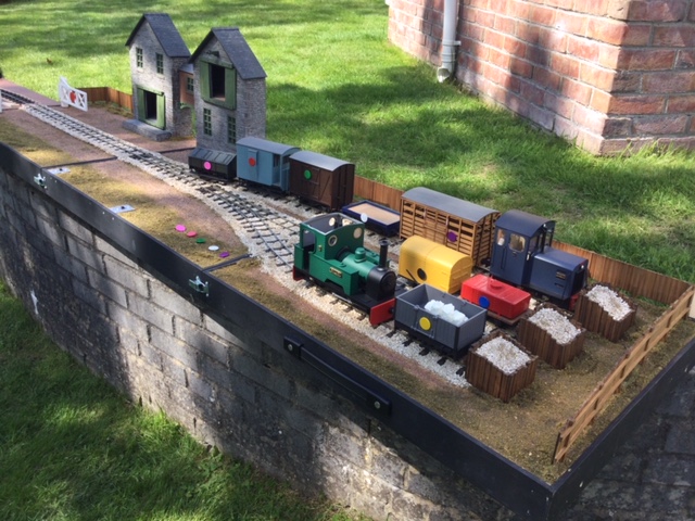

Though things here are in the wrong places it still shows something of how the shunting game works.
Glaslyn, the blue diesel has returned from a trip to the station at the other end of the line with the train which had been sorted out during the last game, it has run round the train whilst away.
On the centre board are the five counters, drawn at random from a bag, which show the target order to be achieved and matched in the five wagons behind Glaslyn. Whilst Glaslyn was away, Skylark (not quite finished) came from the station and is now trapped. Three wagons which were not selected are placed in the front sidings. The coloured discs are magnetically attached to the wagons which each have magnets inside the body for the purpose. The colours are deliberately varied for interest amongst the younger participants, who do not seem to be confused when one talks of the colour of the wagon in terms of its attached disc rather than body.
There are 6720 possible combinations of five from eight wagons so a repeat game is highly unlikely.

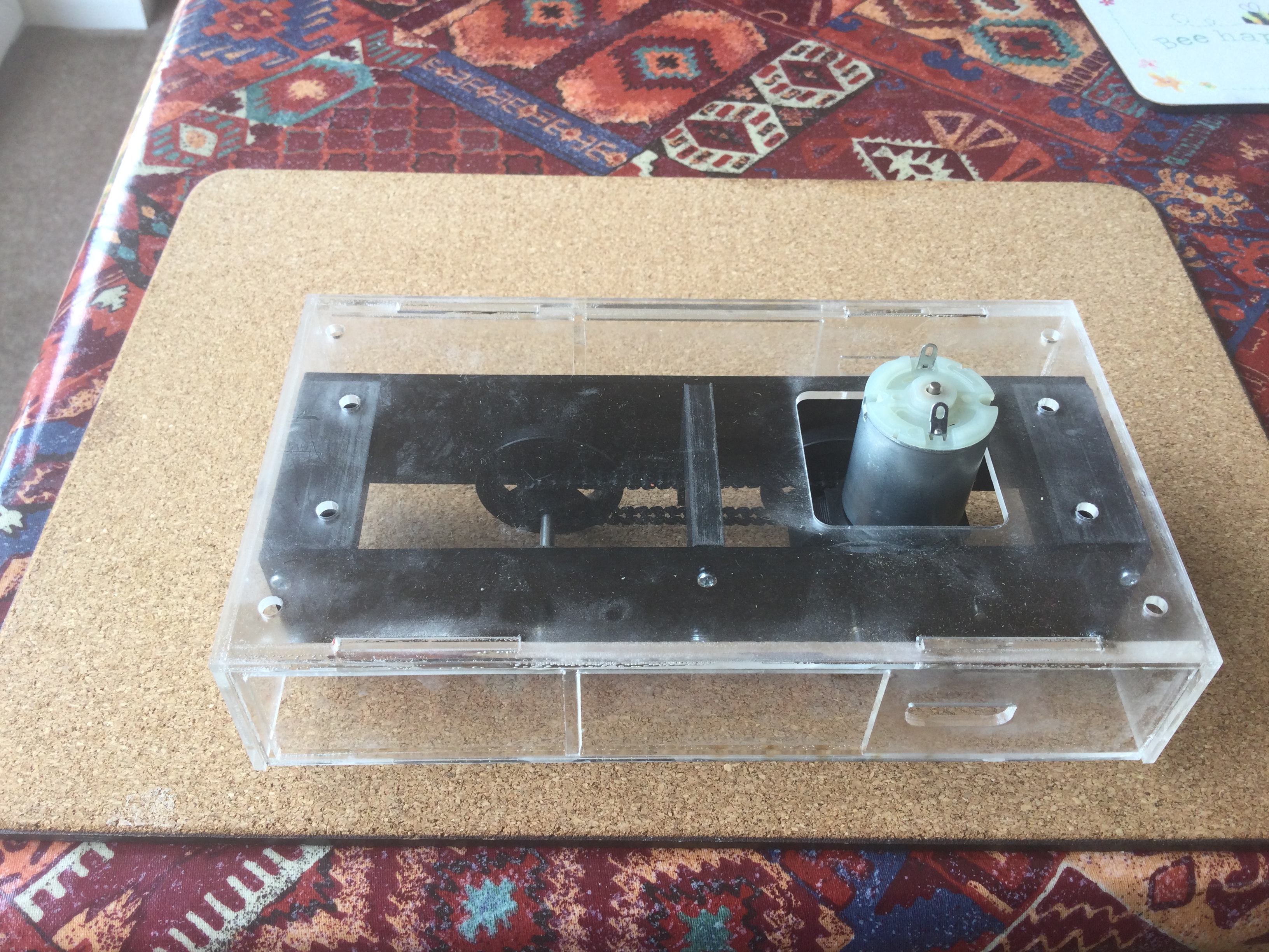

Trefor the Tram
My latest build of a PDF kit, their Arthur tram loco.

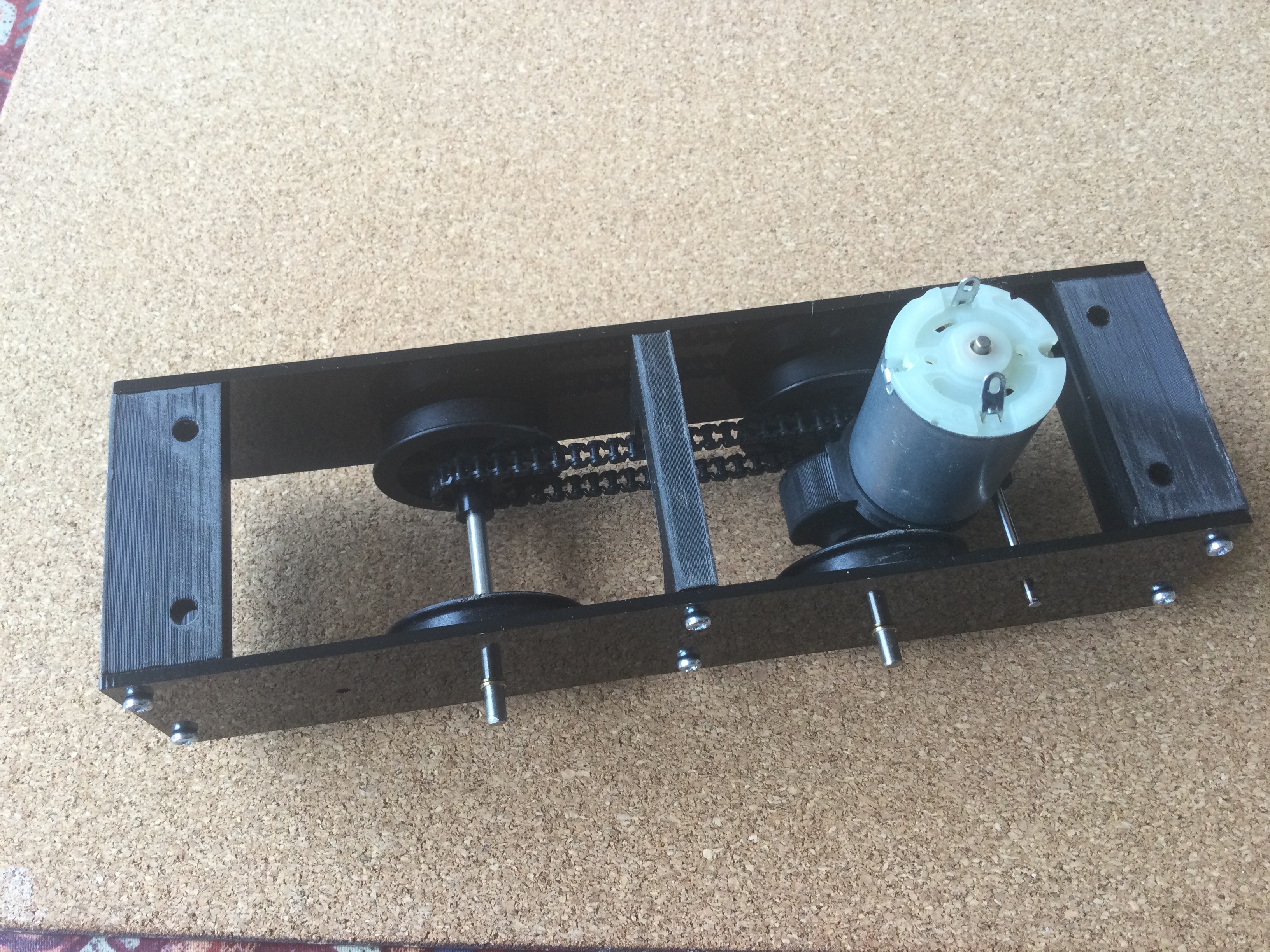

Tref chassis.JPG (2.95 MiB) Viewed 372929 times
First the chassis, a fairly simple matter of screwing together. I did manage to get one of the side pieces reversed end to end so drilled another mounting hole for the motor rod, which for some forgotten reason seemed the simplest way to go.

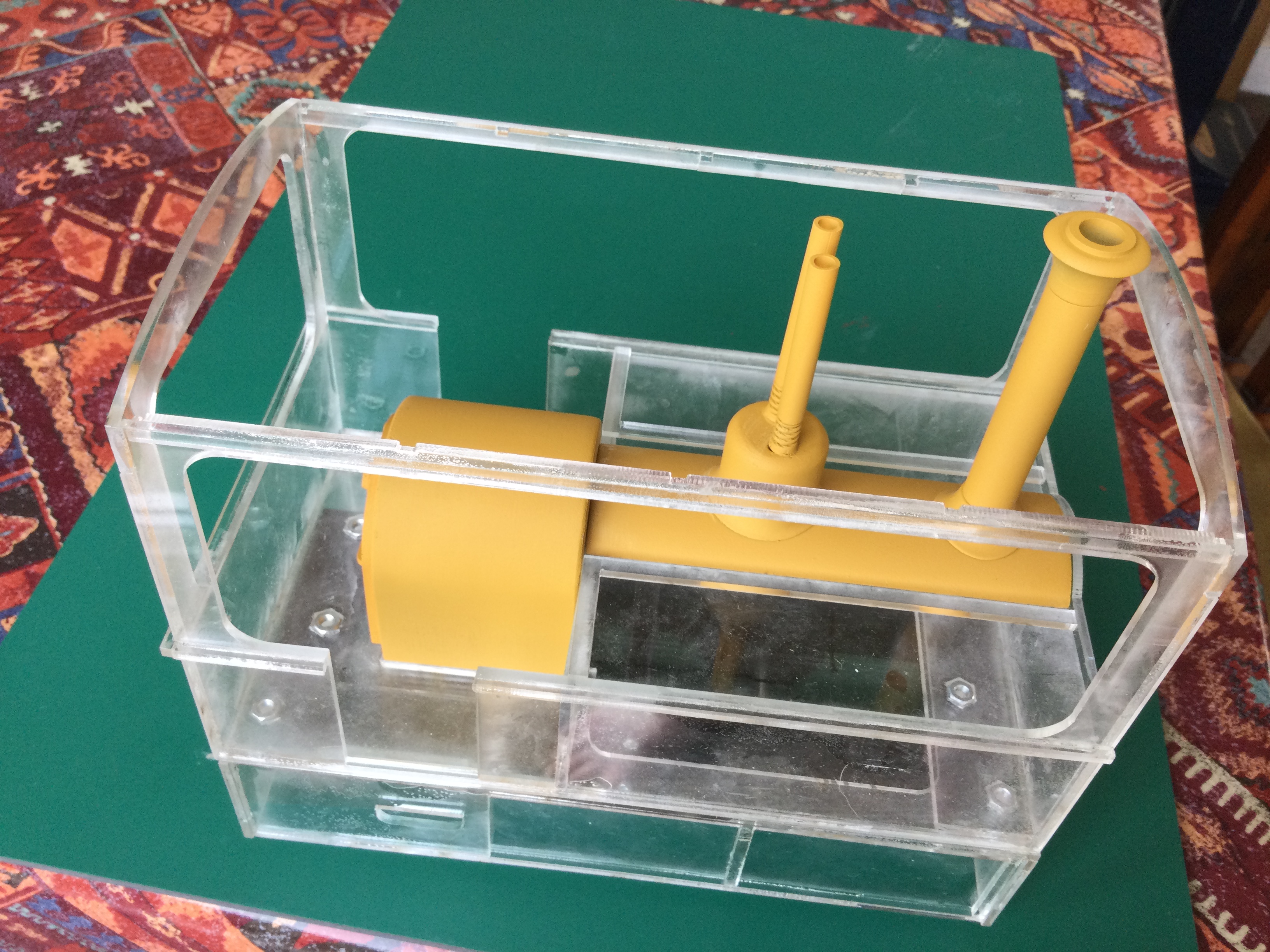

Tref skirt1.JPG (2.78 MiB) Viewed 372929 times
The skirt in transparent plastic placed atop the chassis. The instructions say the skirt should be fixed to the body, then the chassis added. This would mean complication in terms of the electrics so I added a hole into each end spacer so that the skirt would become a fixed part of the chassis. The next picture shows the heads of two m2.5 screws. Also shown are the battery pack, charger socket, thermal fuse and switch. Through the black paint can be seen words indicating that the receiver will be underneath. Temporary connections to the motor showed that it would run.

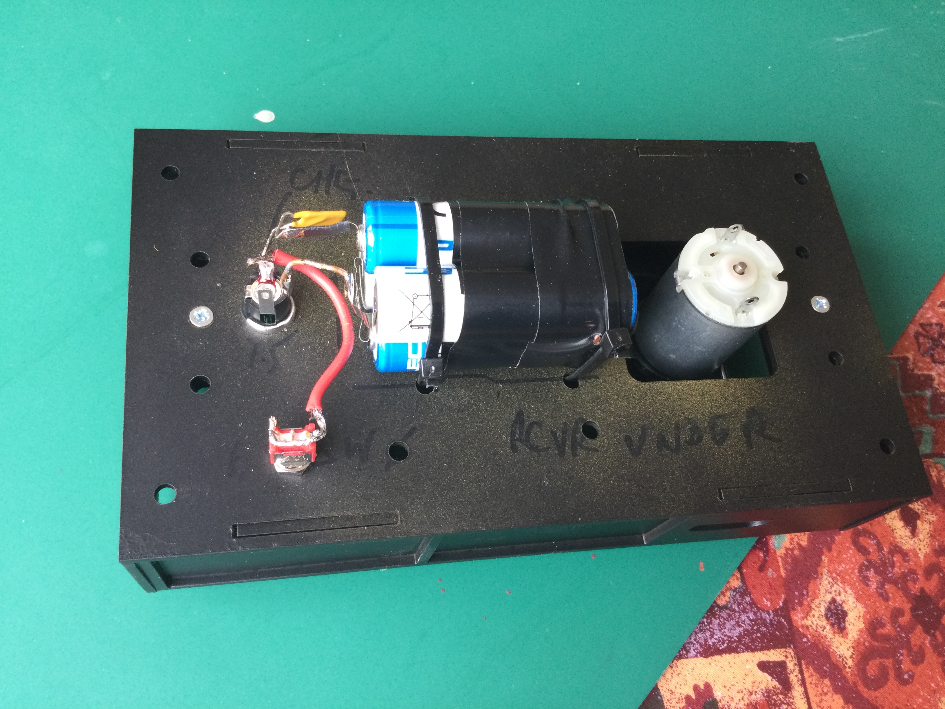

The switch is SPDT so that the loco will be on when switched to either side of centre. There will be a delay in getting the loco running under radio control as I am waiting for Micron RC to complete development of their replacement for the Deltang item I have used in my previous loco builds.

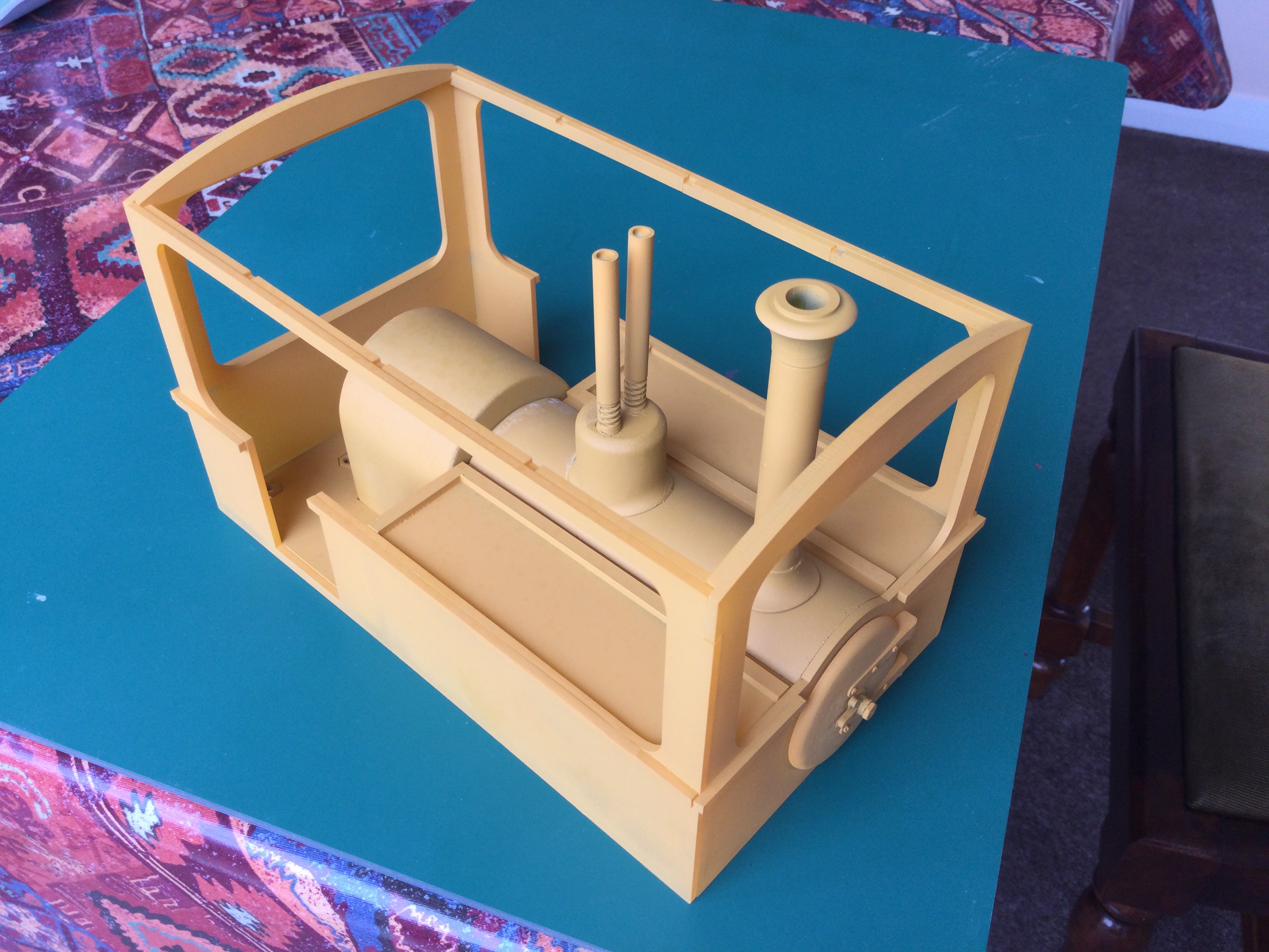

Next the body in transparent plastic with the firebox and boiler top in filler primer. These parts are 3D prints which need a fair bit of sanding to get the print ridges out.

With a coat of filler primer over the whole thing there is immediately a more solid appearance
Tref sup2.JPG (1.88 MiB) Viewed 372929 times
