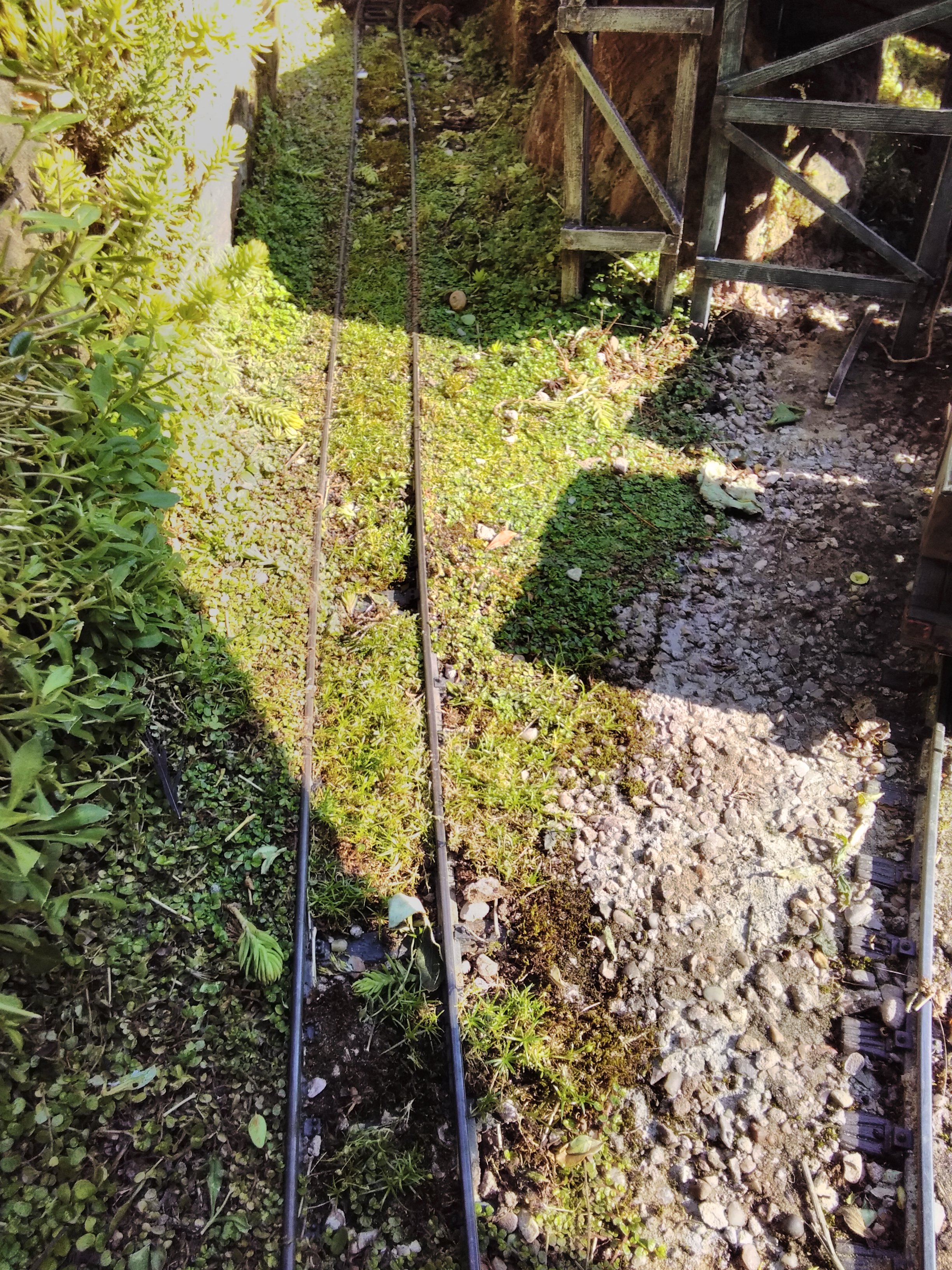

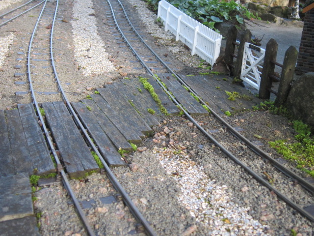

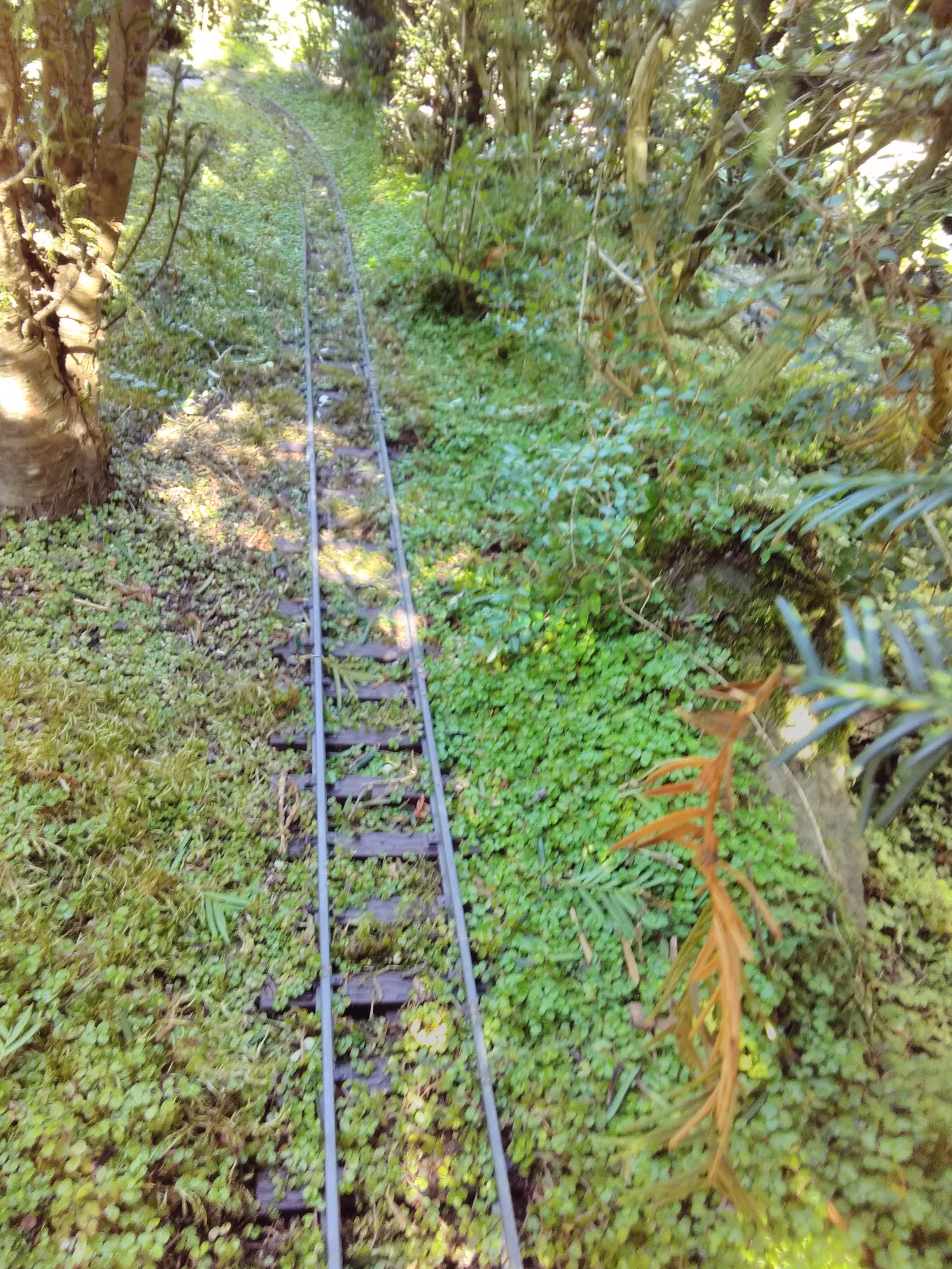

Agree with Rik, moss loves wet conditions and we have plenty here in West Wales. My ballast is fine crushed stone stuck down with SBR (available on-line) to a base of roofing felt. I do nothing to encourage it, it just appears when the conditions are right. However, even here it tends to lose colour when the summer heat dries it out.
Below are some images of lush moss growth, along with the results of the summer sun.....
