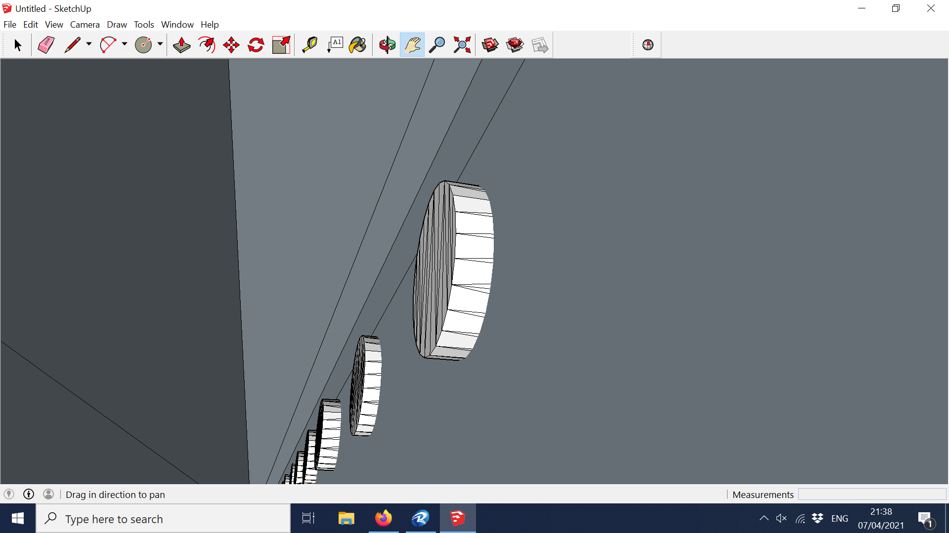

-steves- wrote: Wed Apr 07, 2021 9:16 pm I tried printing the water tank. It told me there was something wrong with the mesh in cura but I continued with it and when it printed all the rivets just fell off at touch at the base of one of the sides, like they are not attached properly.
My guess would be that the rivets are separate, i.e that the backs of the rivets are still there. I've had similar problems before myself.

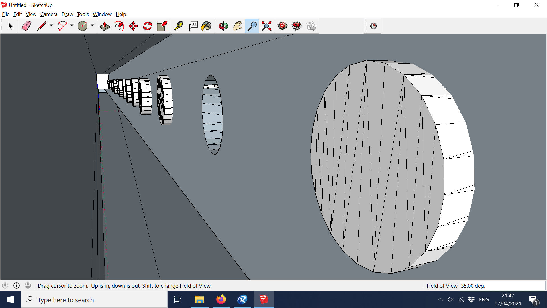

Edited to add: I think I'm correct. I've just imported the stl of one of the sides into Sketchup and then twisted round to look at the inside of the side. You can see all the rivets are still discrete items just poking through the skin, not an actual part of the solid side.
Screenshot 2021-04-07 21.38.22.png (108.38 KiB) Viewed 73216 times
Edited again because I've manually intersected one of the rivets and repaired it and you can see the difference in this next screenprint:
Screenshot 2021-04-07 21.47.33.png (116.05 KiB) Viewed 73214 times

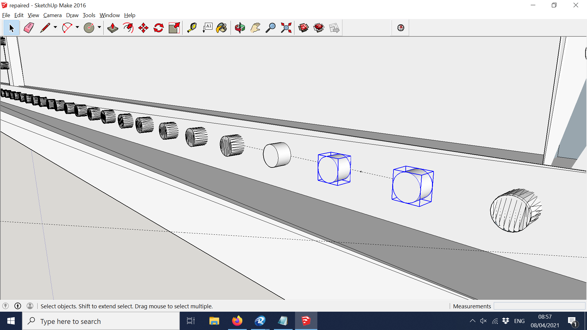

I've just taken one of your new sides and exploded it right down to the basic drawing and then removed the inside face of the tank, to see what is going on.
Then I took three of your rivets off and relkaced thrm with three that I've just drawn, keeping the same diam as yours but only 0.5 long.
On the following screen shot, you can see my three. The RH one was placed on the surface as a group and then ungrouped and as you can see it is an integral part of the skin.
The middle one is still grouped and hasn't intersected and this is how the RH one looked before I ungrouped it.
The LH one is grouped and has a back on it so it is a solid cylinder not a tube.

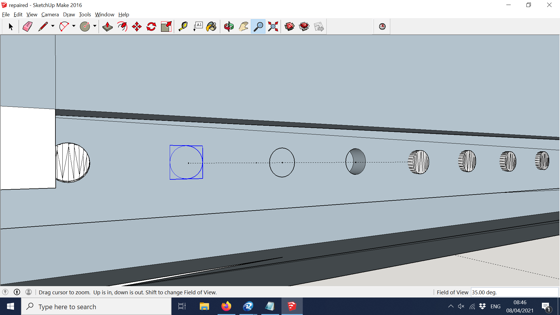

Screenshot 2021-04-08 08.46.01.png (114.66 KiB) Viewed 73207 times
The same view from the front.
Screenshot 2021-04-08 08.57.40.png (139.59 KiB) Viewed 73207 times

All of the models I have drawn which incorporate rivets have the same problems. It is really an issue about how well do I understand sketchup, and how it works. I have got away with this for this long because my printer and its dedicated slicing software can correct these things and usually prints what I expect - so for me and others with the same printers it isn't an issue. That doesn't mean I don't need to know what I'm doing - I often come up with problems getting sketchup to do what I want! I am sure there are others who would welcome the deeper understanding.
So I will go back over one of my drawings and try to sort out the rivets! If I understand correctly what I am looking for is for the inside view to show a hole - and for the outer surface of the component to show a continuous face.
I understand that the rivets need to be ungrouped - I didn't actually group them but drew one, copied and pasted it , selected both and copied and pasted them. I think I also have to intersect the faces in the component itself. Can I have the rivets as components and the frame as a component and successfully intersect the faces - that surely must work? I will follow your instructions later and see how I get on!

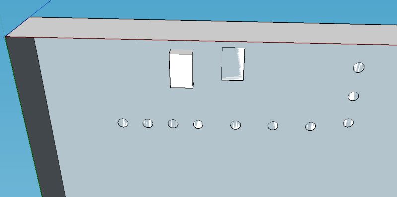

This may get a bit long, so bare with me!
How to create equally spaced multiple copies of an object such as a rivet in Sketchup.
Note for illustration I've created a small block and deleted the back face to enable a view from the inside:
1) Draw a circle of the required diameter ( these are 0.5mm radius - 1mm diameter ). The picture shows the circle is visible from both outside and inside.
2) Extrude it to required depth ( I've used 0.5mm extrusion). This picture shows it is extruded above the surface and from the inside is a hollow cylinder that is part of the 'skin' of the base block.
3)'Select' the rivet, then copy and paste, then make the copy into a group.
4) Copy the group and do Ctrl V to paste it onto the surface of the block twice.
5) This picture shows, from the inside, that both are on the surface but have NOT properly joined it.
6) Explode one of the groups. From the inside it will still look the same except the blue square bounding box has disappeared. The circular base lines will look thick, so zoom in until you can see the individual segment lines of the 'circle', then use the pencil tool to draw over one of the segment lines, click at the end of the segment and the whole circle will change to thin lines.
7) Click in the centre of the circle and it will go mottled, then RIGHT click and select 'erase', or simply hit your delete key, and the circle infill will disappear and the hollow rivet will become visible.
This routine is handy if you need to do any corrections subsequently or add an odd one for some reason, but it would obviously be a real pain to cover a long length of tank side with rivets this way! Fortunately there is a much easier way to do that, although it does take a bit of getting used to!
OK.... go back to (2), i.e you have a hollow rivet on the surface, with no back face.
8 ) Draw or place a rivet where you want the line of them to start. Then draw a guide line in the direction you want the rivets to run.
9) Select the start rivet so that it is shown in blue, then select the 'Move' tool ( 4 arrows) and then IMMEDIATELY hit the Ctrl button. You should see a small ' + ' appear at the bottom corner of the 4 arrows.( I can't show this because tools don't show in screen shots for some reason)
10 ) Click on the start rivet and slide the cursor in the direction you want to multiply it - you should see a duplicate rivet move away from the original.
Let go, then type the separation distance you want between each rivet, ( I've used 2.5) then type the number of duplicates that you want ( I've typed 4) and they magically appear. If you look inside you'll see they all are hollow and therefore part of the model.
11) It is possible to do it the other way round by typing the overall length and then the number of rivets you want followed by / instead of x i.e 50/20

I've had another look at my instructions above, just in case I've not quite written what I intended. Simplified version below:
I must say that I've never used components myself. I did try but couldn't get on with them and I find groups work perfectly well and can easily be modified or altered if required. I don't think that should make any difference in this case though, since it is multiplying/copying an entity irrespective of what it is.
I've realised that the grouping/ component issue is a slight red herring. It isn't necessary to do either to create a line of similar rivets, simply draw one and duplicate it.
I normally draw a hemispherical rivet which needs to be done at say 10 times to get SU to be able to work with it and then reduce it to whatever size I want and import that into the drawing. To be on the safe side I group it for the import and then park the original and copy the group, but it isn't actually necessary. So my apologies if I've confused things.
1) Draw rivet
2) Highlight it ( turns blue)
3) Select "Move"
4) Hit "Ctrl" ("Command" in Mac?) and small + is added to Move icon.
5) Click and hold on 1st rivet, then drag in the desired direction - a copy appears and moves with the Move cursor.
6) Release mouse
7) Type "2.5" and hit Enter ( the copy should move to the set distance)
8 ) Type "4x" and hit Enter and it should duplicate 4 more so that you end up with a line of 6 in total.
Alternatively to fit a number of equally spaced copies between known end limits:
7) Type "10" Enter
8 ) Type type "3/" Enter, and it will fill in two equally spaced copies between the existing first and last ones i.e 3 equally spaced copies of the original.
Trevor Thompson wrote: Thu Apr 08, 2021 10:59 pm I SHOULD be able to successfully print an assembly which consists of a number of components - without having to copy and paste all the components into a single component - which is basically what you are doing.
I don't know enough about components to be sure, but I don't think there should be any problem with printing multiple components, but I think they need to be intersected to the body to work properly, if that make sense?
Edited to add: I've just had a quick play with a line of simple rivets, as my simplified instructions above.
The final one in the line, I then made into a component so that it was in a small blue outlined box, called "Component#1". I then went through the duplication procedure and it worked fine, duplicating the component and all the copies are components as well. They all have open backs and are part of the underlying structure, but the individual components can still be moved around on the surface or even taken off but still retain the open back structure. I think that is the key factor.

I've been playing this morning with a simple line of rivets and components:
1) Drew a simple block 50x25x2, took the back off and and made it into a component.
2) Drew a simple 1mm diam circle on the surface of the block component. Looking at the back, the circle shows with a sort of shimmery semi-transparent centre.
3) Extruded the circle to a 0.5mm high rivet. Still looks the same from underneath.
4) Made the rivet into a component, still looks the same but with a blue bounding box.
5) Tried to duplicate the rivet multiple times and it worked perfectly and each one is a component. Looking from underneath, they all have the shimmery face infill. I suspect that this effectively shows the boundary of the component rather than being 'real'.
So it looks as though drawing on the surface of a component works as though the component boundary isn't there, and placing one component onto another makes it join automatically. This may explain why your angles don't fall off.
As for why the rivets are a problem, I may have found the answer to that. I drew a simple rectangular block, made it component and then inserted it through the surface of the block, not on the surface. When you look from underneath it is still the complete block, it hasn't joined it. However, placing a 2nd copy (component) actually ON the surface, looks exactly the same as the rivets, with the shimmery infill.
I remember reading that slicers ignore component and group boundaries and treat the objects as though they were combined, but presumably this doesn't hold good if they are not co-planar.

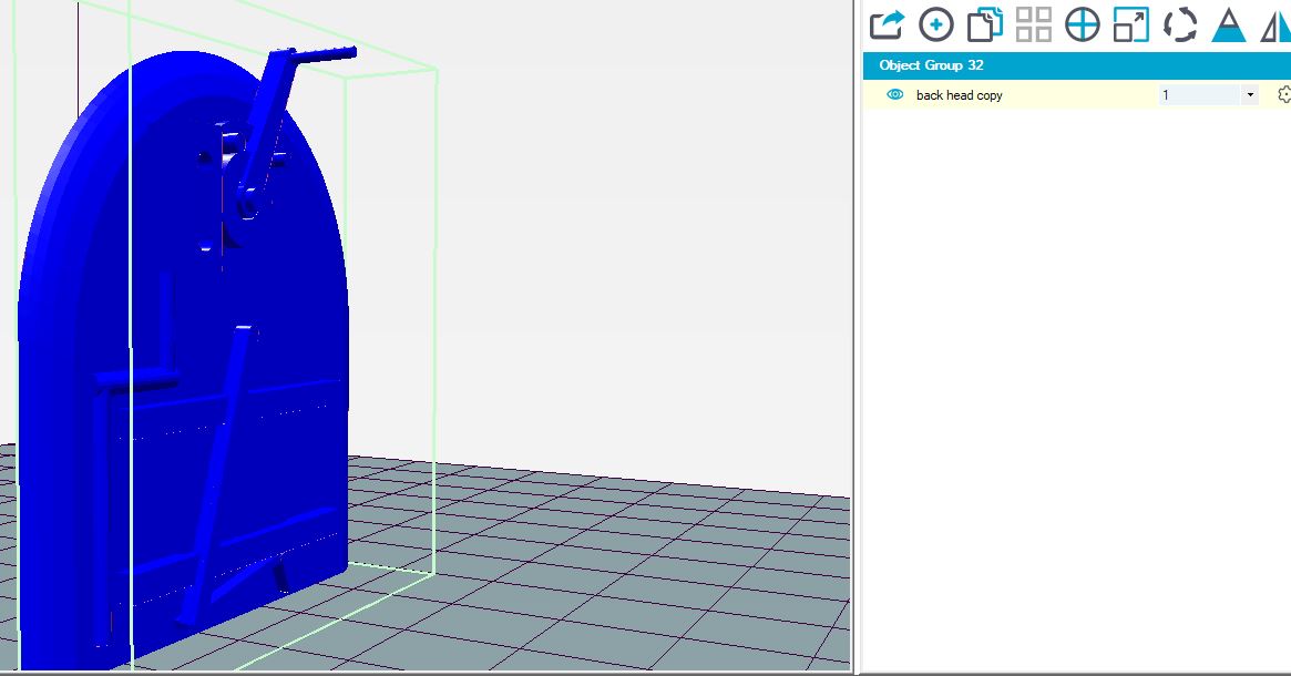

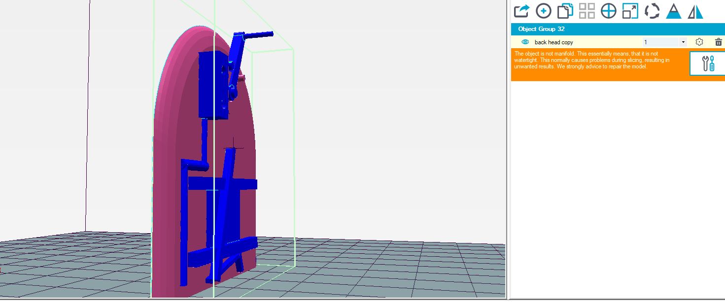

OK, time for an update from me.
There are a number of unprintable stl files in a couple of items, I wont go into it too much, but suffice to say Cura is really not happy with some of them at all and refuses to print certain parts as they are not attached. At the moment my only fix is to import them in to Repetior Host and force a fix on the stl, which most of the time it manages quite well, but sometimes just gets rid of a bit of the file, like one of the borders on a name plate, bizarre!
This is what it looks like in Repetior before and after it fixing it
