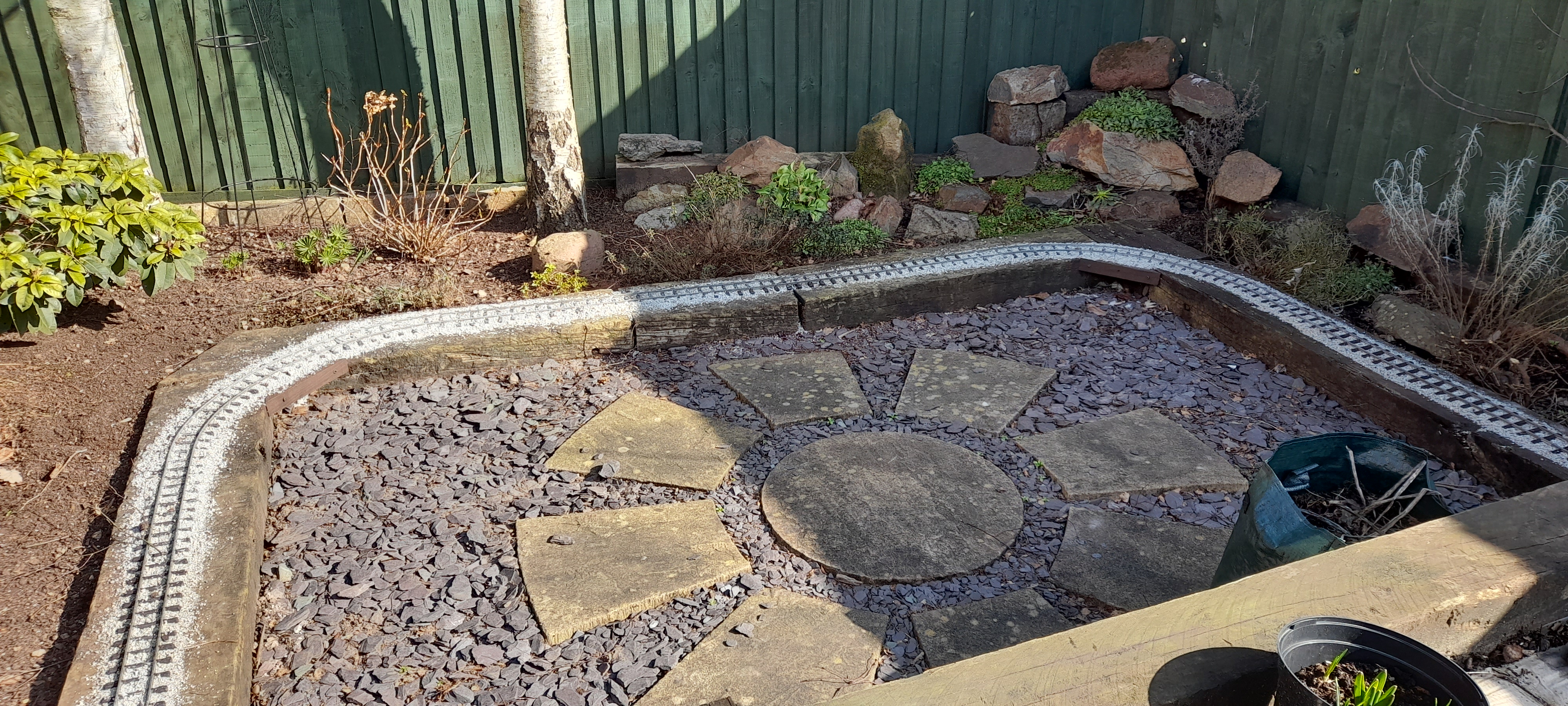

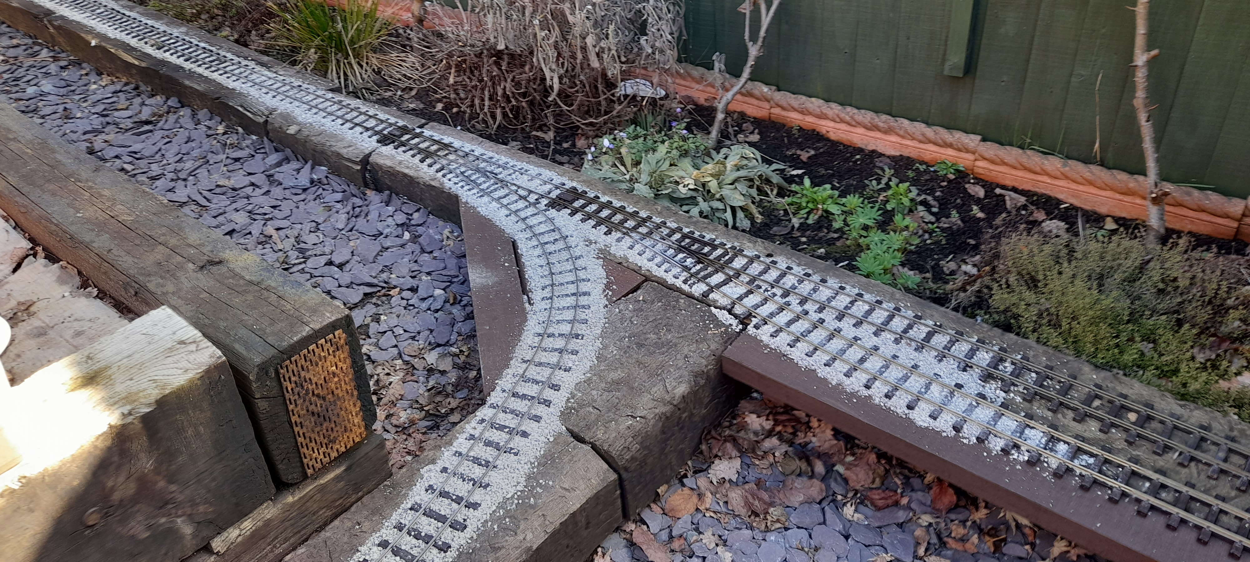

Some pictures attached of the current set up. Nothing too fancy, just a circuit of single track with a spur off to what will become a shed and loco maintenance area. I may put in a loop over the far side where I hope to put a station area. I'd also like some WR signals. I'm an N Gauge modeller so all this G Gauge stuff seems massive!

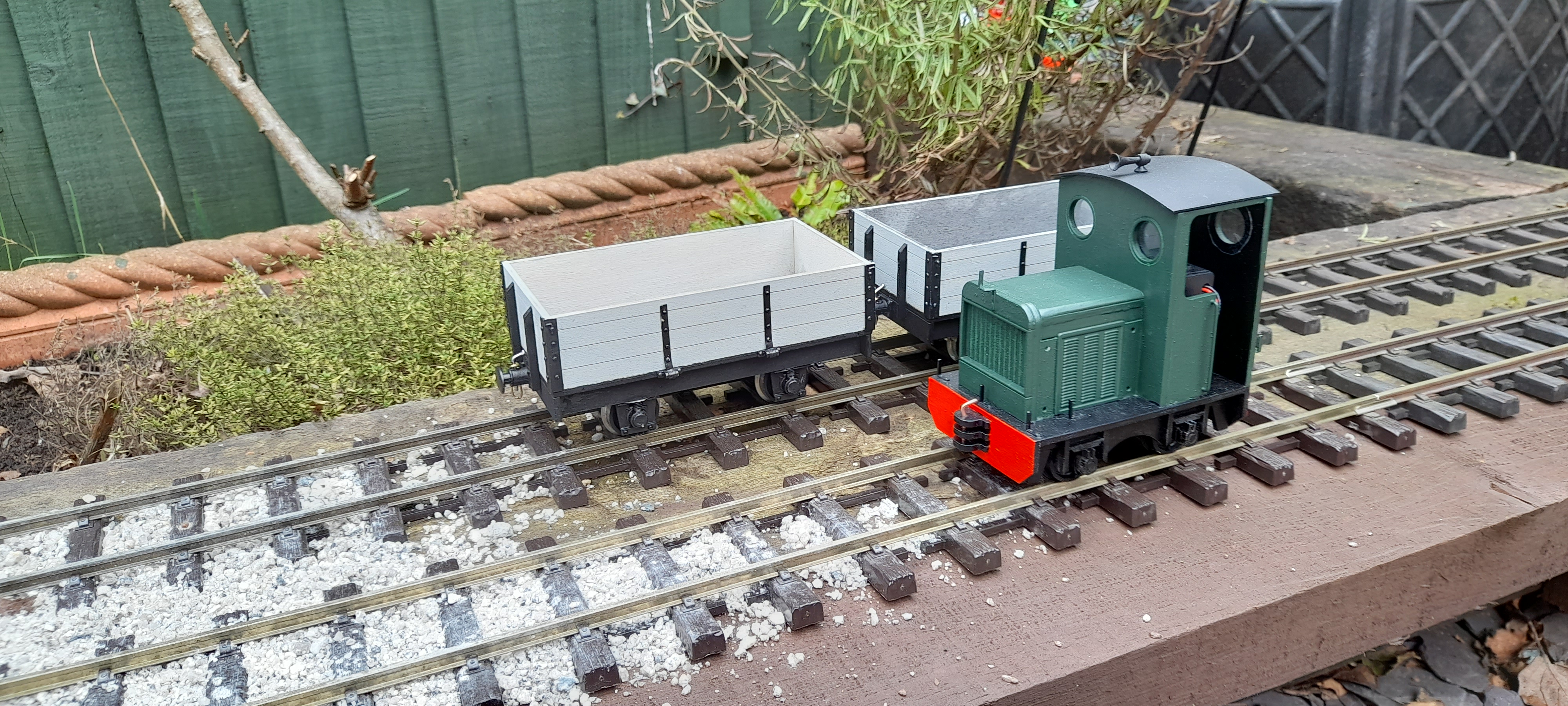

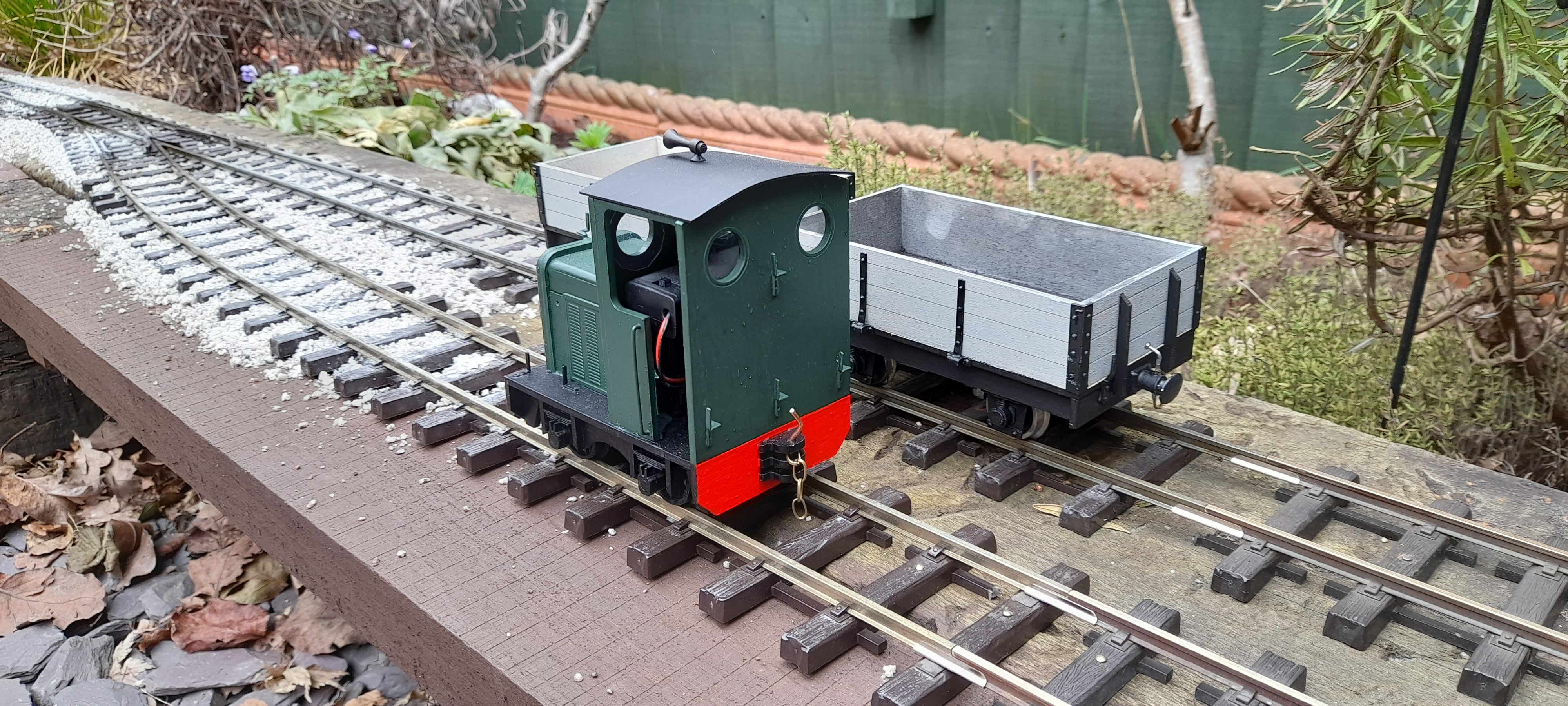

I've got a little IP Engineering battery powered shunter along with a few wagons which I got to test the track and have a play. I've got the Roundhouse Millie on order which should be arriving in May so I'm very much looking forward to that.

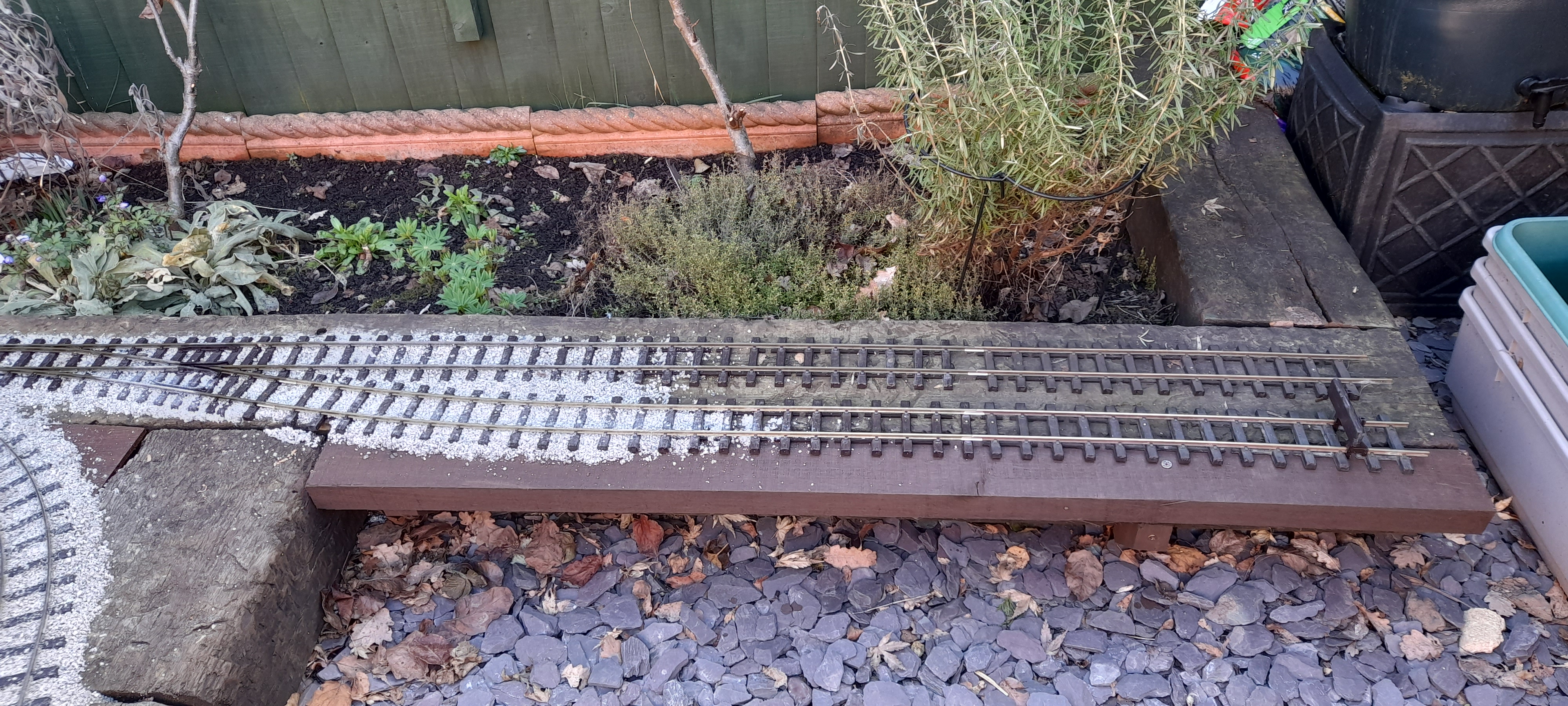

More pics

Loco and wagons in shed area which I hope to concrete over.

Just a thought, but you might want to consider increasing the clearance between the two sidings before concreting? It could just be that I'm used to the spacings for 32mm track, but I wonder whether you might have trouble if you get any wider stock?
I look forward to seeing your Millie in action on the line - it sounds like it will be one of the last to leave the factory?
Re: Point rodding and concrete track
Posted: Wed Mar 10, 2021 6:49 am
I agree with Andrew, it's looking good for starters. That little loco is a nice job.
I also agree with Andrew on your track spacing. It's difficult to be sure what you currently have, but as a rule of thumb you really need to be thinking in terms of around 150mm centre-centre, on adjoining tracks. Most rolling stock is around 80-90mm+ wide, unless you are planning on quarry/mine working.
