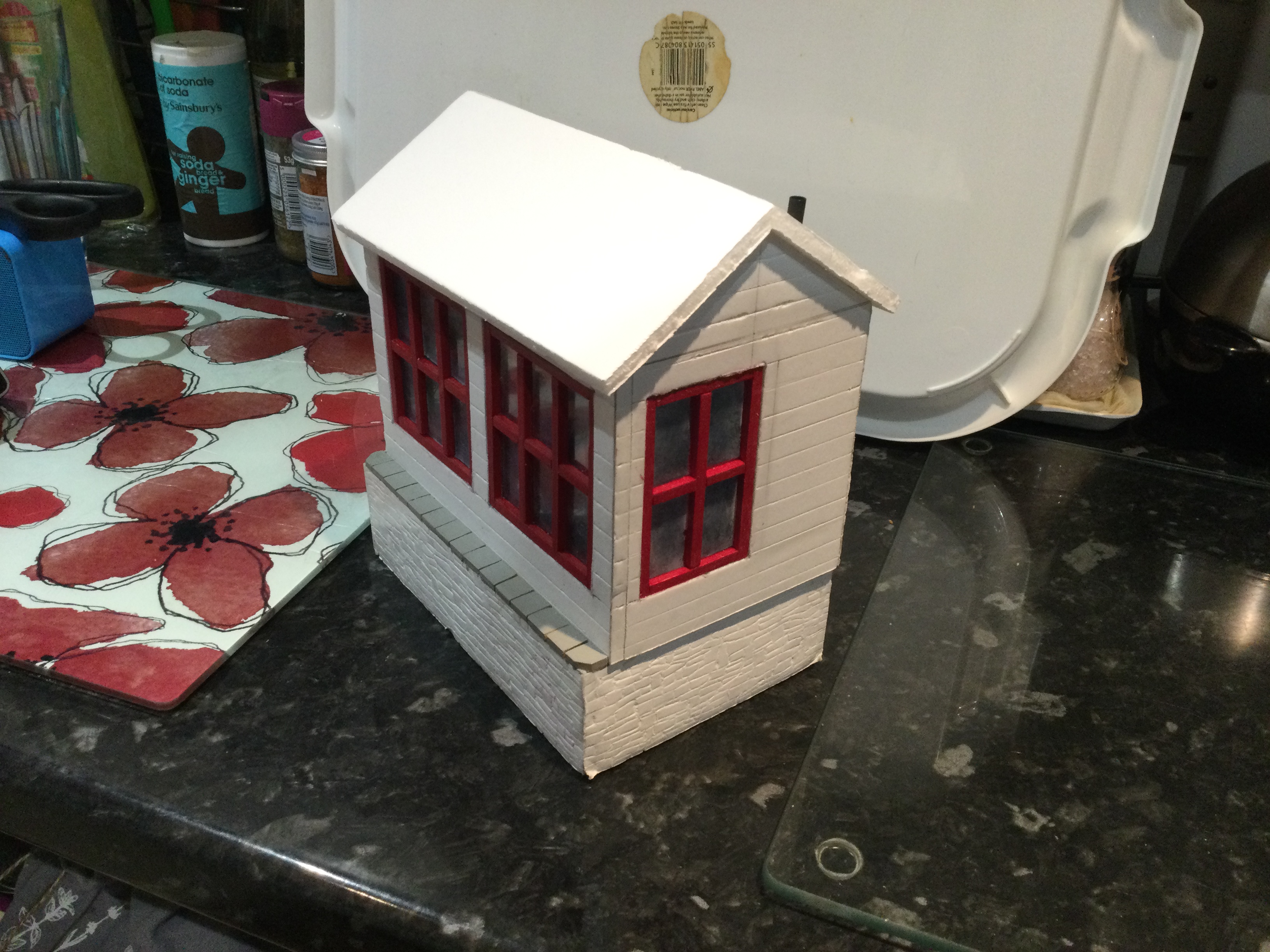

I’m currently mid way through my first attempt at a scratch build, possibly one of the slowest building projects of all time as it’s been gradually ongoing since last summer. The signal box will control the environs of my main station, and is constructed out of a combination of laminated foam-board, various strip woods, plasticards and aluminium angle (for the roofline.) The lever frame is made out of trimmed barbecue skewers and the lever frame is appropriate for the layout it controls. The token machine, notice board and clock are from Trenarren Models, the stove is a (discharged!) party popper painted black, with a length of aluminium tube affixed. Getting it neatly through the roof without snapping it off was challenging. The roof tiles are moulded plastic sheet from Jackson’s Miniatures.
I’m interested to hear suggestions of how people waterproof their outdoor buildings. I will be making a front door (with glass window so you can see inside) to keep the rain out. Is there a recommended varnish for wood and foam board for example?

That's a beauty! Certainly a lot more accomplished than any of my first efforts.
I've used ordinary acrylic paints on my buildings - even the ones which stay outside all the time - but they do fade. I've had more success with exterior house paint, but it can be a bit thick for the finer details. Not sure about varnishes though, but I'm sure there will be some on here who could advise.

Hi Seb and well done on tackling your first scratch-built structure. It looks very good and the exterior should withstand a certain amount of outside weather conditions, BUT..... if you expect to be able to leave it outside all year round I would strongly recommend you remove all organic materials completely. It isn't just rain falling on the outside which causes damage but condensation and humidity, which will form inside, causing you problems in the future. There are no sealants or varnishes available to prevent this occurring.
From my own experience I use only HIP (plasticard) for the main body and interior fittings of resin or white-metal etc, no wood anywhere!
Despite these precautions I still remove my structures indoors for the winter, but regular inspections show no deterioration of the materials I use.

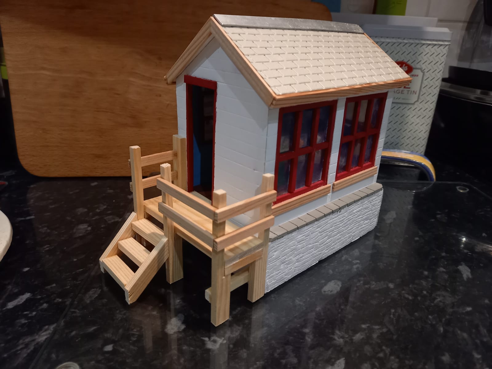

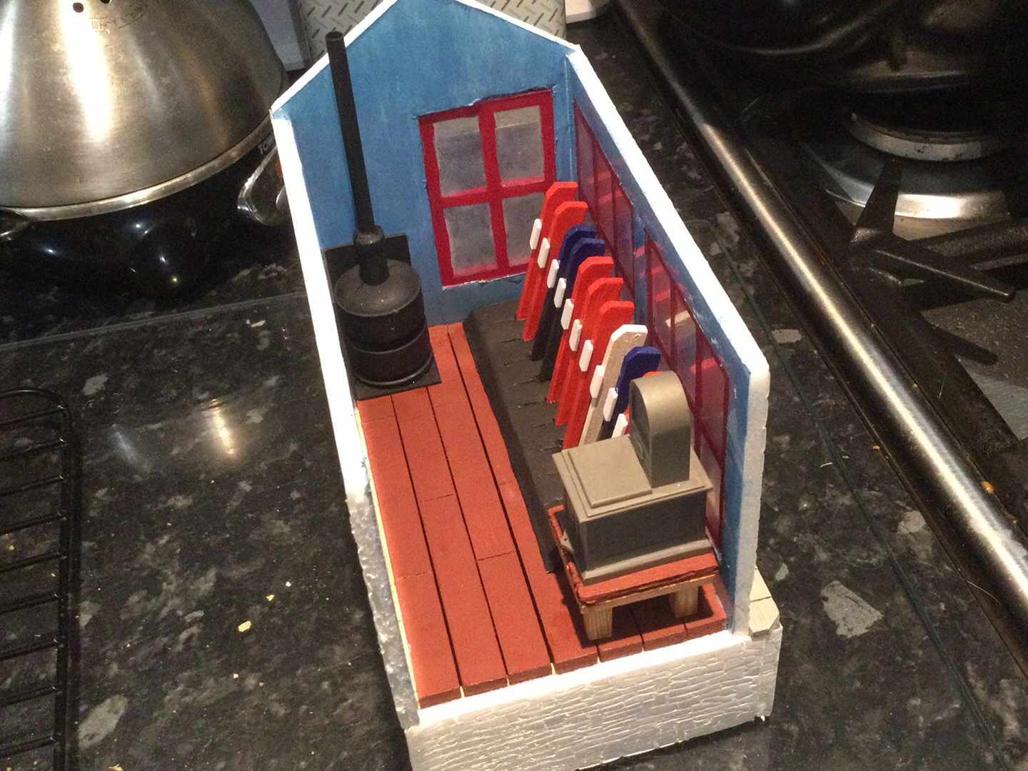

Just to round out this thread, here’s the essentially finished signal box. Everything is complete minus nameplate, and signalman (who will be standing on the veranda.) I’m also trying to source some plastic drinking straws for guttering and drainpipes.
The base is a cut piece of carbon board, available from Jewsons for little cost. It’s hard, strong and reasonably heavy and cuts nicely with a panel saw. The box is superglued down onto it for rigidity. I’m rather impressed with this material, it’s tempting to use it as the basis for a locomotive or railcar. Does anyone have experience with using it thus?
(Edit: only to use as the chassis base! Too chunky for use as sides etc.)
The box walls were pre-scored during construction to represent the planks, I painted it creamy yellow acrylic and then very gently ran a 2B pencil (super sharp) through the grooves to bring out the dirt between the timbers. Similarly the stone base was pre-scored, painted dark grey acrylic and then I used a paint on / wipe off technique to bring out the mortar, and to tonally lighten the colour of the stone, using Humbrol matt white. I’m rather pleased with the overall result.

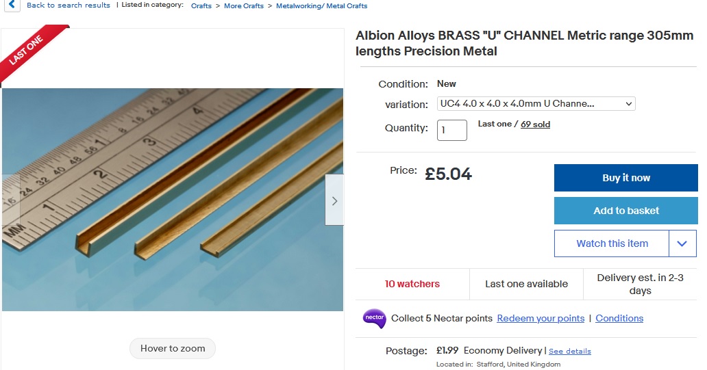

I use brass channel for my guttering. Not the expensive stuff from model shops but dead cheap stuff used by stained glass window makers for edging their glass panels. It's a heck of a lot cheaper.
https://tempsfordstainedglass.co.uk/brass-channel-5239
Re: First scratch-build - signal box
Posted: Sun Aug 15, 2021 10:29 am
A great success, particularly for a first. The brass channel is something I've not heard of before but sounds a perfect solution to me.
Posted: Sun Aug 15, 2021 1:08 pm
Peter Butler wrote: Sun Aug 15, 2021 10:29 am A great success, particularly for a first. The brass channel is something I've not heard of before but sounds a perfect solution to me.
80p a foot
metal c-channel.jpg (92.29 KiB) Viewed 99148 times
versus £5+ a foot
metal u-channel.jpg (126.35 KiB) Viewed 99150 times

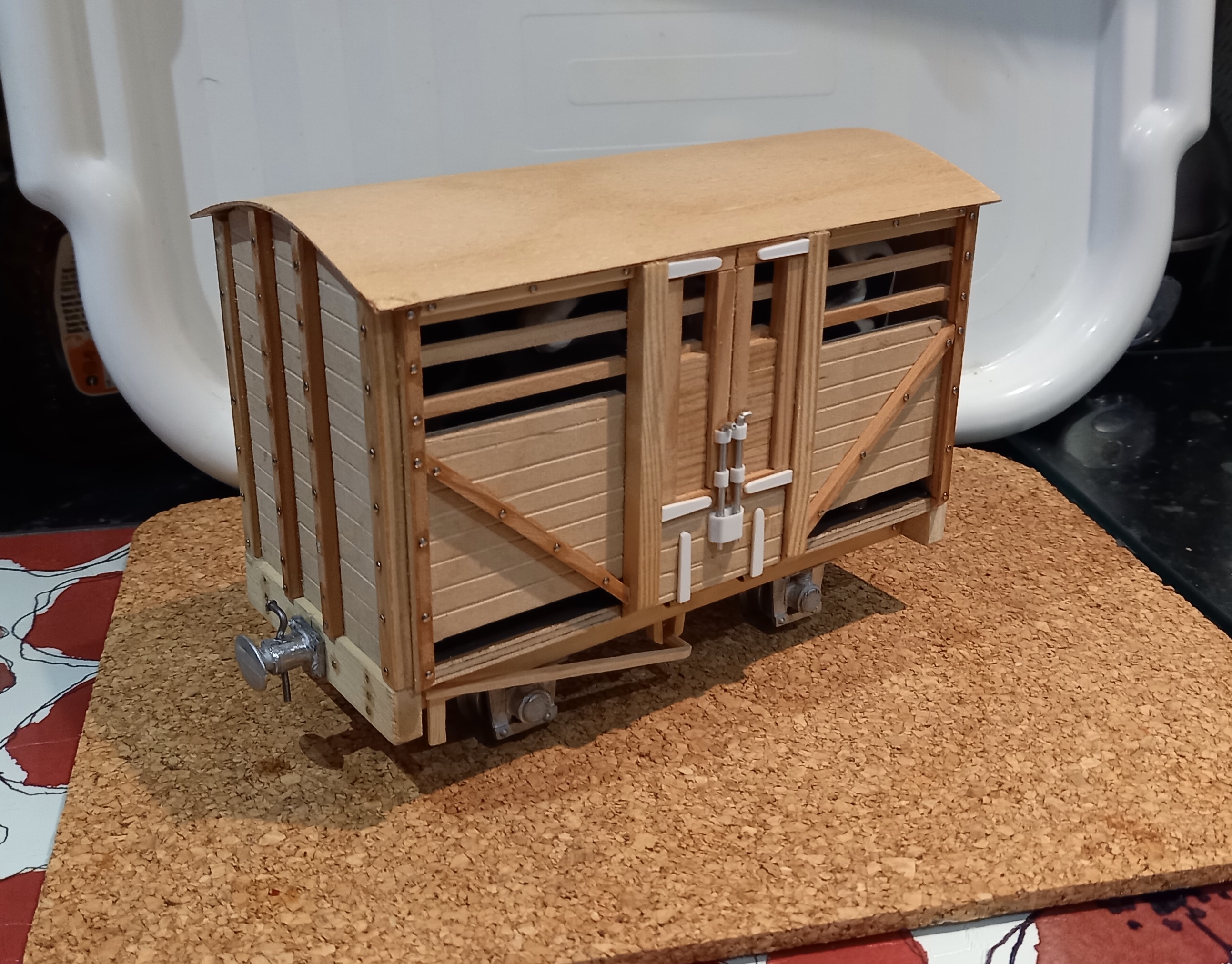

Other than painting it, I’ve today finished my ‘Christmas project’ which was to scratch build a cattle wagon. The friesian residents are a pair of 1:25 Bachmann cows, all the way from Las Vegas courtesy of eBay 8) the third one didn’t fit but it came with a plastic milking machine (complete with slightly concerning anatomically correct attachment :shock: ) so I’ll use both for scenery at a later date.
