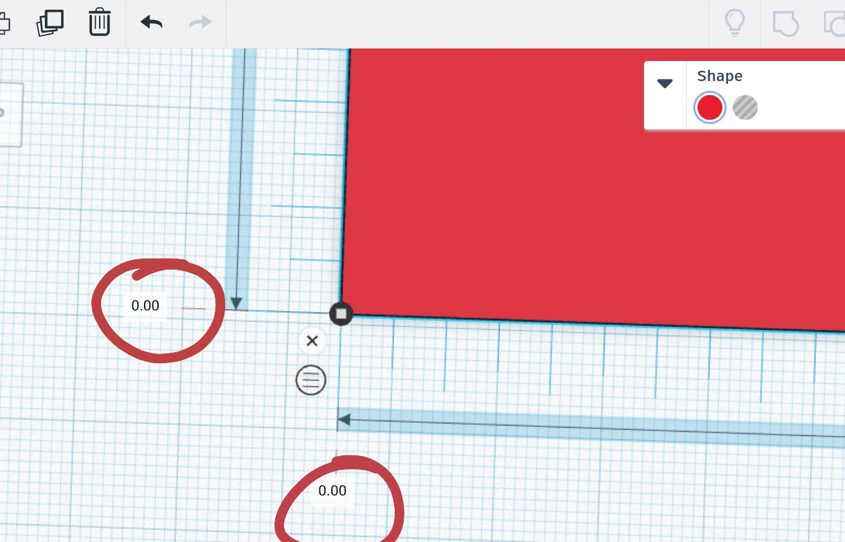

How to align a ruler with the edge or corner of a shape
Posted: Sun Jan 10, 2021 1:24 pm
1. Position the ruler roughly near the shape
2. Click on the shape to select it. It will then show two dimensions indicating how far away the shape is from the ruler
3. Click on each of the dimension boxes and change the dimension to zero
The ruler will then be positioned exactly over the corner of the shape

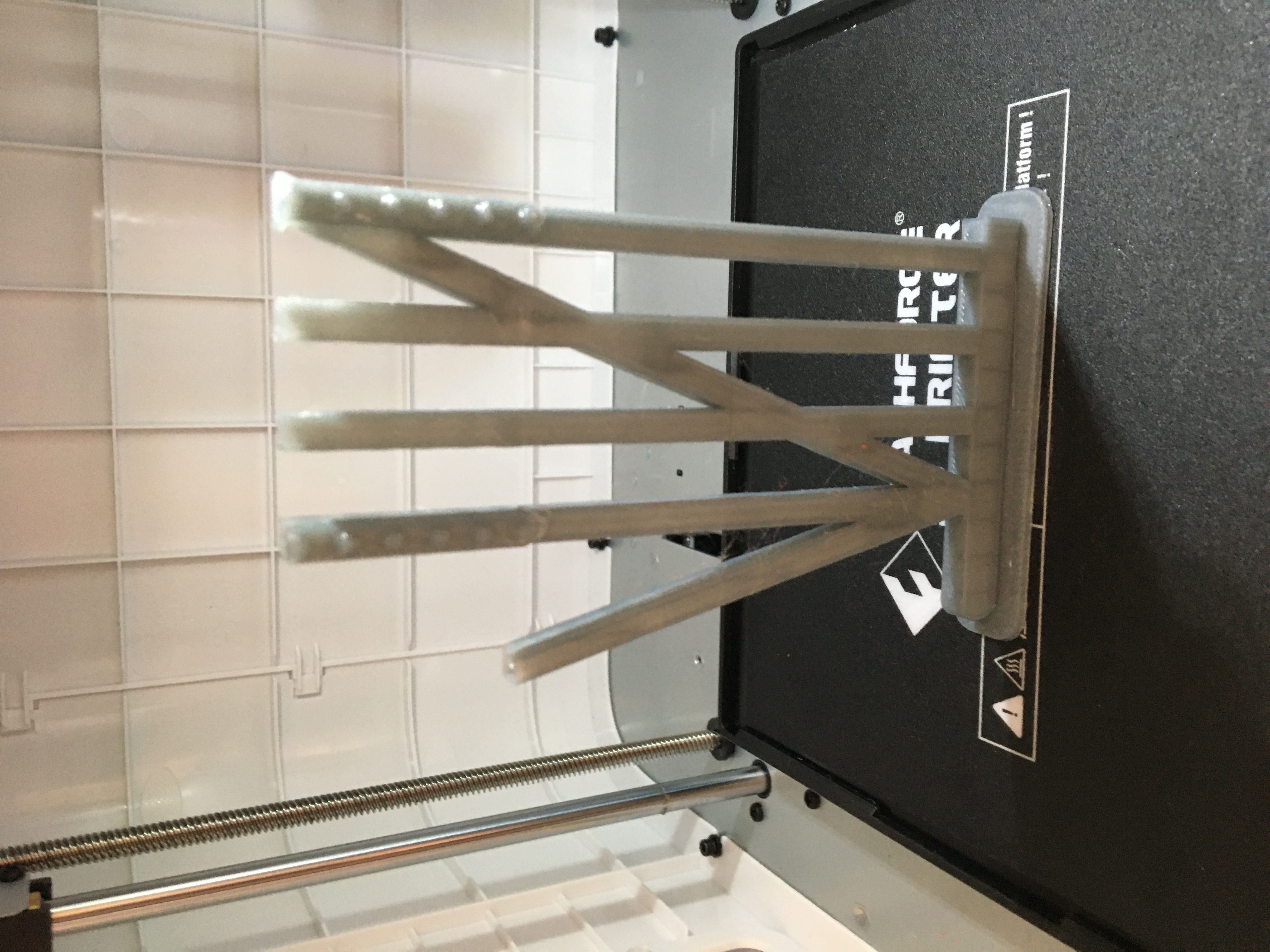

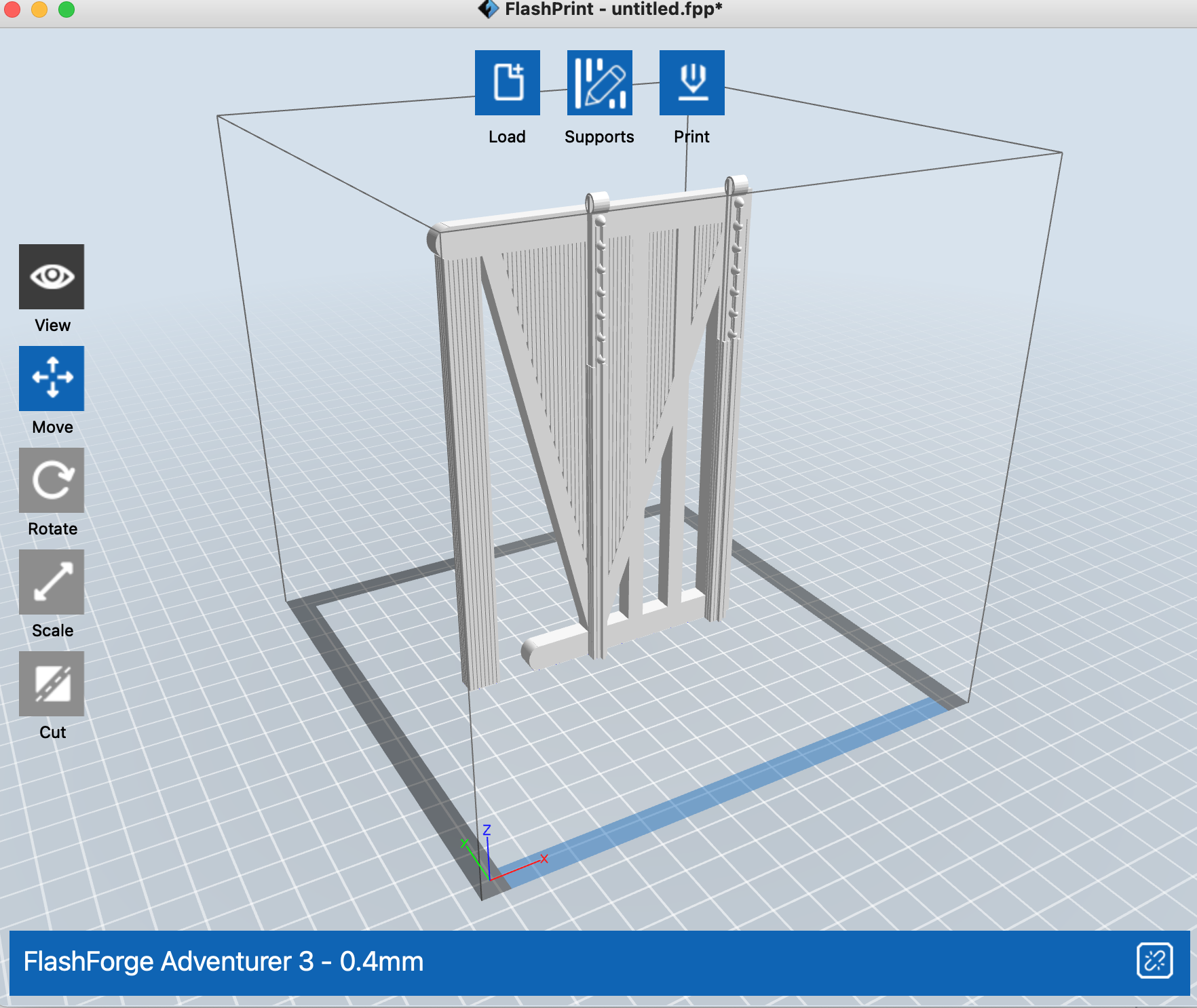

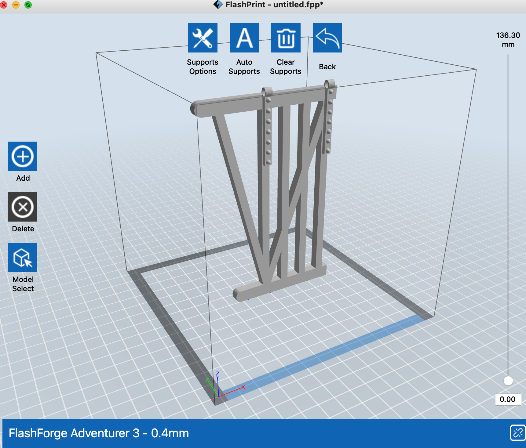

I have done an hinge for my gate, but it has turned out not that brilliant. The first attempt saw the top diagonal plank snap off. That was due to the fact that I didn't use any supports and the nozzle head hit it. Shows though that the The next one I did with supports and it did print it pretty well. Now though I have found that the hole for the gudgeon pin is pretty thin and flimsy.
How do I make the walls thicker.. :?:
I also thought it would be better if I printed it on one end
It seems I am having the same problem with loading more than two photos.
Re: Using TinkerCAD to produce drawings for 3-D Printing
Posted: Fri Jan 22, 2021 12:06 pm
by FWLR
It came out so much better with supports.
It was much better now. Shows that sometimes you do need to have supports. Though I think I would print it as is seen fitted to a gate post, it would be a lot better I think.
Yes it differently won't load more than two photos. It isn't a problem mind....
