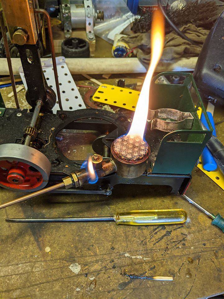

The slightly scary burner - all this would do was flashback until I sealed the leaking jet.
Improved somewhat, I believe I've got the gas set too high.

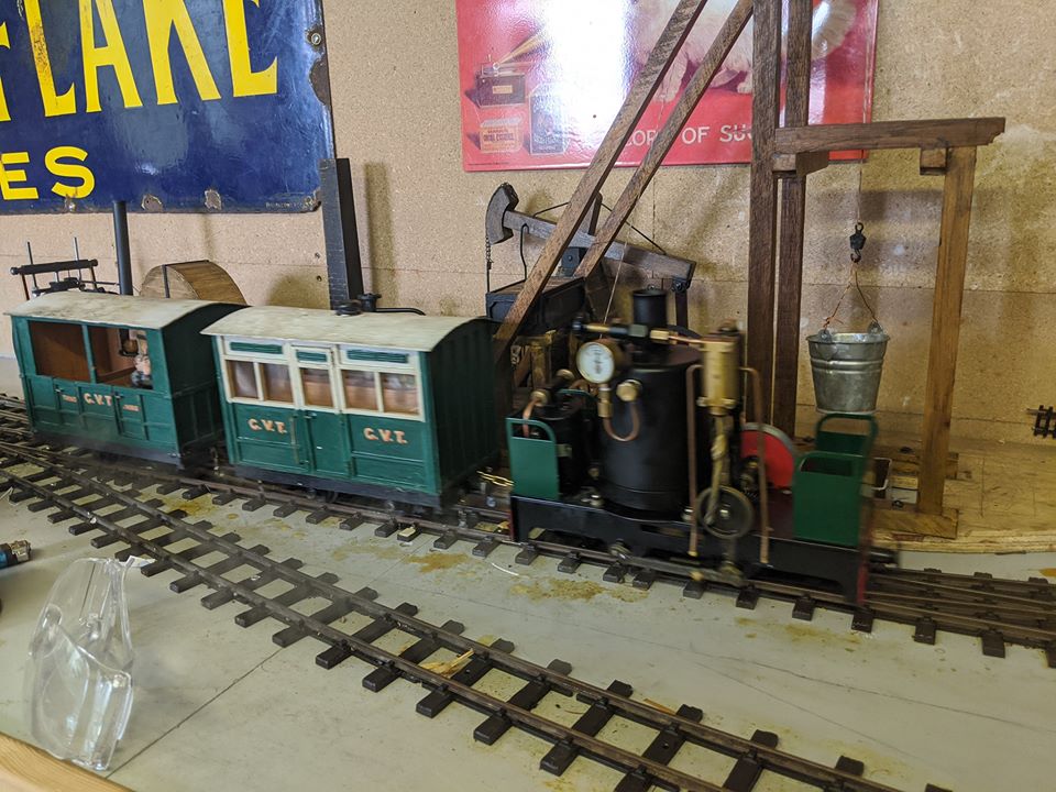

Success! Brunel happily pottered around for a good half an hour this afternoon,
Thanks to all those who gave advice!

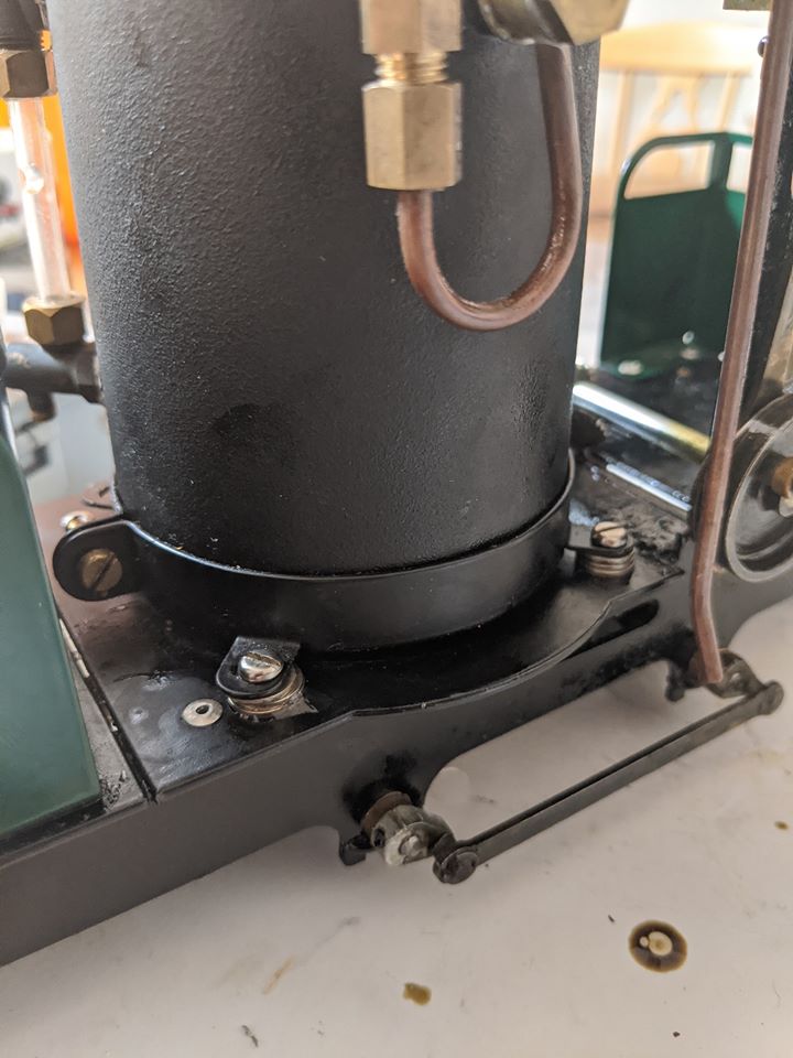

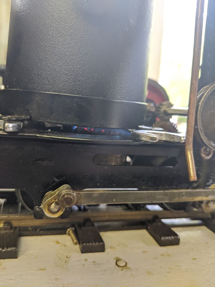

- Spacer added between burner and footplate to increase gap between burner and boiler (see arrow). This spacer was originally installed as essentially a large washer above the footplate. The lower mounting position of the burner because of this means the burner cannot be centred on the boiler correctly, but I've found the lower burner position to outweigh this.
- Boiler raised on spacers (currently just washers) to also increase gap.

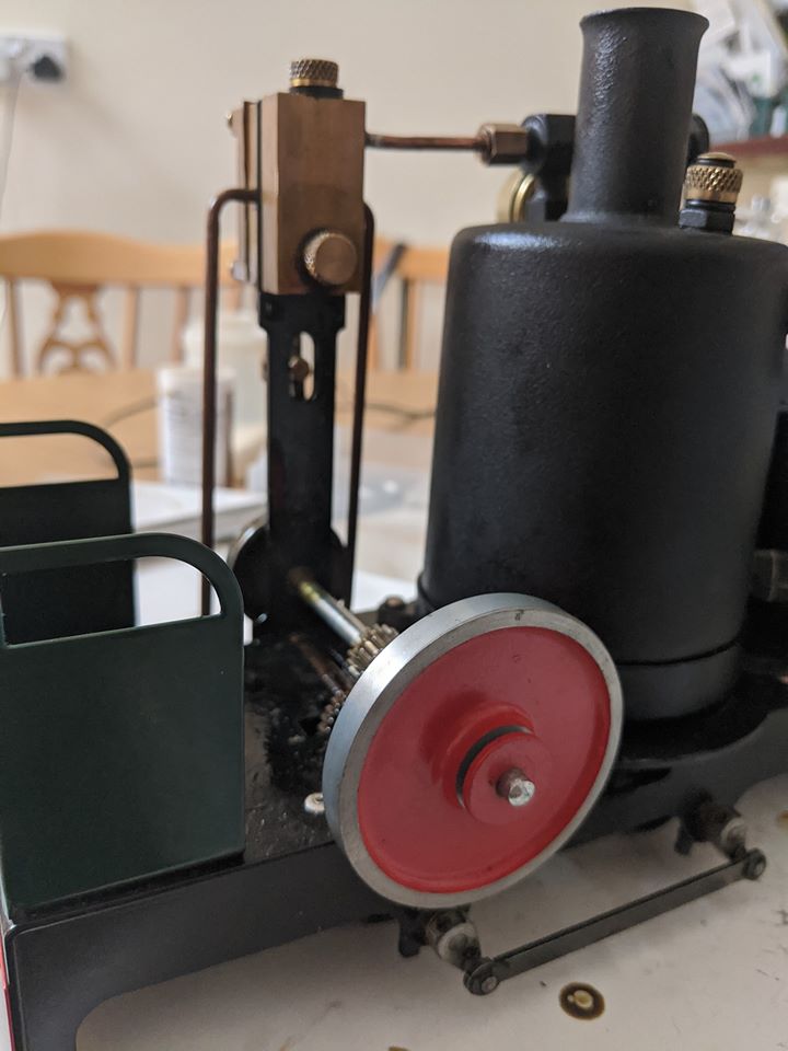

- Flywheel replaced with flywheel from Mamod steam wagon, just because I prefer the looks.
Future potential mod - Mike Wakefield's lubricator, but for the time being I'm happy!
