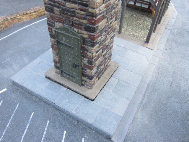

Hi,
Having an injured wrist I got a bit ahead of myself today.
https://youtu.be/NoN1l28eNvE
Take care Tony.

Nice to see how someone else does it. What glue do you use?
Re: The use of slate in scenery.
Posted: Thu Jan 07, 2021 2:02 pm
Glue?.... from my experience I have learned both what glue to use and what not to use! My early attempts using silicone was fast and made a firm structure.....
Unfortunately water managed to creep into the joints and delaminate the slate.... fail!... If the structure is hollow it can be filled with cement.... success!
The silicone method would work for an indoor layout I'm sure.
If the base material is firm and stable, the method I use is a powdered, waterproof tile cement mixed with SBR bonding agent (not water)..... similar to Tony's....
This adhesive has now held firm through 3 winters when laid on a concrete foundation. I use the same method for platform edging too.

I have tried silicone before and found it fails in time also
Lately i seem to be having good luck with gripfil of all things...
