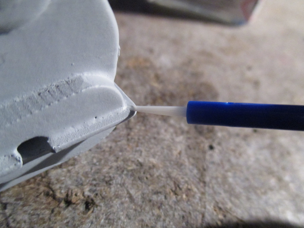

I hadn't used these "MENG" bolt heads in years. Very nicely moulded, but a sh*t to apply. In hindsight, using tweezers and a fine-tipped glue applicator wasn't the right way to use these.
This time, I thought I'd try solvent weld - and what a difference that made. A small drop was applied to the gearbox.
Whilst the brush was still wet, it could be touched against a bolt head to pick it up, then placed into the puddle of solvent and dissolved filler-primer on the gearbox. The head then sticks into the puddle, and the brush can be withdrawn.
Letting it dry for a minute, followed by a light re-application of solvent to where head and gearbox meet, helps them stay stuck together.

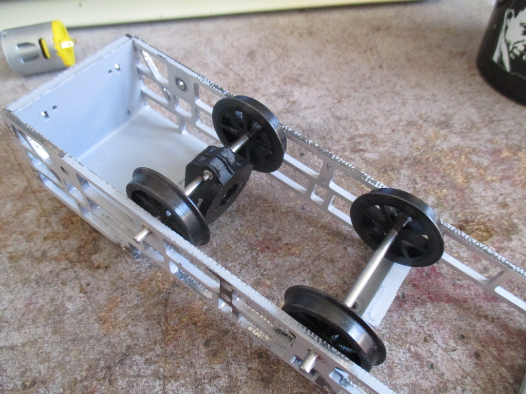

The countersunk M2 screws arrived surprisingly quickly, allowing the chassis to go together. Emery boards were quite good for finishing the visible surfaces of the frame stretchers.
Whilst the front axle was a nice, free-spinning fit in it's bearings, the rear was quite stiff. Checking the assembly revealed nothing untoward, so I opted to simply bed the axle into place. A little light oil applied with a flat blade screwdriver, and twenty minutes with a cordless drill, had the axle running as smoothly as it's counterpart. I'll have to remember to de-grease around the axle with cotton buds and alcohol, before painting..

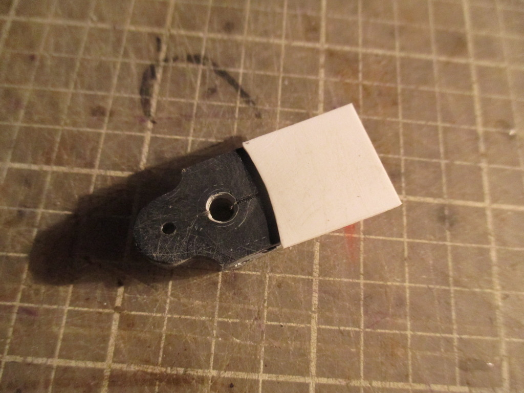

After sanding and filing the cranks, the splits in the front cranks were started with a razor saw, then opened out a little, with a triangular file. A razor blade is very good for removing the burrs left behind.
Replicating the prototype's second crank clamping bolt is a good opportunity for extra detailing. I should've started the hole closer to the center-line of the crank, but didn't want to obstruct the grub-screw hole with the dummy clamping bolt's head. The hole was drilled about ¼ through the crank, to 1½mm dia. A spare M2 screw was then screwed into the hole.
The crank was then flipped over, and the M2 screw could then be used as a guide, to align the hole on the other side of the crank. Why not just drill through in one go? Too much hassle to set up in my cheap, sloppy machine vice, which would likely have ended up holding the crank on an angle, making for a crooked hole. I'll get to cutting and fitting the dummy clamping bolts later.

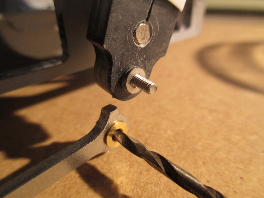

The crankpins were reinforced with superglue - I'd have preferred threadlock, but I don't believe that works with plastic threads. We'll see how it holds up..
Be gentle when screwing the crankpins home; the thread in the crank is easy to strip. The crank was then temporarily fitted to a spare ⅛" axle, to check by eye, weather the crankpin was parallel to the axle. None of mine needed adjustments.

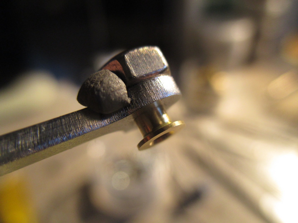

As the bushes are longer than the rods' width, an M4 nut was blu-tacked over the bush hole as a spacer, prior to applying retainer and pressing home.

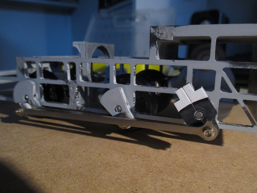

The connecting rod was fouling on the front wheelset's crankpins, so a pair of M2 washers were fitted to the jackshaft crankpins, as spacers. I couldn't even fit the rods without drilling out all of their bushes to 2.2mm - that's a fair chunk of slop, in my book. Wasn't my first choice, but I couldn't find any issue with the assembly thus far.
With the motor still disconnected, the quartering was done. The "set square and shims" method was a farce, so I ended up using the "twist, tighten, check for binds, twist, tighten, check for binds, etc." trial-and-error method. Predictably, this took some hours over several sessions. The coupling rods were done first, and once they were no longer binding, the connecting rods were then fitted, and the jackshaft cranks quartered.

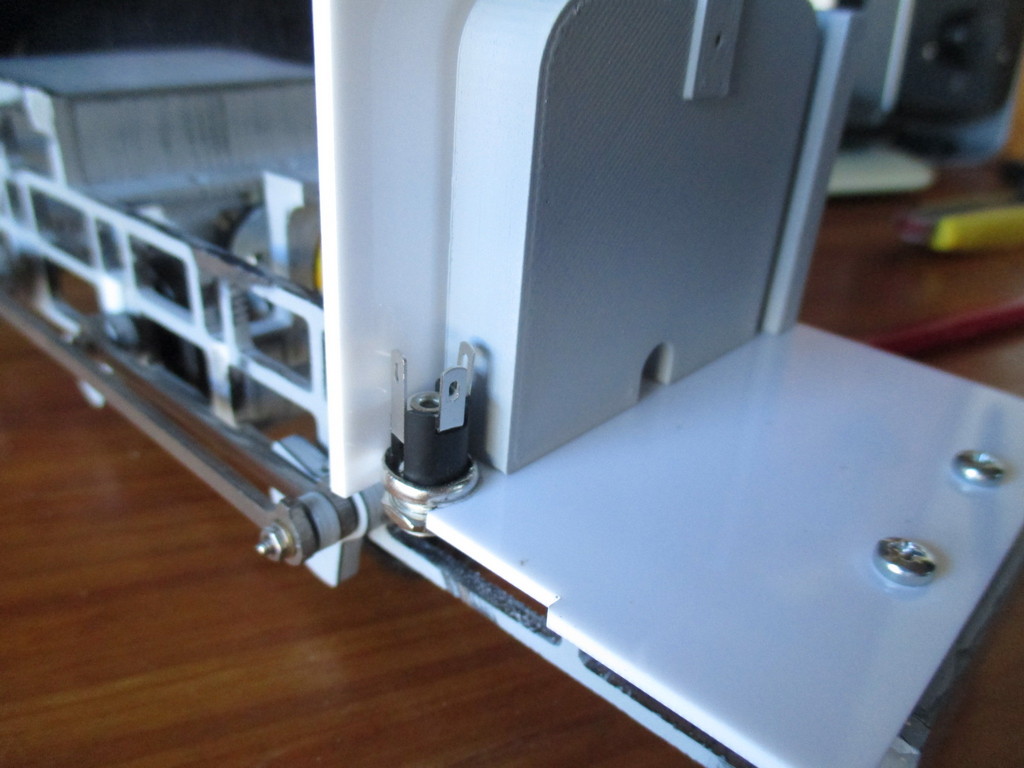

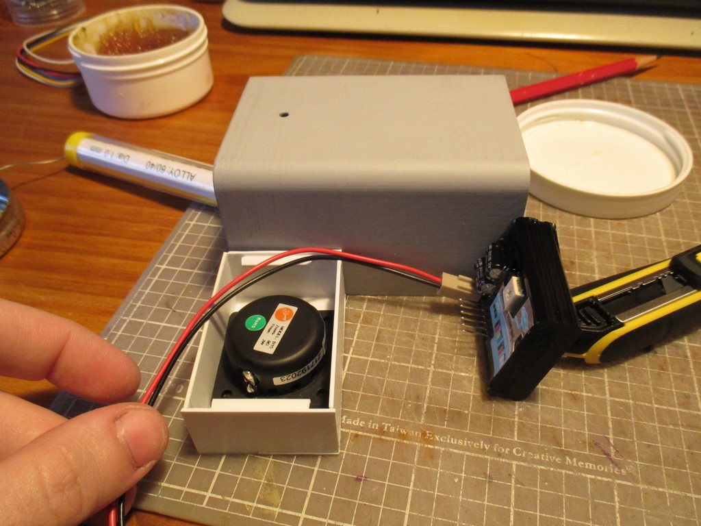

Before the speaker enclosure can be sealed, the wires of course need to be trimmed and connected. Having the bonnet behind helped determine the wire length. The speaker is a nice little unit from Jaycar. I'm looking forward to seeing how it sounds with the Mtroniks soundcard.
06/10/20

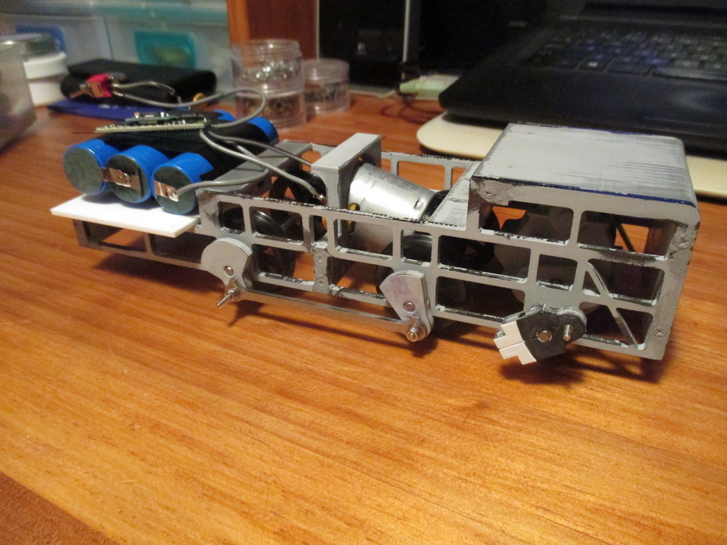

With the speaker enclosure done, a shelf was fitted within the bonnet, upon which the batteries will sit. One of these days, I'll remember to buy an assortment of large heat shrink, and stop holding my battery packs together with electrical tape..
07/10/20
As the cab and bonnet both screw to the chassis, I would like the wiring not to permanently tie these modules together. After a lot of umming-and-ahhing over wire routing, I decided to hide the charge socket within the left-side sandbox. Whilst the right-side sandbox is printed along with the driver's console, The left-side box isn't included with the kit. This suits my purposes well, as a printed sandbox would be filled with internal supports, which would've had me fabricating a hollow replacement anyway.
The U-shaped "spring-bearing-axlebox-pusher-downer-things" (You know when you have the proper name of a part at the tip of your tongue?) were represented with cut-down pieces of ¼" styrene angle. The springs were cut slightly over-length from spare M6 bolts, then filed to fit and retained with superglue. The filler over the countersunk screws in the frames was filed flat and re-applied where needed.

The headstocks were sanded and drilled to fit the couplings, assembled with M2 hex bolts and some very nice one-size-smaller nuts.
Another issue the brief test revealed was that the grub screws holding the quartering were unsurprisingly not to be trusted. I have a special hatred for grub screws, especially when they force me to half re-do the quartering again, but by hand, because the rods were retained with loctited nuts, preventing re-use of my jig.
So I did what I should've from the start - binned the grub screws and cut down some spare M2 bolts to be as un-obtrusive as possible, and use those as a compromise of appearance and retention. I doubt even I will notice these extra hex heads in operation..
At the same time, the dummy clamping bolts were added to the front cranks.

Wiring "dummied up" for another test, after fitting the connecting rods. I'll have to re-program the receiver, so that channel 5 (controlled by the "bind" button on the transmitter) can be used to toggle the engine on and off. As I've only needed the basic Deltang Tx10 transmitter so far, which can't be used for re-programming, I've just ordered a Tx22 which can be used for re-programming. That's two birds with one stone, as I would like the option of switching between multiple locos without risking damage turning 'em on and off all the time, anyway.
As I'll be running the loco at Zillmere on Saturday, I relented and oiled the motion. Will have to degrease those points with alcohol when I get to painting..

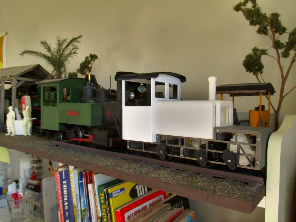

The Baldwin managed alright with the wholestick trucks at home, but it struggled and slipped very badly at Zillmere. I'll put this down to oily residue, but even so, these trucks are far heavier than they need to be. They were weighted to 270g each, to negotiate a terrible S-bend imposed by a tree on my first tramway, which is thankfully long gone. They were brought to be sold off anyway, and the planned replacement rake of thirty cane trucks, will be much lighter than these.. In any case, I'll have to discreetly pack some lead into the loco.
The cab was mocked-up with Blu-Tac, and a cutting disk in the dremel was used to cut a hole in the front panel, to allow the temporary wiring to pass into the cab. Whilst I'll keep the roof, the walls will be replaced with something fabricated from angle and sheet as-per the prototype.

I also realised that smearing Squadron putty over the Phillips screws holding the frames together, was a bad idea, and replaced them with (to my eye) less obtrusive slot screws. A skin of 0.4mm plastic was bent in hot water, and fitted over the front end of the frame.
The printed bonnet and doors were sanded down, and the doors (which had curled up years back, as the spray putty dried) were straightened after softening in boiling water. I seem to recall snapping one of the doors trying to bend it cold, so a replacement was fabricated.
I'm rather pleased that happened, little changes like that are needed to turn this WWI-era loco, into a well-used industrial machine.
This has also tipped the scales on weather I paint it early green, (20's-50's) or late yellow.. (50's-70's)
After fabricating the tiny dummy hinges, the bonnet had a few panel lines scribed.
227 rivets were marked out, drilled, countersunk and fitted with my usual favourite slivers of metal. I haven't done any modelling since early October, and had forgotten just how time-consuming these projects are - The bonnet has somehow taken 13 hours to rivet, and I still have a row over the back end to do.
