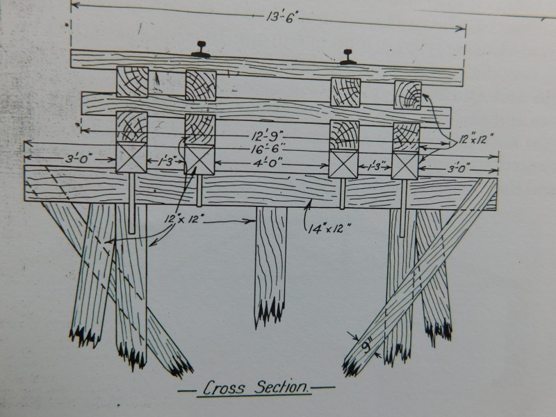

Cross section of open top trestle. From the book 'Bridges Down Under' by Don Fraser.
Sleepers definitely overhang the bearers.

Modeling is always a trade-off of accuracy vs practicality. Me - I go for practicality if it stops locos from falling to the ground. So even though handrails were not prototypical, I use them.
BTW, they aren't really 'sleepers' under the rails, but are longer and thicker timbers.

Thanks Greg
After a bit of thought and playing around I am going with a walkway at the back of the trestle, where it will be mostly out of sight and I have some justification for the handrails that I putting in to catch anything that decides to topple.
The handrails are 65mm galv nails posts with steel wire between them, similar design to what you used on your high trestle and the walkway is made from a treated pin fence paling so over time it will turn a neutral grey and blend into the background even further.
I am making the walkway 50mm wide because that is wider than the overhang on my widest loco a Bachmann 2-8-0 Consolidation and will give plenty of clearance.
Behind the trestle I will be planting a series of bushes that will hopefully break the fall of any toppling rolling stock when they grow into the space behind.
They are a tropical plant called acalypha and my neighbour has a hedge of them where I can get cuttings.
