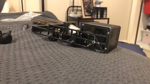

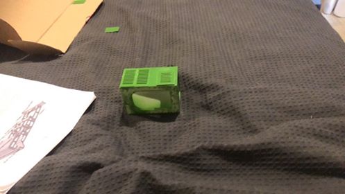

Hi folks, i may have mentioned in my CCT thread that i was getting a baldwin kit in 45mm, well it showed up a month ago and here are some photos of it.
the mostly complete chassis
mostly complete body

Hi grant, the chassis is made out of laser cut steel, the project is currently on hold waiting for new axle bushes to come and a few electrical bits too

Looks like it's progressing nicely. As a loco, the Baldwin has always interested me but, until recently, I have dismissed it as I know its chassis would be beyond my limited scratchbuilding abilities. I have been wondering how easy the PDF chassis is to build. I'll be interested in how you get on.
Re: PDF Baldwin the Build so far
Posted: Tue Feb 18, 2020 10:40 am
by Mitch stack
the chassis is pretty easy to put together, just screws and washers mainly.

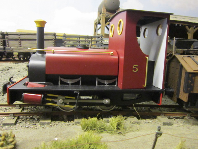

Loving to see how you get on with your Baldwin kit. It builds in to a lovely model. I bought mine at Christmas to go with a rake of slate wagons that i am also putting together. I only finished painting it at the weekend and ran it for the first time outside this morning after having run it on blocks for a total of about 5 hours over the past few weeks to 'run in' the wobbly bits. What colour scheme are you considering. I chose a maroon to go with my Roundhouse Russell. Here it is on my cluttered work bench with my unpainted wagons.
Please keep posting. I love to see what others are doing.
David.
P.S. To make mine run properly I had to enlarge the holes slightly in the coupling and connecting rods with a thin round file as they were too tight a fit on the bearings. Also make sure the rods are perfectly straight as a couple of mine had a slight bend towards the ends.

Hi David , I am painting my Baldwin Wilderness green with black frames + red buffer beams, it will be manually controlled for ease of use and should be done by the end of March hopefully.
