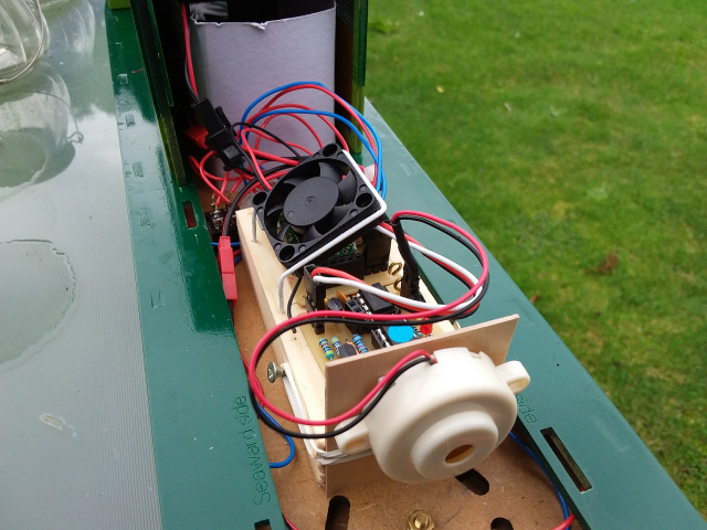

A belated update on my Vale of Ffestiniog. After returning the receiver board to Peter at Yatton there was found to be no fault with it. On re-installing it, the stopping problem was still rearing its head. I was getting near to giving up when it happened yet again during a cool day on my local society layout. (I don't have a layout of my own). After yet again opening up the loco to check connections etc. I let it run with the body totally removed and it ran for 20 minutes before i brought it to a halt. Following a hunch i replaced the body and low and behold it stopped after a couple of mintes. I quickly did a finger test and found the large ic. quite warm to the touch.
I spent the next few weeks buying and trying small fans in the engine compartment. The final configeration is with a 6v tablet computer fan wired into the main power switch held at an angle over the warm ic to blow air across it. It now runs as it should, with the last test being a couple of months ago when I let it run pulling 4 bogies coaches for an hour before I brought it to a halt.
The test configuration before final tidying up in the engine bay.
