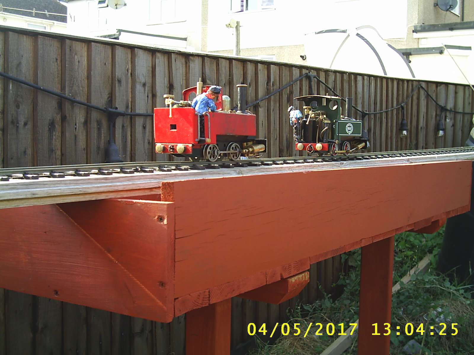

S2020152 (1).JPG (320.11 KiB) Viewed 83949 times
Aaron,
These are my two SL1s that I purchased April & May 2017. The red loco is only a Mamod because it retains the original frames, drag bar & smokebox. The rest is Janet specification. The green loco retains the original boiler, cylinders/pistons & wheels. The RWM regulator, lubricator & SV (set at 40psi) have proved very worthwhile in both cases. I've not had problems with loose wheels on the green loco, but the new RWM cylinders/pistons fitted to the red loco increased the piston thrust so much that the Mazak wheels moved on the axles & locked. As for hauling capacity, ten loaded Mamod wagons are no problem. I'll post a video sometime soon.
All the best.
CSL

Very nice. Look forward to seeing a video. Do they have the same performance, or is the one with new cylinders the better?
I'm sure I've read on these forums that 40psi might be rather too much for the original Mamod sight glass...?
I'd be interested to hear what kind of performance a c.30-year-old Mamod in the condition that mine is (original apart from 20-25psi safety valve and meths burner - the RWM wheels being like-for-like rather than an upgrade - might be able to offer...
Abiogenesis
Re: MSS loco on 4' diameter curves ?
Post by Abiogenesis » Mon Jul 09, 2018 9:16 pm
The RMW cylinders/pistons were a necessity as they were missing on the left side of the first SL1 (now red) I purchased. The water sight glass in the Mamod brass boiler has not given me a problem, so far! With gas firing there is no margin for error if the Mamod boiler runs dry. Hence the Janet replacement from RMW. When I upgraded the boiler, Roy very kindly took back into stock the steam turret & SV I had purchased previously, as the tpi differed. I shall have no hesitation in acquiring a second boiler when a rebuild becomes due. They are top quality copper & are silver soldered with a decent water gauge glass. There is a take off for a syphon & pressure gauge as well.
The RMW cylinders/pistons deliver far greater performance. On the West Herts 16mm group indoor track, it's pulled 10 wagons loaded with stone ballast & a momentum wagon to keep the speed within decent bounds & the drivers were spinning madly on the oily Peco track. Great fun!
Steam oil 460 is essential to achieve a good seal between cylinders & pistons. Meths can contain too much water. You could consider trying 99.9% Isopropanol as a comparison. https://www.amazon.co.uk/BRAND-ISOPROPA ... B003D8SDSW
Addendum: I can replace original water sight glass in the Mamod brass boiler with polycarbonate. Polycarbonate has a glass transition temperature of about 147 °C (297 °F), so it softens gradually above this point and flows above about 155 °C (311 °F). Saturated steam at 40 psi has a temperature of 130.68 °C (267.224 °F)
