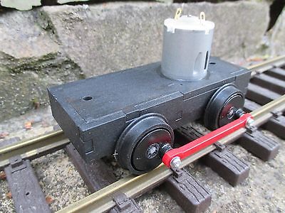

I've been pondering for a long time as to what would be a suitable diesel/petrol outline loco for the Selby Granite Tramway. A tramway the size of mine most likely would not be able to afford something like a Ruston. So I'm considering building a model of Day's rail tractor. Rail tractors are extremely common on tramways and light railways in Australia. They were popular due to them usually being cheaper than a steam locomotive, not requiring any special qualification to drive and spares being more readily available. Day's are believed to have built around 50 rail tractors in their factory in South Melbourne, Victoria, between 1926 and the mid 1940's. These rail tractors went on to work at various industries including sawmills, salt works, etc. There are a few examples of Day's rail tractors remaining, 3 of which reside at tramway I volunteer at.
My idea was to use a PS models chassis with buffer beams and running boards made out of plastic card and a 3D printed tractor motor body. With the motor and batteries hidden under the body and the RC gear between the frames. But I have very limited experience with this sort of thing. I've fitted anything with RC either. So I need to figure out what I need to fit the rail tractor with RC, how to wire it and weather or not I can get the batteries and RC equipment to fit on such a small vehicle. Can anyone give me some advice?

I agree with Jim, that RC Trains stuff ( Deltang ) is the way to go as far as the RC is concerned and Rik's blogs should tell you all you need to know about setting it up.
As for how to fit it all in a Tractor loco, I suspect you may struggle. Take a look at Tony Bird's various threads on motorising toys, especially the recent one on Electric Chassis ( https://gardenrails.org/forum/viewtopic ... 37&t=11771), they may give you some useful idea's.

As other have suggested, Deltang eqt is a good way of getting radio control into a small space. Because most Deltang receivers include an ESC (electronic speed controller) on the same very small circuit board, you are not wasting space by having to squeeze in a separate rx (receiver) and an ESC. Also, they are designed to operate from as little as one 3.7v li-ion battery, which again saves a lot of space. You could probably squeeze in a single 14500 (AA sized) li-ion battery and the electronics into that space - the body looks like it might be generous enough.
Take a look at a couple of the accounts of battery builds on my blog and also some of Tony's threads - he's great at squeezing quarts into pint pots:
