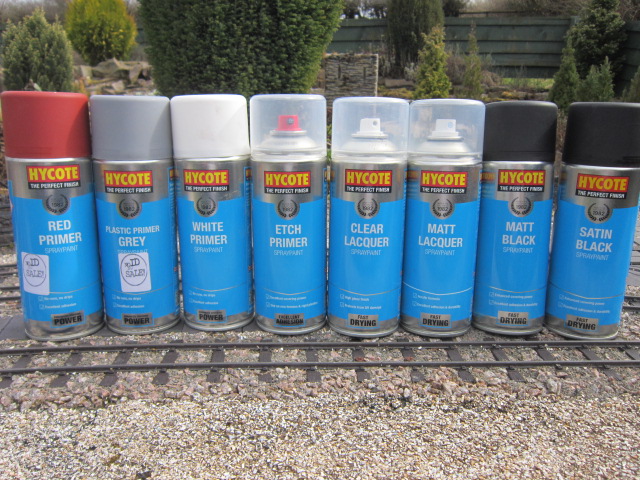

Can't knock Halford's products as I've always found them of good quality, although can be more expensive than my preferred choice of primers and finishes...
The ordinary grey primer is not shown as I have run out!
I buy these from 'The Range' but I'm sure there are many other outlets near you. They are quick drying, give excellent coverage and superb finish. They are also cheaper at £5.99 for 400ml. The colour variety is more limited but Halford's acrylic can be used on top of these primers.

Useful to know Peter, thanks. I pass my local Range to get to Halfords!

I also have Hycote in my collection - their red oxide can be found as a base on many of my wagons - like Peter I find this brand works well with Halfords finishing coats -and is available via Amazon if you are not near The Range or a Halfords store - a bit more expensive from there but by the time you cost in car juice if you are making a specific trip, probably just as cheap
