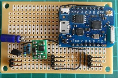

Picture shows the control board for a typical steam loco showing the Wemos D1 mini pro with a 5v step-up regulator, temperature sensor and connectors for two servos and a 3.7 volt lithium battery.
Once connected to the network, there are various ways of sending messages between all the devices. Based on my home automation experience, I'm using the messaging protocol MQTT. This requires an MQTT server which in my case is located on a Raspberry Pi Zero W. Unlike typical loco control systems, messages can also be sent from each device, and between each device, allowing useful information from the locos to be available to the user, like battery voltage, location, actual speed, etc.

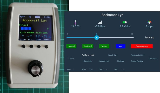

An ESP8266 based hand-held controller with a tft colour display and a PC/tablet/phone program provides the control.

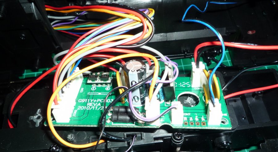

Bachmann Lyn Conversion
Whilst the Bachmann Lyn is G scale (1:22.5) and therefore slightly undersized for the rest of my 16mm railway, it's a nice little loco, good value for the money and runs flawlessly on my less than perfectly laid 45mm track. A minor niggle is that the cab and bunker are too high. I tend to use this first to ensure the track is ok and when I'm in the garden, working, eating or drinking wine, and just want a train to run with minimal control. A secondhand model purchased from Ebay was my first loco, later to replaced by a new one, when Bachmann bought out a much improved version a few years later.
It is easy to take apart (4 screws) and contains a DCC ready control PCB that sits on top of the motor drive assembly. There are two switches accessible when the front of the smoke box is opened. The original PCB has been replaced with one containing the microcontroller and associated components. Two 18650 lithium batteries are fitted in each side tank along with a 4 cell charger/protection circuit.

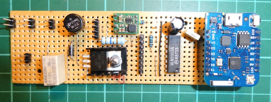

The component cost of the PCB, which is a typical of that needed for an electric loco, is £12-£18 depending on source of components. Details are:
1) The 3 connectors to the top left are the electric pick up points for the front, centre and rear wheels. These are used to charge the battery either off the track or from a section of the track that is powered, so it can be recharged during use. This also saves having a separate charger socket. The bridge rectifier ensures the polarity is irrelevant.
2) The lower left comprises a 2 way connector to the motor, power MOS FET and relay used to drive the motor. I use this rather than a separate motor driver as from experience these typically (especially type L298) lose to many volts (reduces speed), get hot and wastes battery capacity. However, I haven't looked lately so there maybe a better alternative now.
3) A 4 way connector for power from the batteries in the side tanks and the original on/off switch located in the smoke box.
4) A 5 volt step-down switched mode power supply. I love Pololu products.
5) An 8 way connector and ULN2003 driver for the relay, front lamp and smoke generator, leaving 4 outputs available for future use.
6) A Wemos D1 mini pro microcontroller. There are cheaper alternatives and clones but I have standardised on this one.

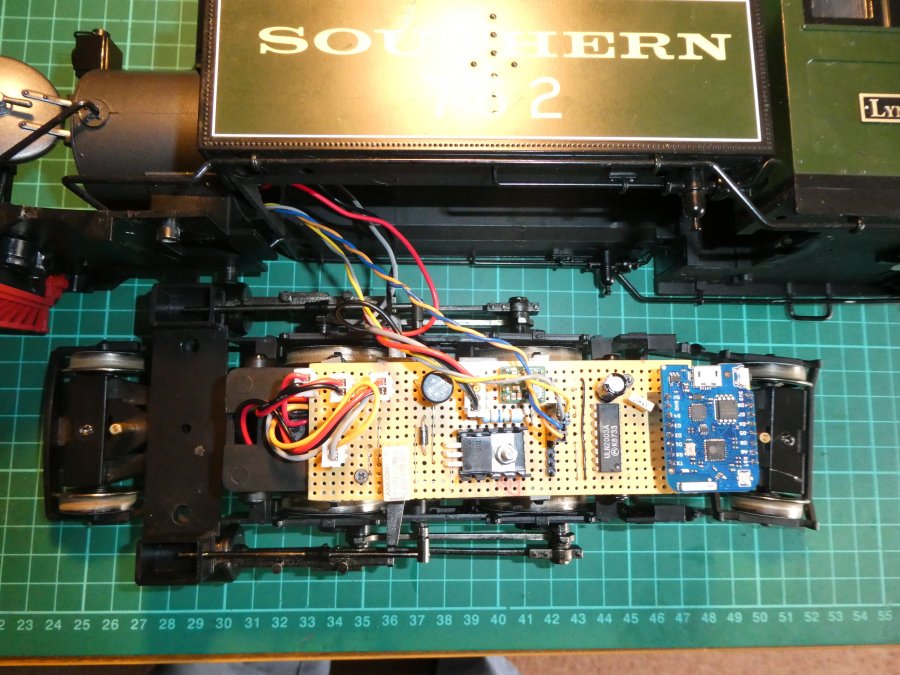

Pictures showing the assembly of the original control board and the new one.
A simplified descriptive flowchart of the software is as follows:
 Power on
 Initialisation
 Front lamp on
 Connect to wi-fi
 Connect to MQTT server
 Subscribe to messages that are applicable (speed, direction etc.)
 Download schedule (for automatic mode)
 Front lamp off (gives visual indication that everything has been setup correctly)
 Start main loop
 Check for incoming messages
   If speed, set loco speed
   If direction, set direction
   If lamp, turn lamp on or off
 If 30 second timer occurs
    Send status, speed, battery voltage, temperature and wi-fi signal strength messages
 Return to start of loop
Between the recent bad weather, I've been testing the Bachmann Lyn on my newly extended track and have been really pleased with the results, sufficiently to start this thread and share my experiences.
