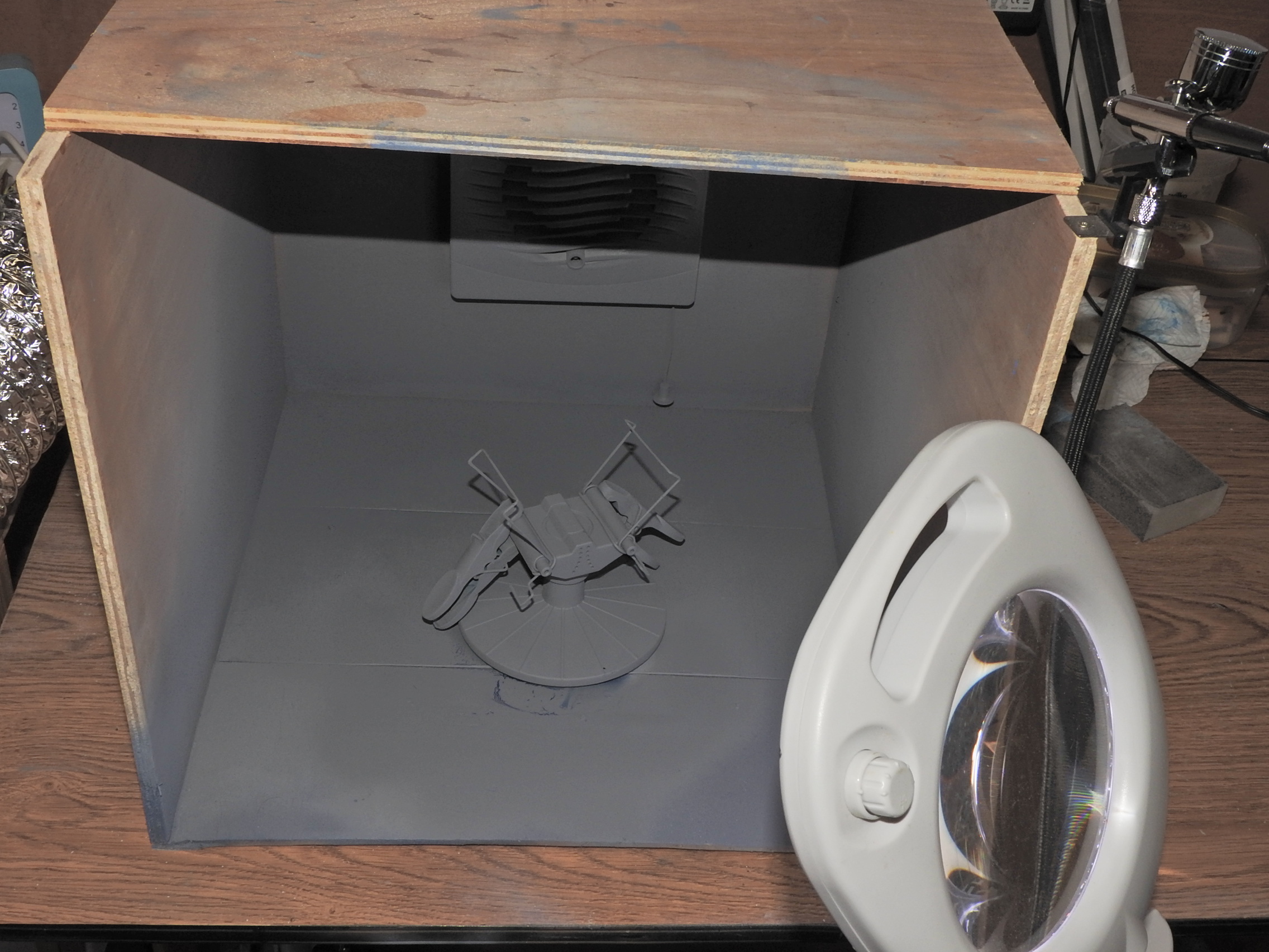

Re: I'm looking for an effective paint spray booth for models.
This is my Spray Paint Booth made from left over 5 ply board I used for re-enforcing the floor of the shed. I have used a Bathroom extractor fan with an expandable hose. Total cost..£18. It is ok for painting wagons and small coach’s, bear in mind, I made this for painting my N Gauge stuff, so if I need to paint bigger stuff, it wouldn’t take me long to do another one... although i have painted some 32mm wagons and a couple of coaches in it easy enough, so if i did get something larger i would try it first. :thumb right:
This looks very good and convenient to use. My fear with self build is whether any fan and motor I use are spark free or likely to be safe with a mist of potentially combustable paint spray being sucked through it.
It certainly looks as though the exhaust fan is very much more effective than my present one.
This fan has the motor enclosed because it is for use in a bathroom.
