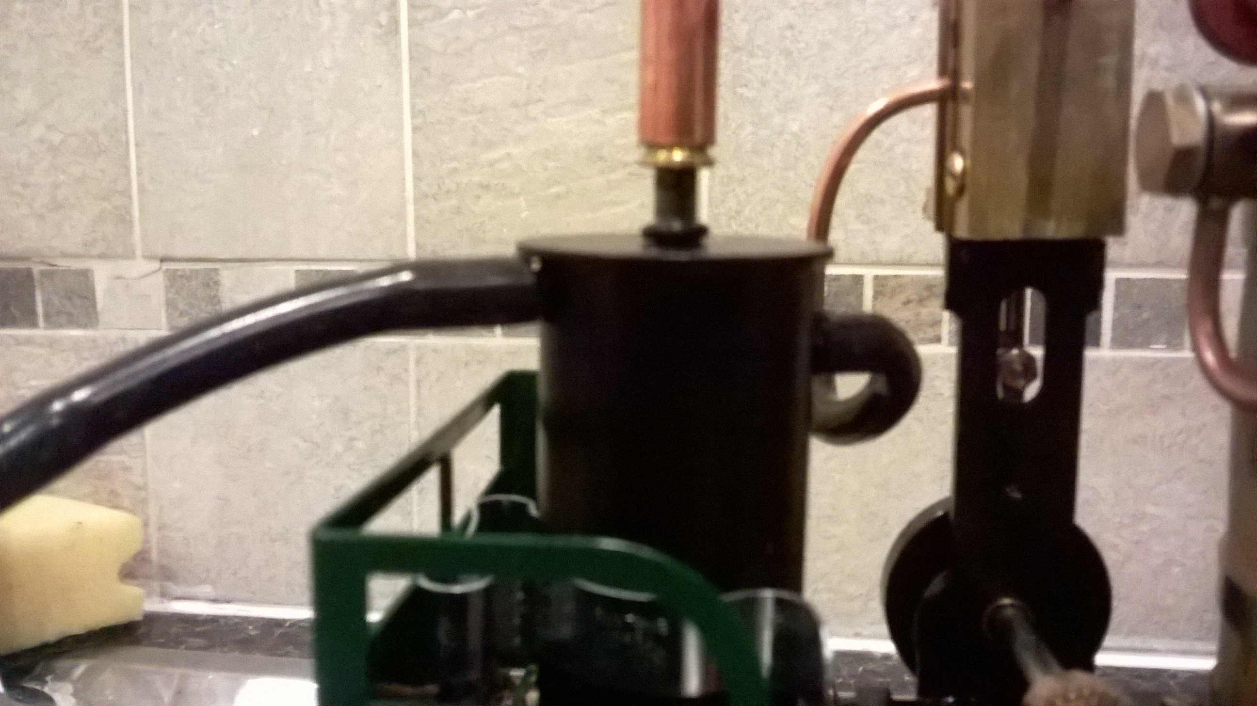

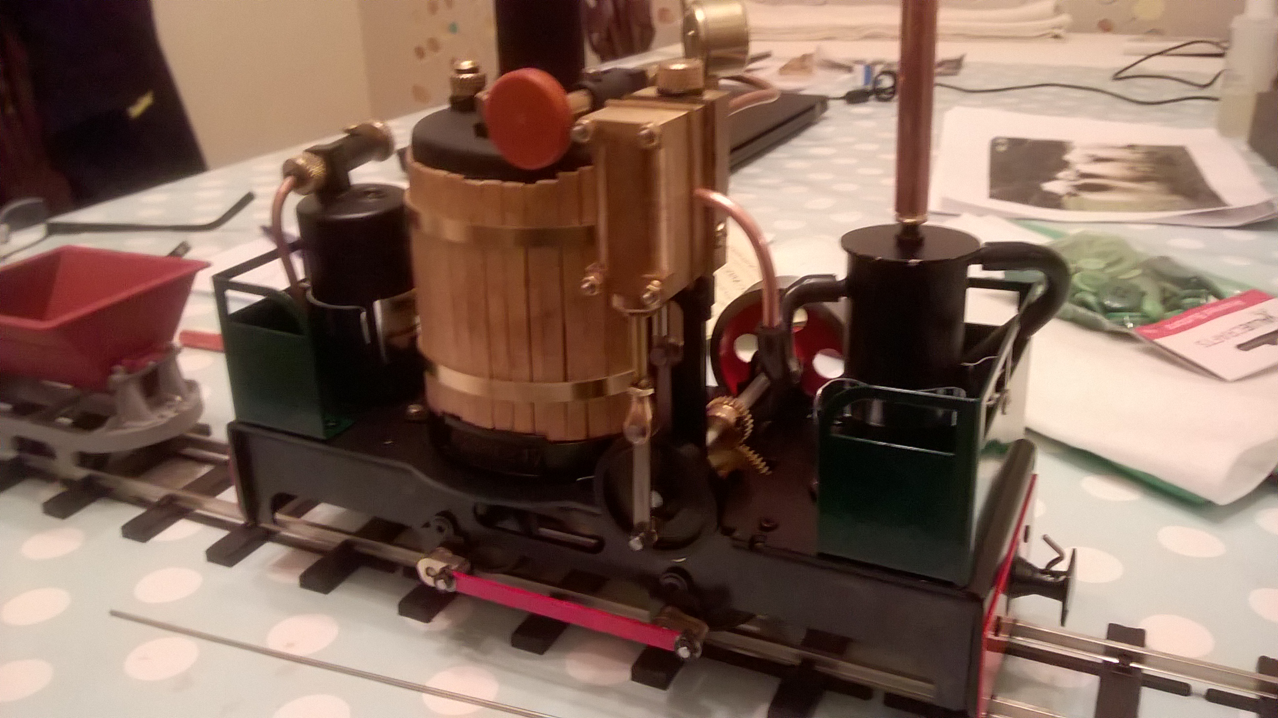

Hi all, I am new to this forum and 16mm steam. I also model g scale trams. I have recently bought a Mamod Brunel, and ran it for the first time on tracks the other week. I have fitted a Clevedon Steam condensate tank and fashioned a chimney out of a coffee machine part! Has anyone fitted a Chuff pipe to a Brunel?

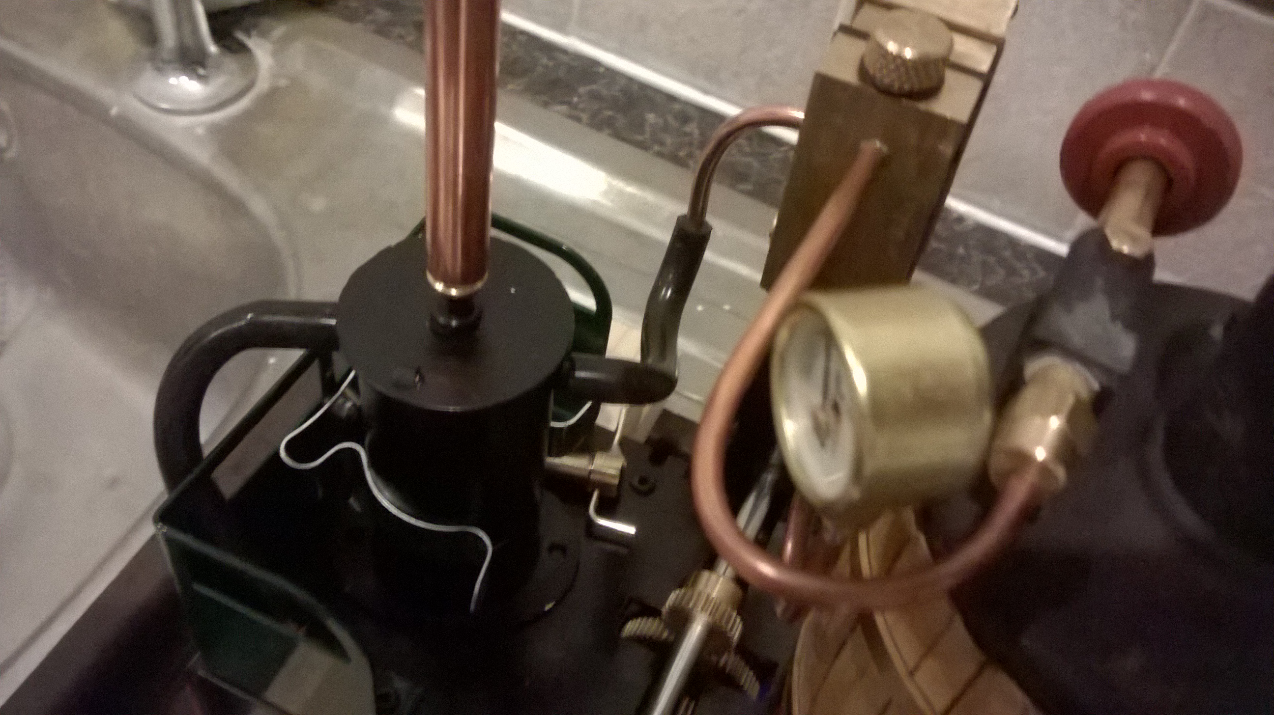

I'm interested by your condenser mod. What route does the piping take? It's not quite clear in the pictures (there seem to be at least three ports, including the chimney exhaust, in the condenser) - and is the exhaust pipe from the cylinder missing in the close-up pic?
Also, did you deliberately keep the new steam exit away from the burner chimney? I've been doing some mental exercises (which are probably beyond my metalworking skills!) as to how the steam exhaust could look more like it was coming out of the main chimney, but I take it you had reasons for not doing that.
kins73
Re: Mamod Brunel
Hi, the condenser tank is from Clevedon steam, it has three connections. The top one is the exhaust, one side is the steam in and the other is the drain. To drain the tank you need to block off the exhaust and use the steam pressure to blow out the water. The reason for not putting the exhaust next to the boiler chimney is to prevent water getting onto the ceramic burner. But, as I am new to this I am open to suggestions or improvements. Using the silicon tubing enables me to remove tank at any point for maintenance.

Sorry, yes one photo doesn't have the copper pipe as it was during fitting/laying out

Thanks for the responses. I'm pretty new to this too, but I do have my eye on a Brunel and am interested in how it might be modified.
So you don't reckon you can put the exhaust near the chimney even with the condensate tank?
I'm sure I'd read that the reason for the Brunel's steam exhaust being remote from the chimney was to do with avoiding lubricating oil carry-over getting to the burner, while (now that I've looked at it!) the Clevedon website says that the purpose of the condensate tank is to remove the oil (not water) from the exhaust. Is that a simplification then?
I take it that the higher of the two side ports of the tank is the drain and you've fitted silicon tube over the side of the loco?
I don't quite understand how the condensate tank drain function actually works: how does the steam push the oil/water when the path of least resistance is direct from the input to the output? I presume it's something to do with the internal piping arrangement?
kins73
Re: Mamod Brunel
Hi, yes the exit pipe that dissapears over the side of the loco has a blanking rivet in place. To emory the tank you need to removed the silicon pipe with blank. Remove the 'chimney' from the top and fit the short silicon pipe with blanking rivet. The steam from the cylinder will pish out the oil and water, and it comes out with quite a jet! I have only steamed it once with the tank
it stops the steam oil going all over the track and loco as it was getting splattered everywhere!

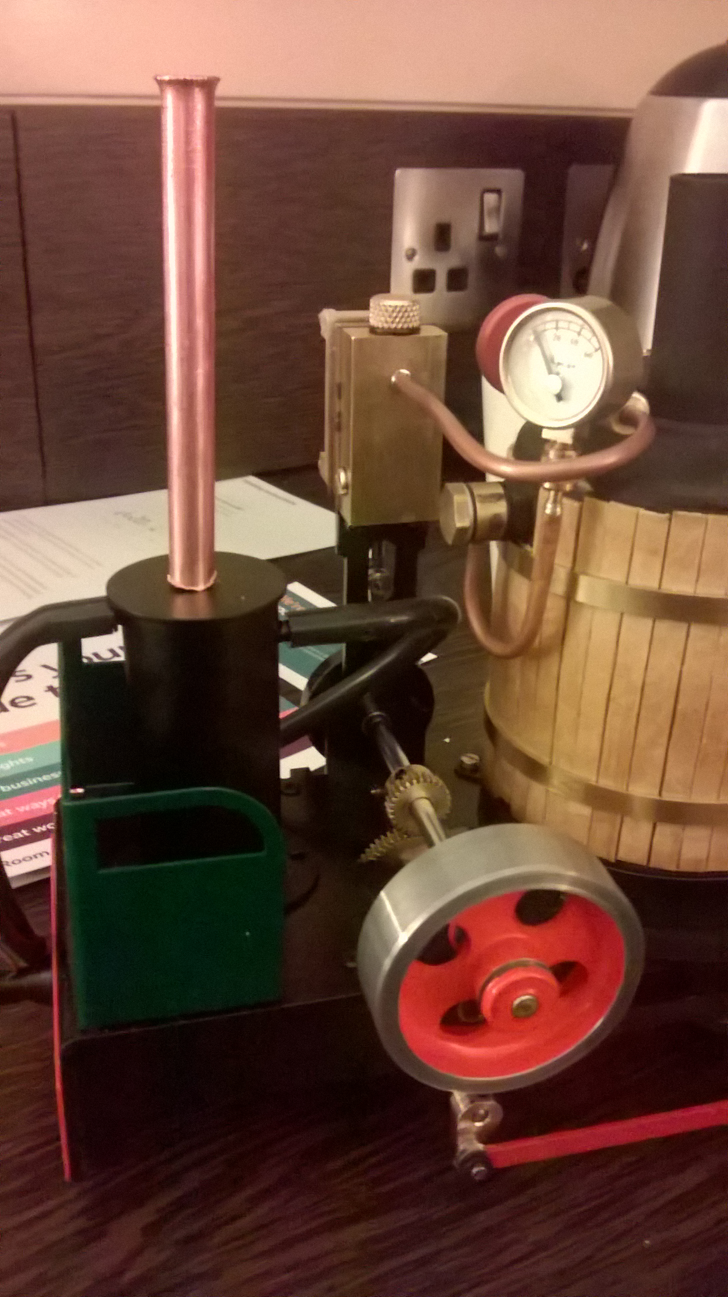

Hi all, a few more photos to show the condensate tank.

Thank you for sharing more photos. Were the latest set actually taken before the first photos you posted, since they seem to show an experimental clip arrangement holding the condensate tank in place, whereas the first set appears to show (?) the tank bolted down?
Out of interest, what is the brass fitting lying on the "footplate" next to the tank in the recently-posted photos?
I hadn't realised that the blanking rivet is simply pushed up the silicon pipe to block it off! (Or have I missed something?)

Correction: the clip is shown in one of the very first photos, but apparently not the other.
kins73
Re: Mamod Brunel
Yes, the photos are out of order. But, hopefully you can see the piping arrangement-that was the point. The tank is held in place with a spring clip similar to the gas tank. The brass bit lying on the floor is a wind down handbrake which has yet to be fitted.
