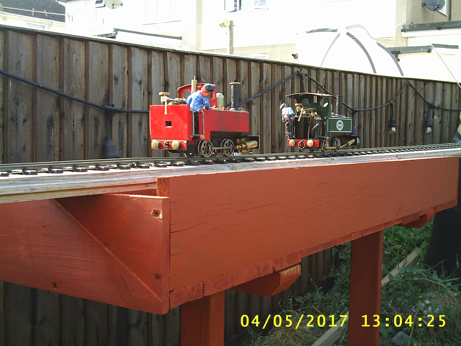

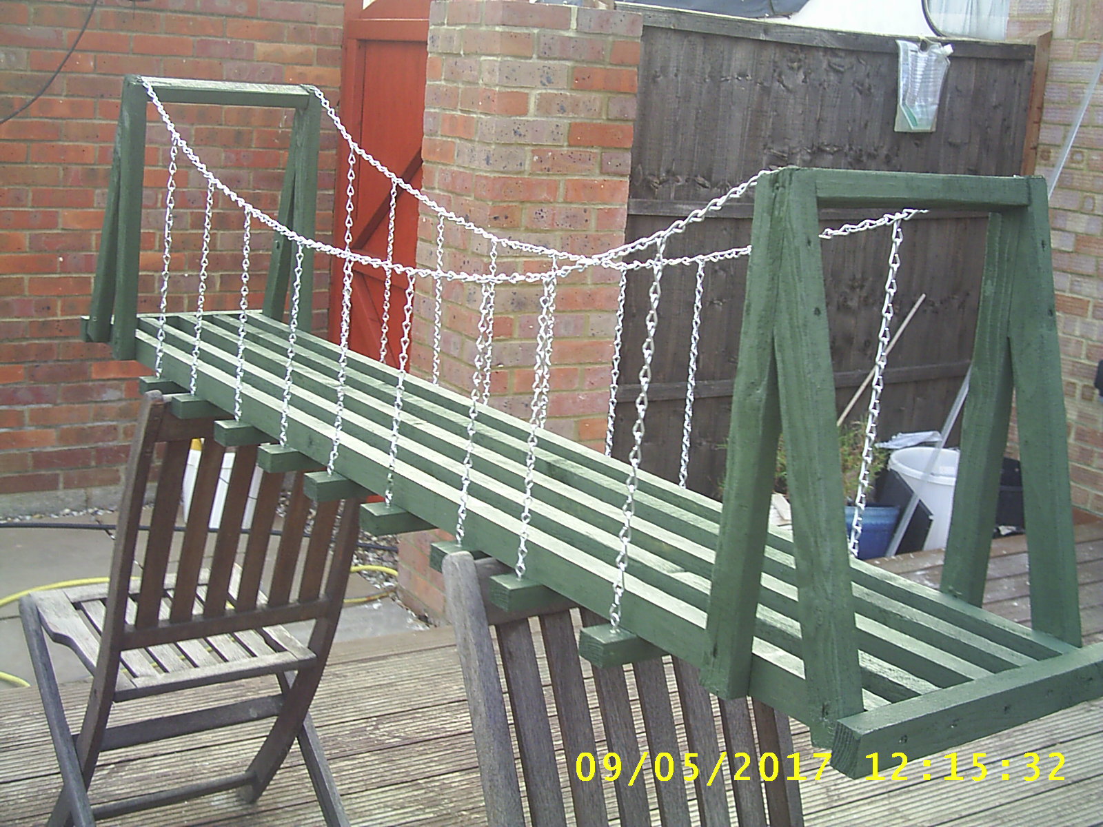

Reasonable progress today. Lifting suspension chain bridge completed. Two coats of Wickes Sherwood Green applied. Trestle bents ready to erect. End wall of garage due to be rendered sometime soon.
Trestle bridge to cross pond receiving extra coat of Sherwood Green

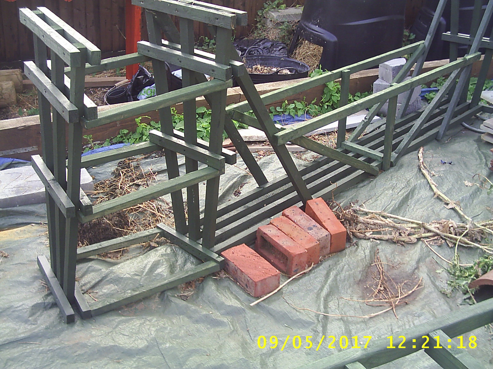

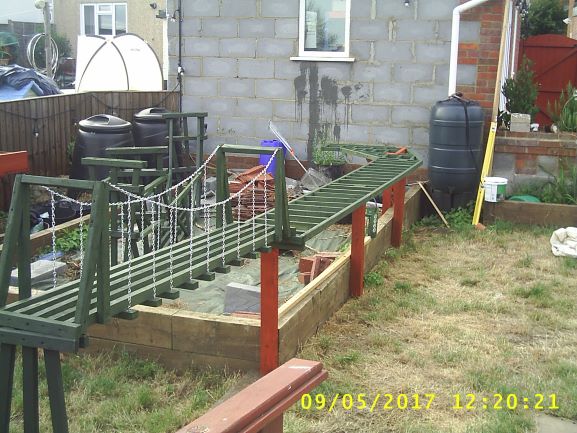

The third photo is from yesterday. I didn't get around to posting it. The first two photos chronicle some of the progress today. I was also preparing the posts that will be fixed to the timbers adjacent to the compost bins that surrounding the vegetable patch. The late Spring was not very encouraging, so we covered the ground with a tarpaulin to suppress weeds.
The pond is not my responsibility. It was carelessly built & the liner was pierced, whilst the waterfall feature was being constructed at the other end four years ago. The water is eighteen inches lower than planned. The talk is to invest in a new liner, but I've suggested hiding the liner with rocks & creating a long & low water feature along either side of the red bridge. The paving stones should also have been cantilevered out over the water as well, in order to hide the liner, but who listens to the old man? :lol:

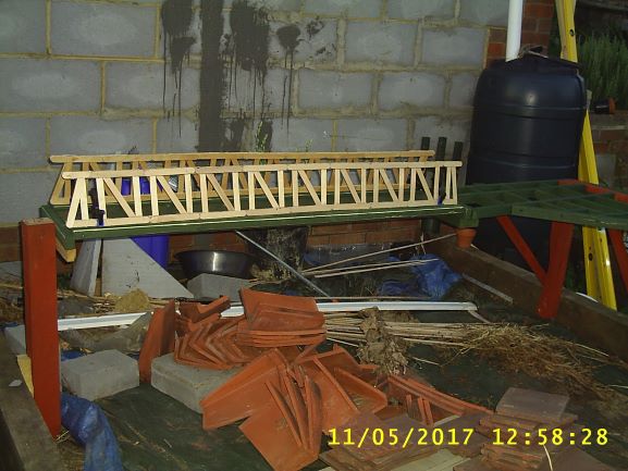

THIRD BRIDGE.JPG (52.97 KiB) Viewed 17819 times
THIRD BRIDGE 1.JPG (55.67 KiB) Viewed 17819 times
Work nearly completed on third bridge.The side "lattice girder work" is formed with lolly sticks bonded with hot melt adhesive. They are just standing in place for the photos. I made an earlier attempt to create a complete bridge last Summer. It was nearly nine feet long & included a lattice deck. I used 1500 lolly sticks & 45 long sticks of hot melt. I built it in sections, then assembled it outside. It was lightweight, but stiff & strong. Sealing & painting it seemed to take an age, but I thoroughly enjoyed the whole project. I had a short end to end layout then & watching a train pass along the length of the bridge, which was only supported at the ends, was terrific entertainment (to me at least). :roll:
