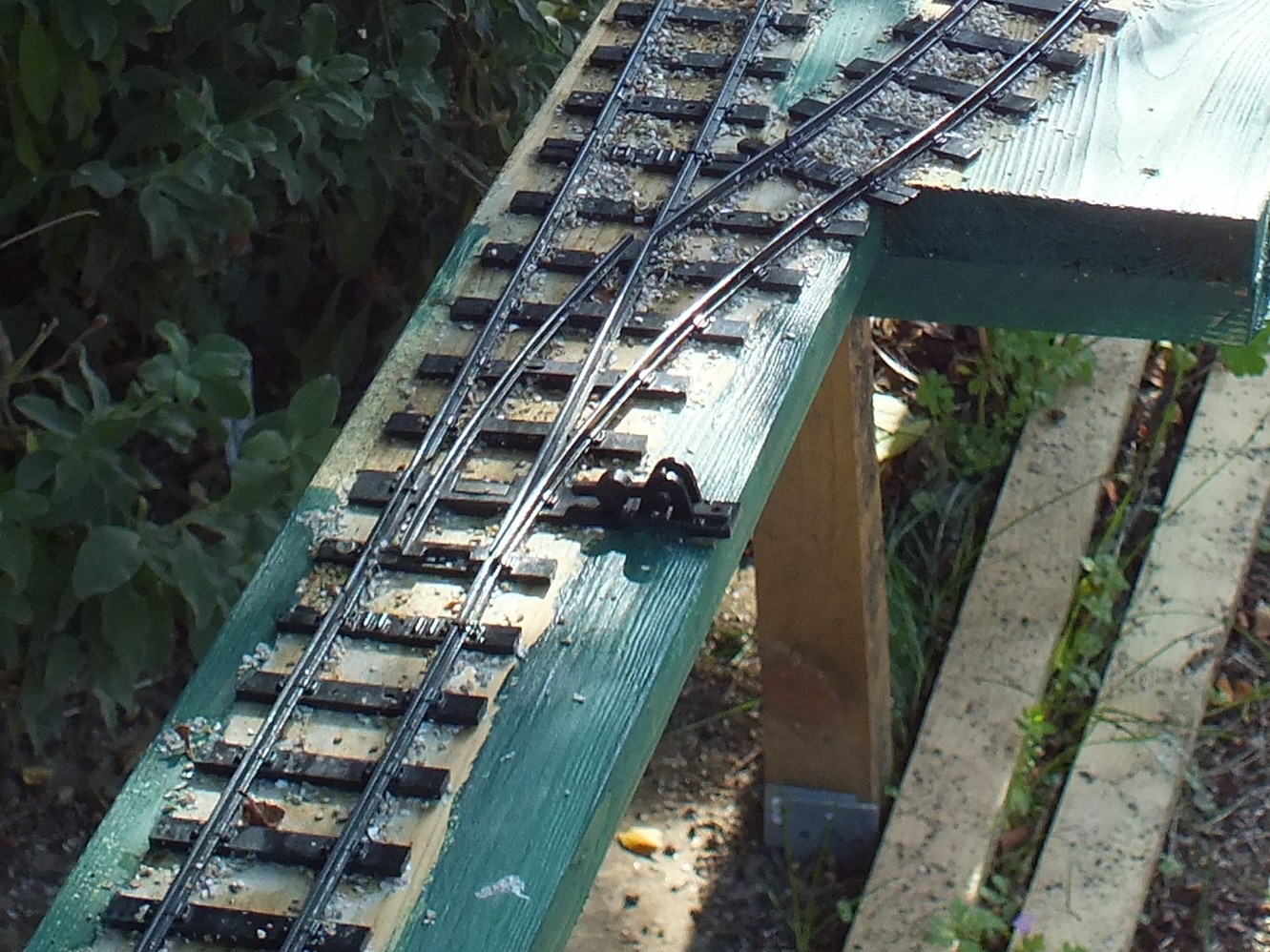

by dave3054
MSS Point.jpg (411.03 KiB) Viewed 11858 times
This is the point in question. Its the MSS version of the Mamod track point.
As you can see it is off the ground by 2 feet.
What do you think?
Cheers
Dave
