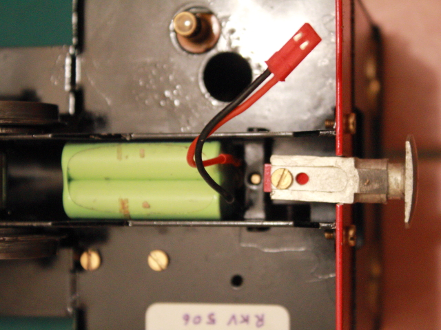

by Chris Cairns
It is (just) possible to fit a 4 X AAA battery pack between the frames of a 32mm Bertie, but not too much space left for anything else if you stick with the standard Roundhouse buffer beam & centre buffer coupling (GTB's converted Bertie model has a chopper coupling fitted).
Bertie Battery 01.JPG (345.55 KiB) Viewed 8358 times
Bertie Battery 02.JPG (341.71 KiB) Viewed 8358 times
Chris Cairns
Re: Roundhouse Bertie
Posted: Wed Sep 06, 2017 2:19 pm
by GTB
Chris Cairns wrote: Tue Sep 05, 2017 6:39 pm It is (just) possible to fit a 4 X AAA battery pack between the frames of a 32mm Bertie
I thought it might be possible, but only if the shrink wrap on the battery pack was thin enough. There is probably just enough space for the charging socket and switch to be fitted between the battery and the axle, if the coupler mounting tab is retained.
That mounting tab used on most Roundhouse locos is designed to make it easy to fit an LGB hook and loop coupler in place of the centre buffer.
The simplest way to get more space under the cab and still fit a centre buffer, without making a new buffer beam, is to bend the tab back flush with the buffer beam and drill a hole in it. the normal type of 16mm centre buffer that is fixed by a nut behind the buffer beam can then be mounted.
