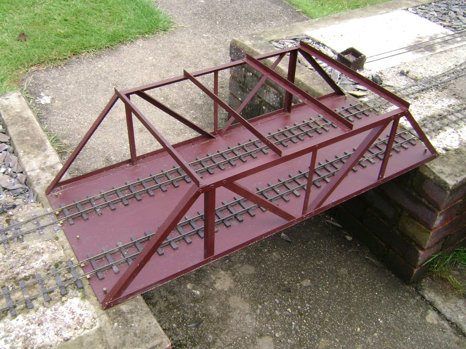

Mine is just held in place by gravity. Three vertical pins at one end and two at the other prevent it from being put in the wrong way around (not that it would actually make much difference). Rail joiners have a tab soldered to their undersides for easy sliding.
- Attachments
- DSC00838.JPG (772.19 KiB) Viewed 3233 times

Thanks guys.
I like what you have done Tony. Once I get the bridge I will see how heavy it is as simply slotting it into place may be the answer.
