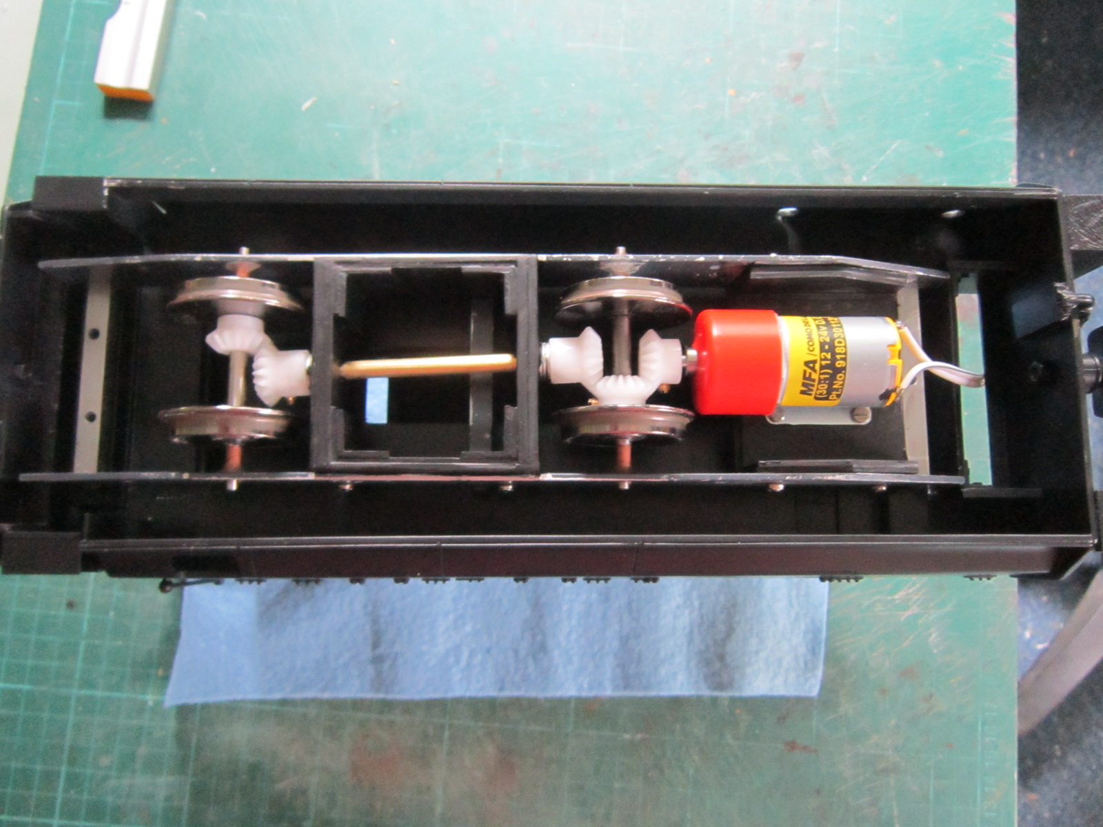

Re: Motorgearbox
I think Essel get theirs from MFA Como. I've used a 918D 12-24v 1:30 gearbox motor in one of my builds but as you can see there is a wide range of different options - https://www.mfacomodrills.com/gearboxes/gearboxes.html - and they are remarkably reasonably priced
- Posts: 5715
Re: Motorgearbox
I have used the same motor/gearbox as Rik in several of my chassis and they are very good in operation. One I have managed to rig up to a geared four wheel drive using nylon bevel gears.....

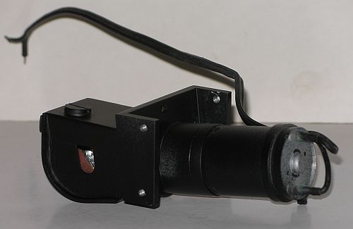

Hi Methsman,
I don't know if this fits your criteria, but the motor gearbox combination I recently fitted to my petrol/mech. loco is 34:1 reduction 12volt and measures approx. 25mm diam. and motor gear casing is 53mm long. Brush contacts and shaft extend these measurements. The shaft is 5mm diam. if I remember correctly and about 12mm long. I can provide more info if necessary
PS this unit mounts by tapped holes in the gearcase, very sturdy for a bevel gear drive.
