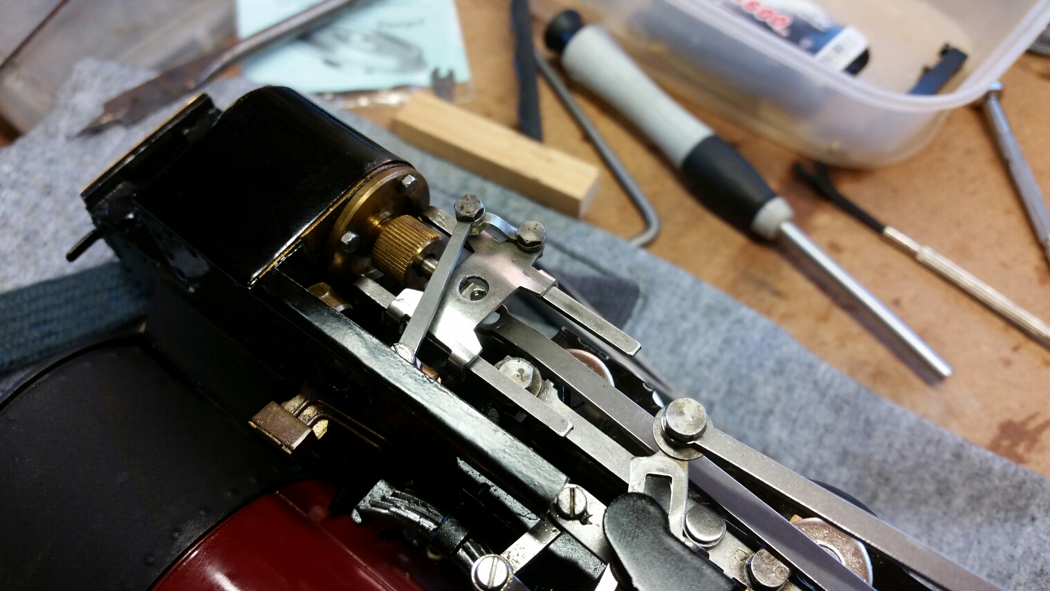

In my haste to remove the running gear to fit the slomo I did not photograph how this part went back together:
2017-07-25 19.38.17.jpg (862.49 KiB) Viewed 3281 times
It is different to my Lady Anne set up in that the bolt does not screw in from the front but behind but I cannot get it to bite and I do not know where the washer should go.
Re: Roundhouse Silver Lady connecting rod
Post by tom_tom_go » Tue Jul 25, 2017 9:00 pm
Needs to end up like this:

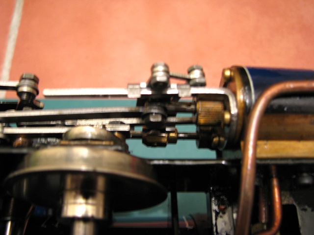

Post by Chris Cairns » Tue Jul 25, 2017 10:00 pm
Put the washer onto the bolt, feed the bolt through the connecting rod from the back, then through the piston rod end, through the crosshead, and secure with the nut on the outside.
Had difficulty getting an indoor image in focus & well exposed but hopefully you can see it here.
Silver Lady Crosshead.JPG (112.72 KiB) Viewed 3262 times

Thank you Chris, that photo shows me exactly what I needed to see.
