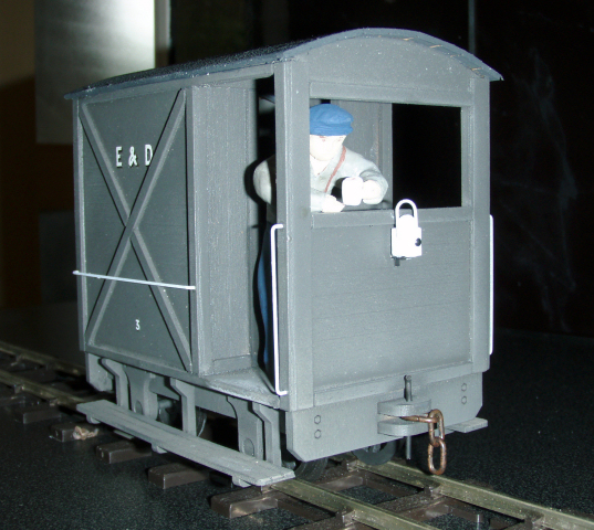

I have an Andel brake van which looks fairly similar to yours. Mine is in grey because thats my freight stock colour.
003 small.jpg (336.5 KiB) Viewed 12345 times
