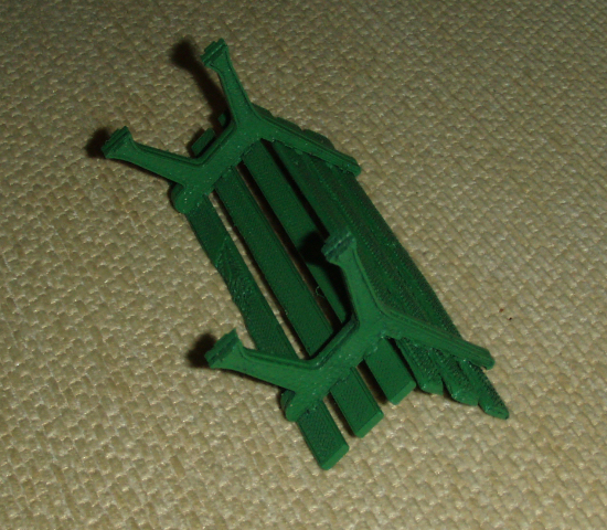

Using the reel of PLA filament that came with the machine ( No, I did NOT ask for Fluorescent Orange!!) and the basic settings which were suggested, I set it to run this morning. Took about 1.5 hours to produce this, just finished and still on the print bed:
There were a couple of problems with the print, the RH end of the RH slats lifted and deformed slightly and the filament got caught by the nozzle for some reason on the LH set, but overall I was pretty pleased with the way my drawing actually printed, for a first effort.
It took a few minutes to clean everything up and then could glue the kit together. I wasn't sure what to use but I soon discovered that PLA works nicely with Plasticweld, so that problem is solved. Once cleaned up it was only a few minutes work to assemble the kit:
To be honest, I should have taken a few minutes more to fill some small gaps between the two halves of the legs, but I was impatient to see how it looked when not bright orange! So out with the grey primer followed an hour later by a blast of the Company standard green, and Hey Presto....
P6250002 (2).JPG (381.18 KiB) Viewed 12206 times
So, I'm well pleased with the investment so far and to anyone else who may be thinking about it, I'd say have a go. I'm fairly confident that with some more practice and adjustment of the printing parameters the sky is pretty much the limit - as long as it fits in the printer of course!
