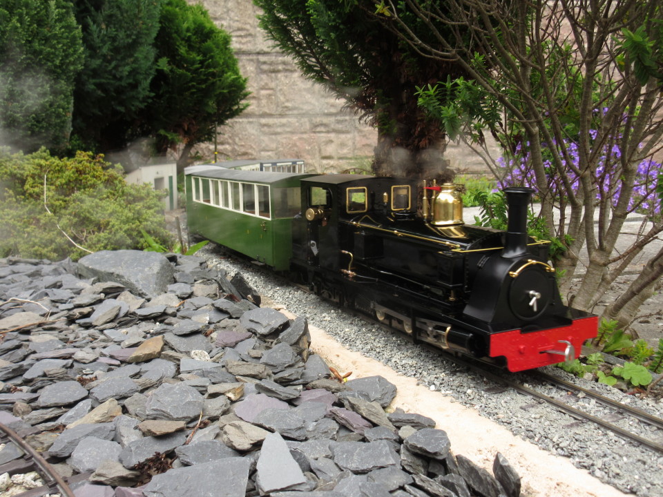

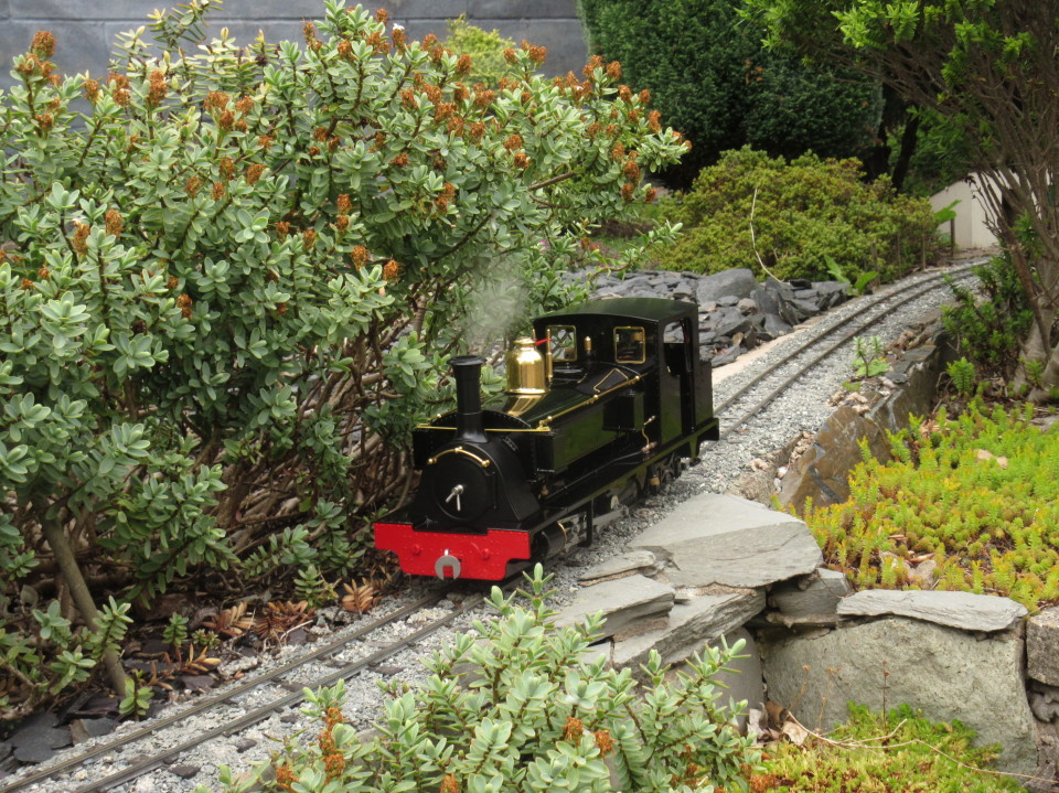

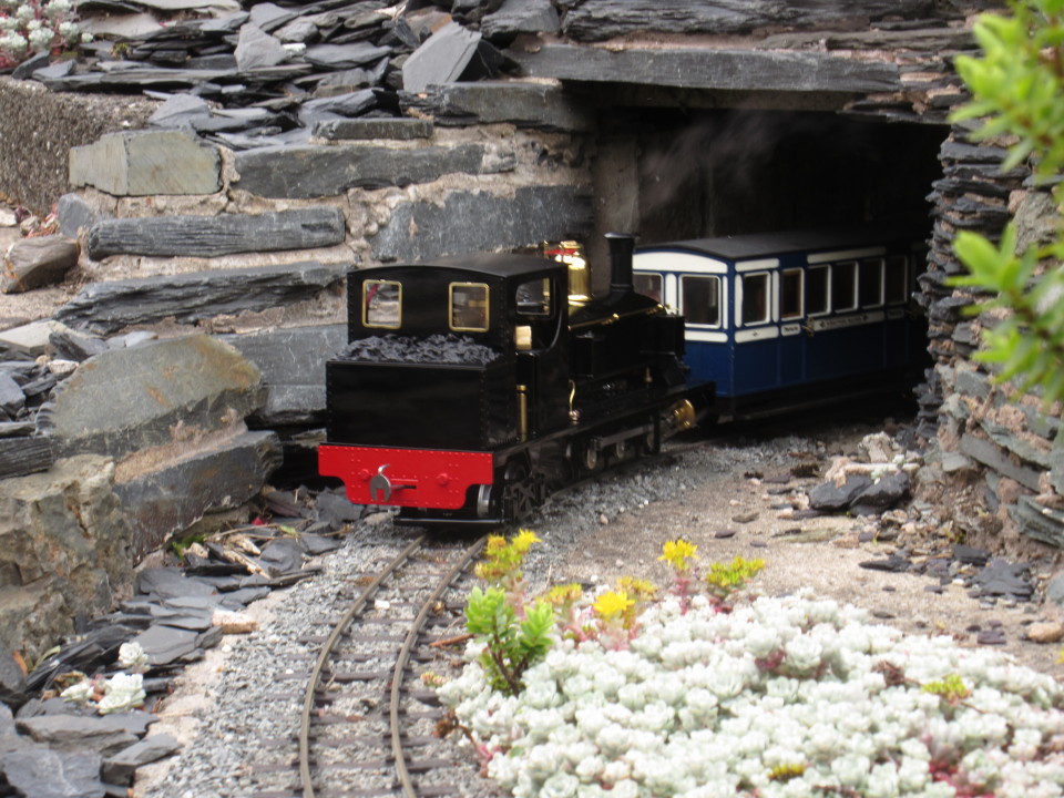

Well, here we go, a picture of one of the re-ballasted sections of the Afonglas and Nant Llwyd Railway.
IMG_1185 - Copy.JPG (339.17 KiB) Viewed 9875 times
And the reason for the work? Well, its in the photo too. A beautiful black Roundhouse Beddgelert has joined my fleet, after being ordered at the end of February. It arrived at my parents last Wednesday and returning home for my weekend allowed me to steam it for the first time on Monday 12th June. I've wanted one of these since I first saw one at an Elsecar show, the reason for choosing black being that I like the 12 1/4 inch gauge version at Fairbourne which is black, and nearly everyone seems to get one in red!
IMG_1194 - Copy.JPG (278.58 KiB) Viewed 9875 times
IMG_1196 - Copy.JPG (237.64 KiB) Viewed 9875 times
A couple more pictures of the ballasted track and Beddgelert, I think both look rather well.
