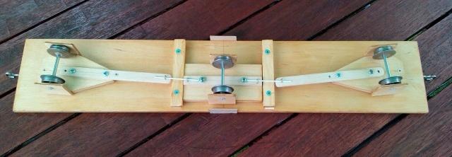

Hi AFGadd.
This is the the first version of the system i worked on for my NWNG Railways Cleminson model. I know this is for a long coach and yours seems to be for a shorter model but it will give you another modellers solution to the problem. My final version used longer and thinner steel wires and shorter wooden arms than those shown to allow more flexibility on reverse curves such as negotiating sets of points when turning onto a siding that runs parallel to the main line.
The main problem i had to overcome was to allow the first bogie to turn before the second and third and then straighten out again while the others are turning.
Hope this gives you more food for thought.
David.
David.
