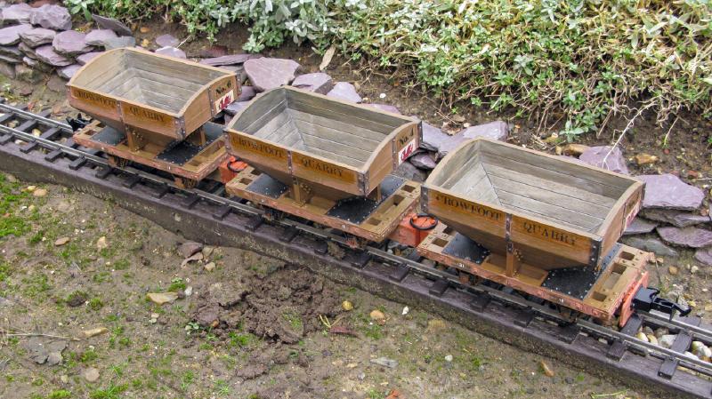

I also like chopper couplings. I did the following on a trio of Swift Sixteen hopper wagons. I accept these wagons are larger than your granite wagons but the method might be useful to at least consider. The advantages are that loco shunting uses the chopper couplings yet the proper wagon couplings keep the gaps between the wagons more convincing. Good luck.

Post by LNR » Sun Nov 20, 2016 11:47 pm
Sorry to be a bit off track, but that's a fabulous weathering and paint job. Are they "O" rings for coupling between wagons?
andymctractor
Posts: 712
Location: Suffolk, UK
Post by andymctractor » Mon Nov 21, 2016 6:25 pm
LNR:121062 wrote:Sorry to be a bit off track, but that's a fabulous weathering and paint job. Are they "O" rings for coupling between wagons?
Hi,
thanks for the comments.
They are O seals.  The trick is to find a size that holds the wagons together when hauled under load also allowing the seal to expand as the wagons negotiate tight curves without pulling the wagons off the rails.  The ones shown are a little large but they did work well for this short train.
I got a handful from a plumber.
B+Q etc sell them but you have to buy a packet with a range of sizes most of which you will never use, unless you are a plumber.
Good luck.
EDIT sorry didn't notice you were from OZ.  I'm sure you have similar DIY retailers to B+Q.
There is a video of them being hauled by my Roundhouse diesel. I cheated a bit as the diesel doesn't have chopper couplings so I had to use an adaptation of the O seal method for the loco.
The hoppers can be seen from about 3 mins to about 7.45 on the videos.
https://youtu.be/UcicgOSWKII
Hope it works.
Andy McMahon
