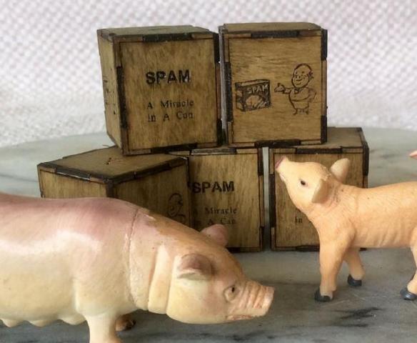

Wooden ones (solid, not ply) from a doll-house size laser kit, stencilled using reversed photocopies as iron-on transfers, one weathered with tea-iron mix and a knife.
I don't have any of the kits left, but a 1/24 one is on my Laser List.

I'm afraid not: I was given a few flat-pack kits by a kindly 7/8" fan in the USA, and started by experimenting with distressing, weathering and printing - all in the flat:
The tricky bit is gluing such a beast together without the glue showing. (Of course it doesn't matter if you are going to paint it, but it matters a lot if you are going to stain it or leave it bare.) I carefully coat the contact surfaces ONLY with cellulose Balsa Cement, wait for the glue to dry
thoroughly, then dry-assemble fully. I use a paintbrush to flood each joint in turn with acetone, which welds the cellulose inside the joints.
This leaves no glue deposit visible, inside or out, other than accidental over-spill.
Ageing them with that tea mix certainly looks effective.
For thousands of years, European inks were made up of minute specks of dark iron compound trapped IN the fibres of the page rather than laid in the surface. We can use the same chemistry by soaking tannin-bearing woods (oak, walnut etc) in gardeners' ferrous sulphate lawn treatment. Because these boxes were made from a low-tannin wood (lime = basswood = linden) I upped the tannin by soaking in strong cheap tea. Don't mix the solutions together - bathe the wood in them alternately so that the iron pigments are created IN the wood fibres, not merely in the soup. That's why this method gives greyer greys than the old modellers' standby of India Ink diluted with alcohol. (India Ink = Chinese Ink is basically soot suspended in glue, and far older and blacker than Mediaeval Ink.)
