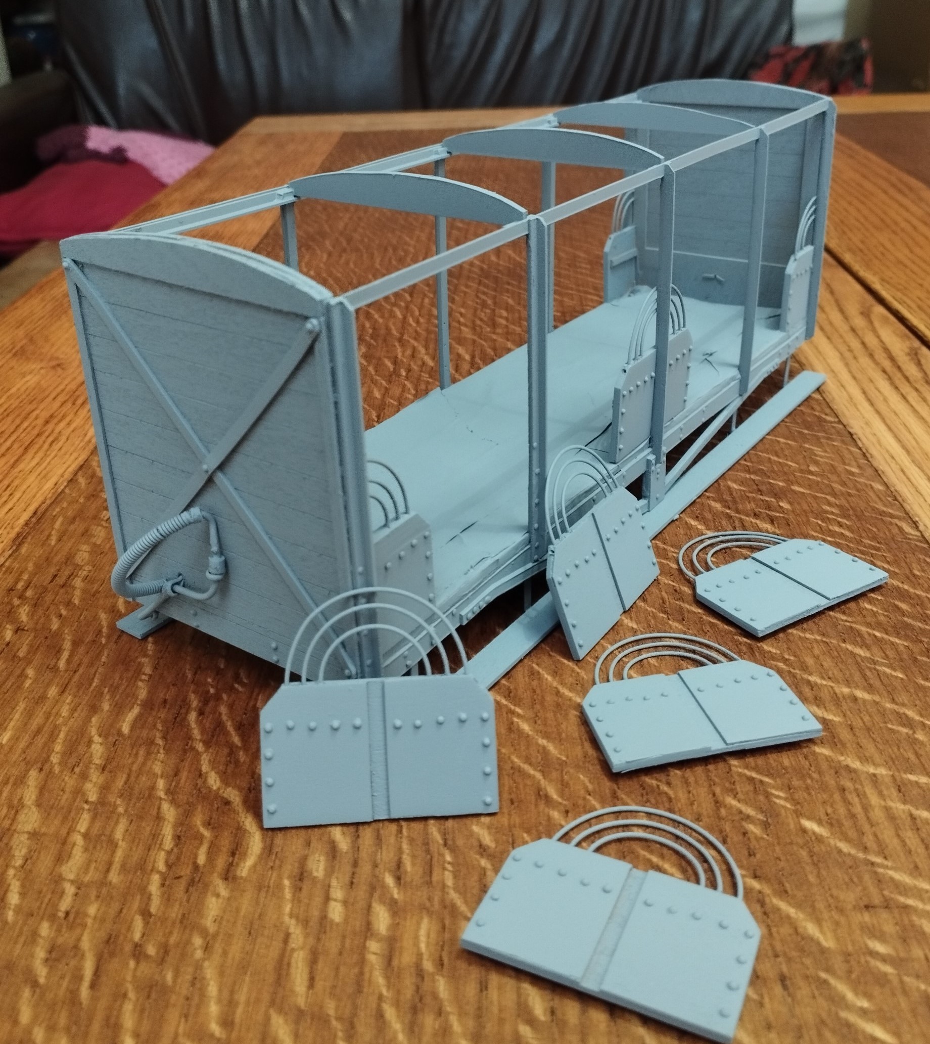

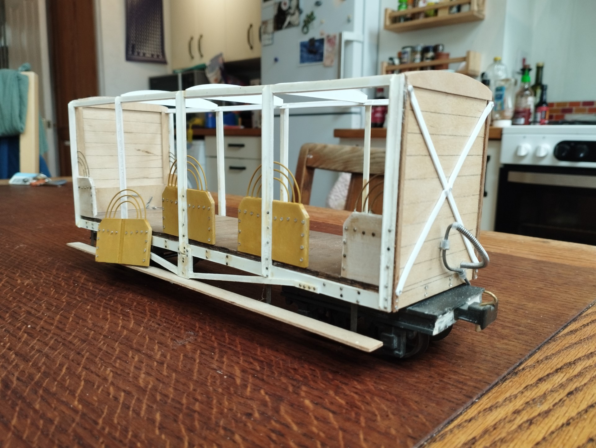

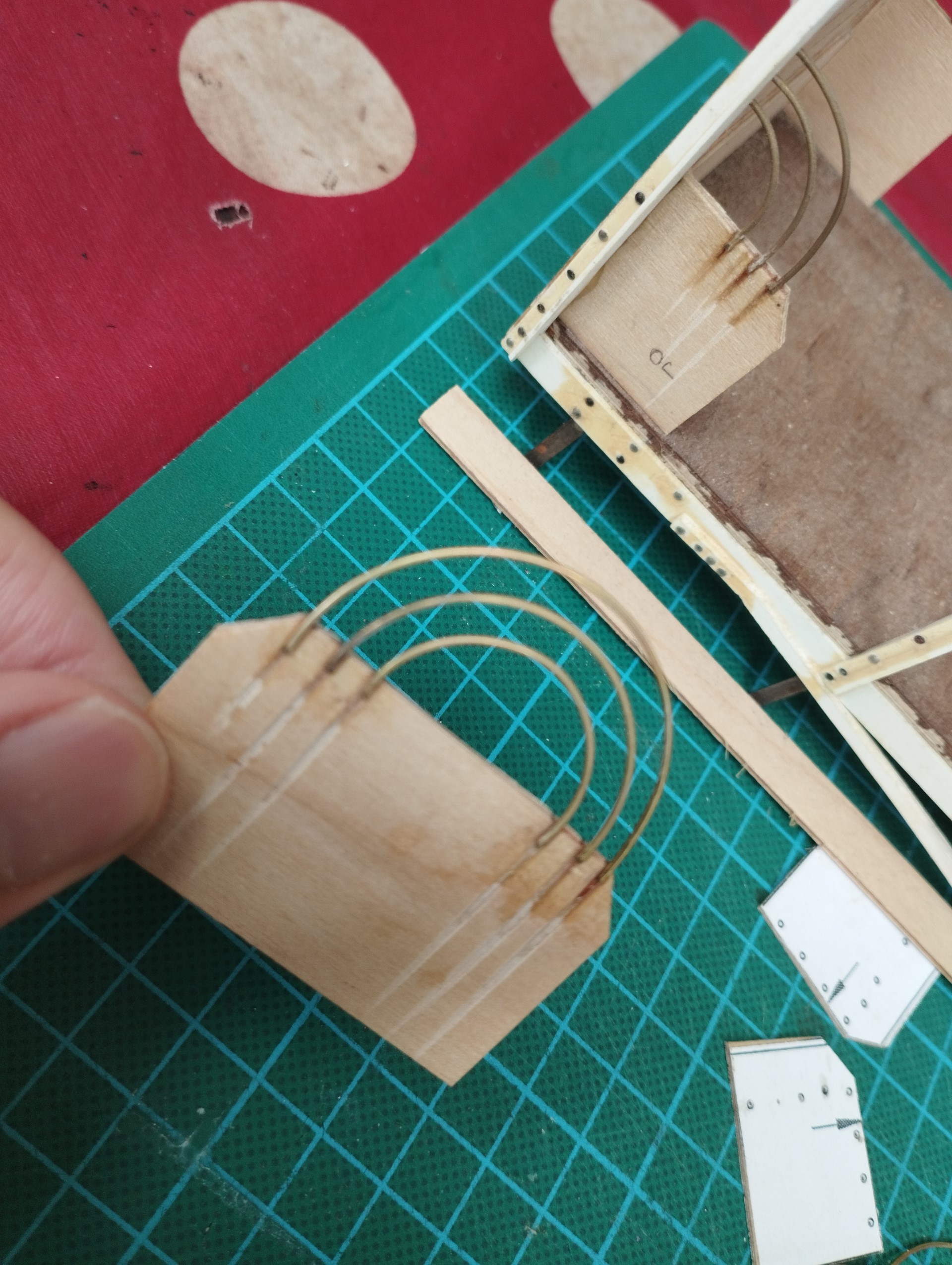

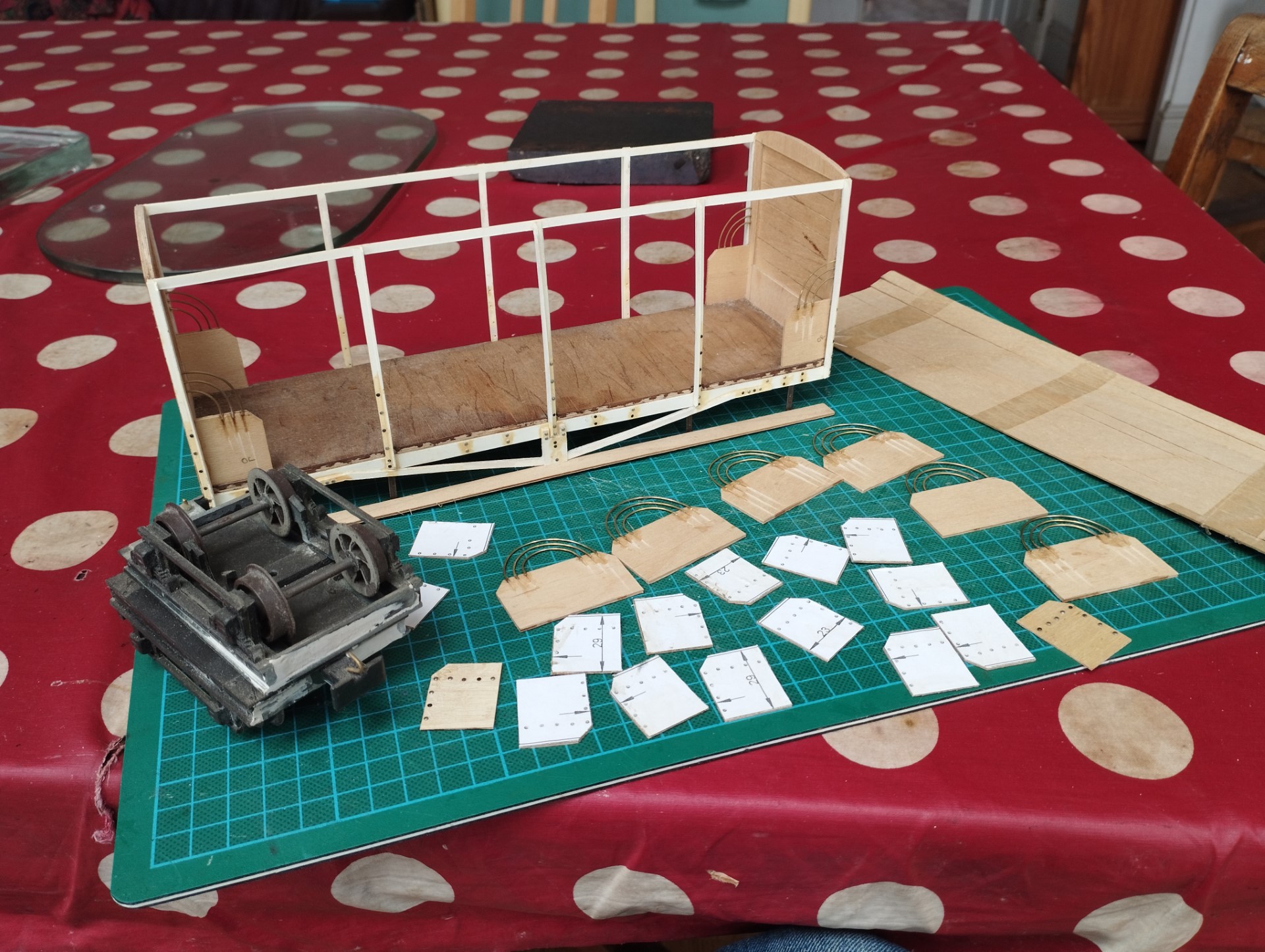

Hi all,
I'm very glad you like the observation car - it was a fun build, even if it was a headache at times.
My next project is the complete opposite, in that it's definitely third class - even if it does afford some pretty good views... I'm restarting a project to build a Hudson toastrack carriage that I started - and put aside - way back in 2010. I'm not sure why I never finished it - I think it was partly because I wanted to prioritise more typical WHR carriages, and partly because I just lost interest. I travelled on two of these carriages (the FR's 39 and WHHR's 42) at the WHR 100 event though, and it's rekindled my interest.
So... Last weekend I crawled into the depths of the under-house storage area to see what I could find, and was pleasantly surprised! I'd got much further with it than I recalled.
Here's where it's at...
Toastrack bits 1.jpg (587.38 KiB) Viewed 39512 times
Toastrack bits 2.jpg (850.68 KiB) Viewed 39512 times
Toastrack bits 3.jpg (442.51 KiB) Viewed 39512 times
That's got to be at least half finished?
There are various bits that don't come up to my current standards, and some bits that have suffered in storage, but I think I should be able to pick it up quite successfully. The first task will be to attach the bogies and give it a test run, then I think I'll work on those side panels.

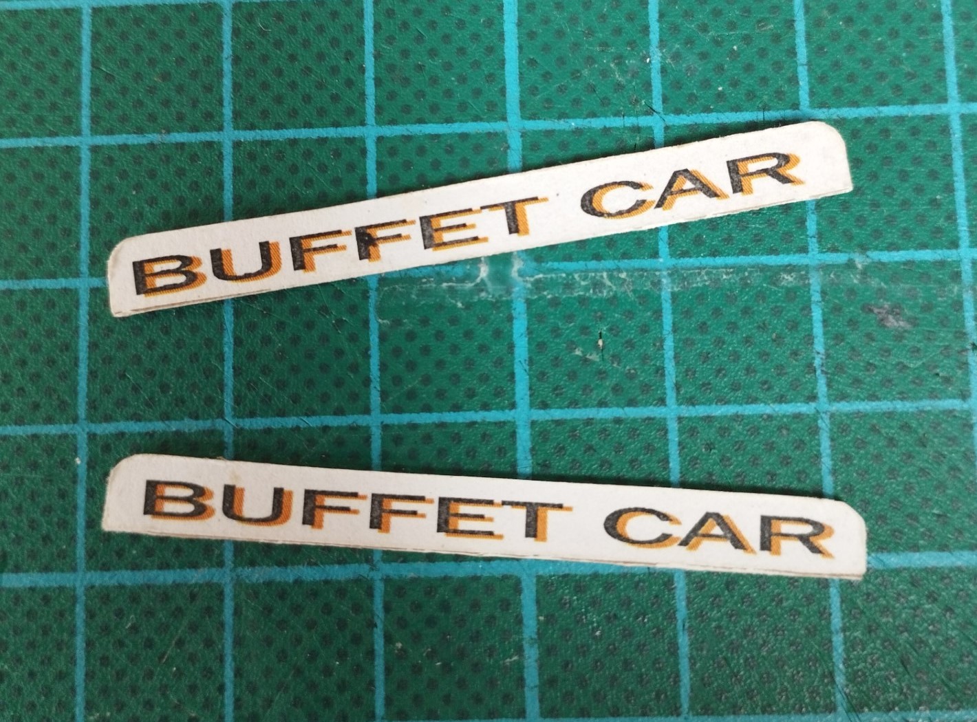

As a bonus, in amongst all the bits of toastrack I found the little Buffet Car signs I made at about that time but never got round to fitting, so finally my model of that carriage can stop being anonymous. You never know, it might attract a few more customers...

Looks pretty good to me, Andrew. I do like those curved handrails, very neat and even.
Re: (WH)WHR Rolling Stock
Posted: Fri Jul 07, 2023 12:13 pm
by Andrew
philipy wrote: Fri Jul 07, 2023 11:25 am Looks pretty good to me, Andrew. I do like those curved handrails, very neat and even.
Thanks!
As I recall, I bent them round various carefully-chosen paint pots etc! The panels you can see with the paper drawings still stuck to them will go on the front, to hide where they're attached.
They'll go behind the uprights, whereas really they're quadrants (rather than semicircles) that should meet in front of them, but I generally think that a neat finish is more realistic than a botched attempt at accuracy. I noticed that one set of handrails (one of the end ones) are distinctly wonky and don't match the others, so I'll need to re-do those - IF I can find the right size pots etc again!
