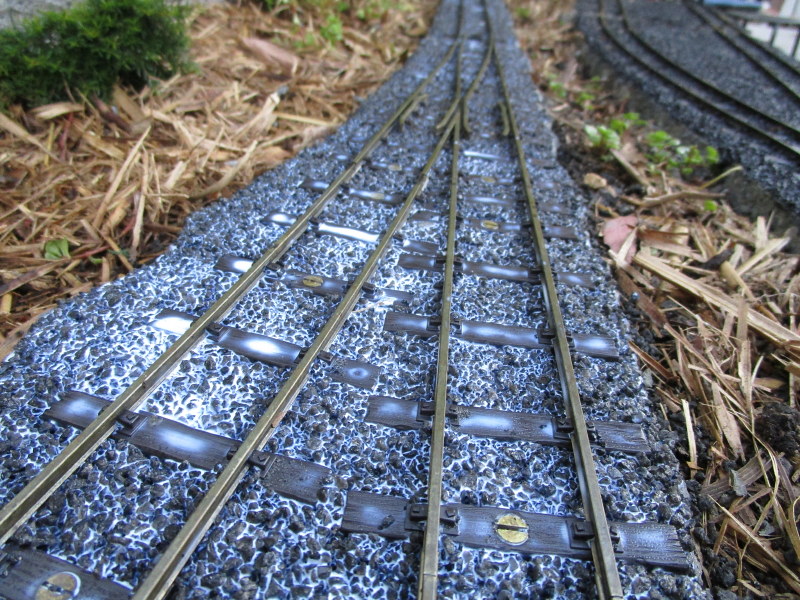

First ballast trials with the down under SBR (Davco Lanko 751)
A mix of 2-3mm granite chips and colours
Sand and black mortar dye into the loco service area to start with because if The Plod makes a proper mess he can tip steam steam oil all over it and make it black and oily :-)
He dribbled it on neat, but it seemed it was not flowing very well through the mix, so he sprayed some water with a few drops of detergent over it and it seemed to flow then. We shall see if it sets well enough to withstand the track cleaning blow off with the garden hose before running sessions.
Crikey, this looks a mess
Plod covered it up last night and this morning had a peep. He felt a bit better about it all and with some summer sun on it today should get the bake off going nicely.
Technique refinements will no doubt occur as Plod moves onto other sections.

Your SBR looks a lot thicker than mine which I generally thin down further to help it flow. Mine starts off with the consistency of single cream, yours looks more like custard.
Posts: 5726
Re: The Potters Orchid Railway
Post by Peter Butler » Mon Dec 05, 2022 10:06 am
In a warm, dry, climate (i.e. anywhere except Wales) I would expect the surface of neat SBR to congeal quite rapidly, as shown in the pictures. Assuming the concrete is already holding heat and the air is warm and dry it is probably to be expected. I never use water on my ballast and try to apply when there is no sign of rain, but conditions are never equal to what Dazza is experiencing. It should dry out well and be permanent. The sleepers will need scraping but dry SBR peels off plastic easily.

Post by Hydrostatic Dazza » Mon Dec 05, 2022 8:22 pm
ge_rik wrote: Mon Dec 05, 2022 8:06 am Your SBR looks a lot thicker than mine which I generally thin down further to help it flow. Mine starts off with the consistency of single cream, yours looks more like custard.
I wet the track bed before I put down the dry ballast.
Then I dribbled neat SBR as per Peter B has written I actually sprayed a mist of water over the top of it all to aid the diffusion of the SBR through the ballast medium.
Cheers from Dazza, The Hydrostatic Lubricator 8)

Post by Hydrostatic Dazza » Mon Dec 05, 2022 8:26 pm
Peter Butler wrote: Mon Dec 05, 2022 10:06 am In a warm, dry, climate (i.e. anywhere except Wales) I would expect the surface of neat SBR to congeal quite rapidly, as shown in the pictures. Assuming the concrete is already holding heat and the air is warm and dry it is probably to be expected. I never use water on my ballast and try to apply when there is no sign of rain, but conditions are never equal to what Dazza is experiencing. It should dry out well and be permanent. The sleepers will need scraping but dry SBR peels off plastic easily.
After 24 hours the first trial was showing nice signs for drying out and holding the ballast firm. That gave me confidence that is will work OK.
I have done a bit more last night and lifted the covers off to expose it to the sun.

Post by Hydrostatic Dazza » Mon Dec 05, 2022 8:37 pm
24 hours after applying it looked like this. A good day of sunshine and the next few days the temp will be mid to high thirties. Out in western Queensland it will get 46 degrees ! Crikey !
The track in the foreground has a different mix with some sand and also some black mortar dye.
It is the loco service area and it should be black, grimy, oily and ash ballast. However this is the chosen test site for technique refinement. I expect I will go over this area again lifting the ballast/dirt level to cover the sleepers.

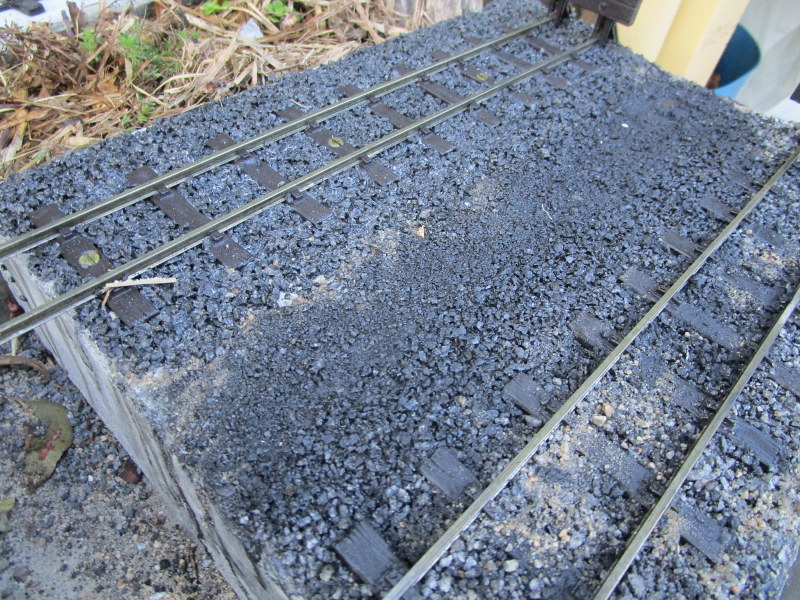

Post by Hydrostatic Dazza » Mon Dec 05, 2022 8:52 pm
6th Dec, MAM returned home with some 1mm washed sand. :)
2-3mm granite chips, black sand added to alter the fill, and some black mortar dye was churned into the mix.
Bare bed and Peco SM32
Plod wets the bed and applied the Mk3 test mix.
Captain Plod applies neat Lanka 571.
Does he know what the heck is going to happen ?
Fark no!
The important thing is that is looks reasonable but most importantly the ballast is secure, able to withstand the garden hose wash offs to remove leaves and snails etc
A mist of water was sprayed over the area
The supports for the coverings.
Plod then covered it all up and went up to shower, a glass of tomato juice (no wine this week ) and make dinner of omelettes with organic mushrooms and steamed vegies
Last edited by Hydrostatic Dazza on Mon Dec 05, 2022 9:05 pm, edited 1 time in total.

Post by Hydrostatic Dazza » Mon Dec 05, 2022 9:02 pm
Plod added some more mix on top of the earlier loco service area, more dye and 1mm black sand.
This morning 12 hours later it looks like this. Plod reckons nothing will beat the real thing so he is going to bring back half a litre of steam oil home and tip it all over this area to get the grime and ash crud grime effect. Plod seems to have developed a strange fascination for loco shed grime.
The new area that had the new mix applied looks like this after 12 hours over night.
It is now exposed to the days good sun.
Note the station yard areas will have similar brew but without the black mortar dye.
The single track will have clean ballast thus no sand added.
Stay tuned for more exciting episodes of the Captain Plod and the POR's great ballast trials

Post by Hydrostatic Dazza » Tue Dec 06, 2022 2:28 am
POR Ballast Report, location new locomotive roads # 1 and # 2 at Cabbage Tree Creek Station. After 6 hours of the Queensland morning sun the bake off is going well. Very firm already.

Post by Hydrostatic Dazza » Tue Dec 06, 2022 8:58 pm
Captain Plod's winter time sport is digging holes, mixing concrete and shoveling dirt here and there and heaving stuff to there and back to here, but this year he has a new summer time sport. It is nudging little granite chips around Peco SM32 track.
Plod explains in a recent interview "It is quite therapeutic and my dim mind enjoys this, especially when listening to some test cricket"
There was no black mortar dye added to the new section. Plod also got a bashometer and chisel and chipped off the track bed edges to break the straight even edge of the track bed. When the ground covers nestle up to it he thinks it will look OK. One day or rather one year, perhaps in the next decade the area will be full of buildings and details but till then.
So far the loco roads look OK and Plod is thinking of how to simulate ash.
So far all has set quite firm after a day exposed to the increasing ferocity of the Qld summer sun .

That is drying out incredibly fast.... I've never seen it do that in our climate. The result looks perfect, at least here on the screen... I hope you are satisfied with it on-site. You would find it difficult to remove now I bet!
